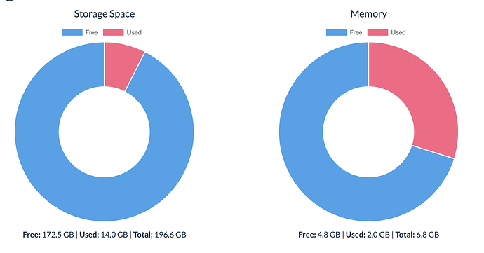

Recently I happily found this amazing tool and forum to share and unfortunately I’m having some troubles processing the images. Looked for the topic and found some info but nothing very clear to me. So I’m having the “Not enough memory” warning and can’t do much. I only have 8GB RAM.
Here’s my diagnostics:
And my hardware is an 27" iMac from 2020:
3,8 GHz 8-Core Intel Core i7
8 GB 2667 MHz DDR4
and if it’s important: AMD Radeon Pro 5500 XT 8 GB
So reading the forum I saw that I need at least 16GB RAM. I’m doing some mapping for agriculture purposes. For now I’m trying to process 1000/1500 images done with a Phantom 4 pro v2. If I upgrade my memory to 32GB will be enough? Or should I upgrade directly to 64GB?

Hi @hugof,
I did some testing with different amounts of RAM. I hope to find soon some time to publish them here.
But with 16-32Gbyte of RAM and a big enough pagefile and not locating the pagefile on a HDD but at least SSD or even NVMe SSD you should not have problems.
For processing 1000-1500 pictures 32Gb of RAM should be minimum, more is always better.
In one of my last processes I computed 1413 images with feature- and pc-quality high in around 9 hours and memory usage peaked at ~80Gbyte. Roughly 20Gbyte of that were swapfile.
So even 32Gbyte of RAM should do, just make sure to make 2x or 3x RAM size as pagefile available.

Thank you, great info! I will try to go to 64Gb RAM. I have a 500Gb SSD with more less 300Gb free so don’t think that would be a problem. I will try with this configuration and see how it goes. For what you say I guess that the ultra option is something like high resolution.
Yes, 300Gbyte of SSD is good to have. Though during processing things can really swell up.

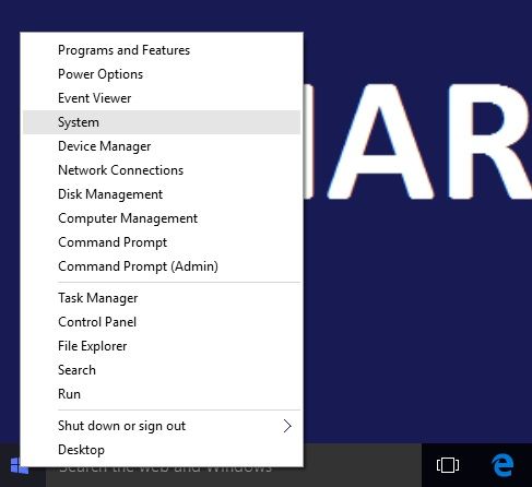

In case you run WebODM under Windows, enlarge the pagefile. If you have the space on your disk, give it 64-128Gb. That plus your physical RAM should be good for small-medium datasets.

But you still need to change the actual size of your page file or virtual memory as Microsoft may call it, you can follow the instructions here:
