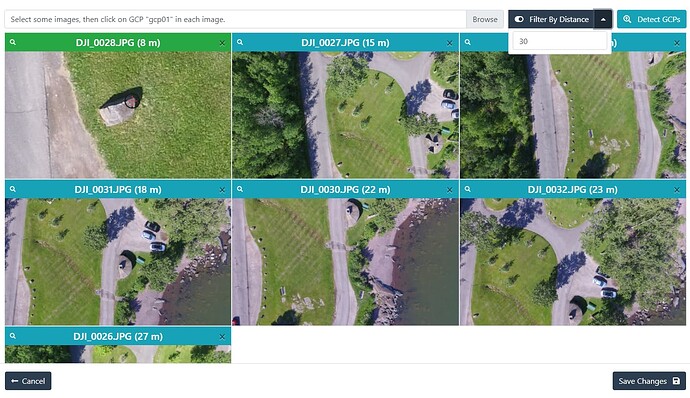

We now have support for filtering by distance, faster image loading (via pagination), and experimental auto-detection of GCPs via computer vision algorithms!

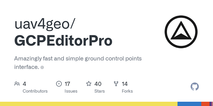

You can download the newest version (1.2.0) from GitHub - uav4geo/GCPEditorPro: Amazingly fast and simple ground control points interface. ◎

  • filter by distance is nice, working!
  • still need to click and zoom in with my mouse scroll wheel : can we have all the pictures zoomed in and automatically centered at the GCP at once ? If I have 300 images with 5 GCP’s , I still have to zoom in and click a thousand times :slight_smile:

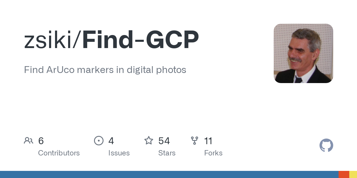

Check here! They recommend not using a white mat since the contrast is too high, but instead a partially gray mat with black ArucoMarker print.
We are using the Find-GCP principle here for almost a year with astonishing results even if we made the GCP with White and not Gray base.
