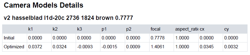

As a matter of fact, I do see 2 different camera model details. I had not even noticed that until you asked.
Hasselblad for the M2Pro and DJI for the Zoom.
If it would be of any use, I can provide screen shots of them
Here are the details of the 2 drone model cameras:
Mavic 2 Pro:
and Mavic 2 Zoom:
I’m curious what the various columns indicate and if the differences cause any issues during reconstruction.
