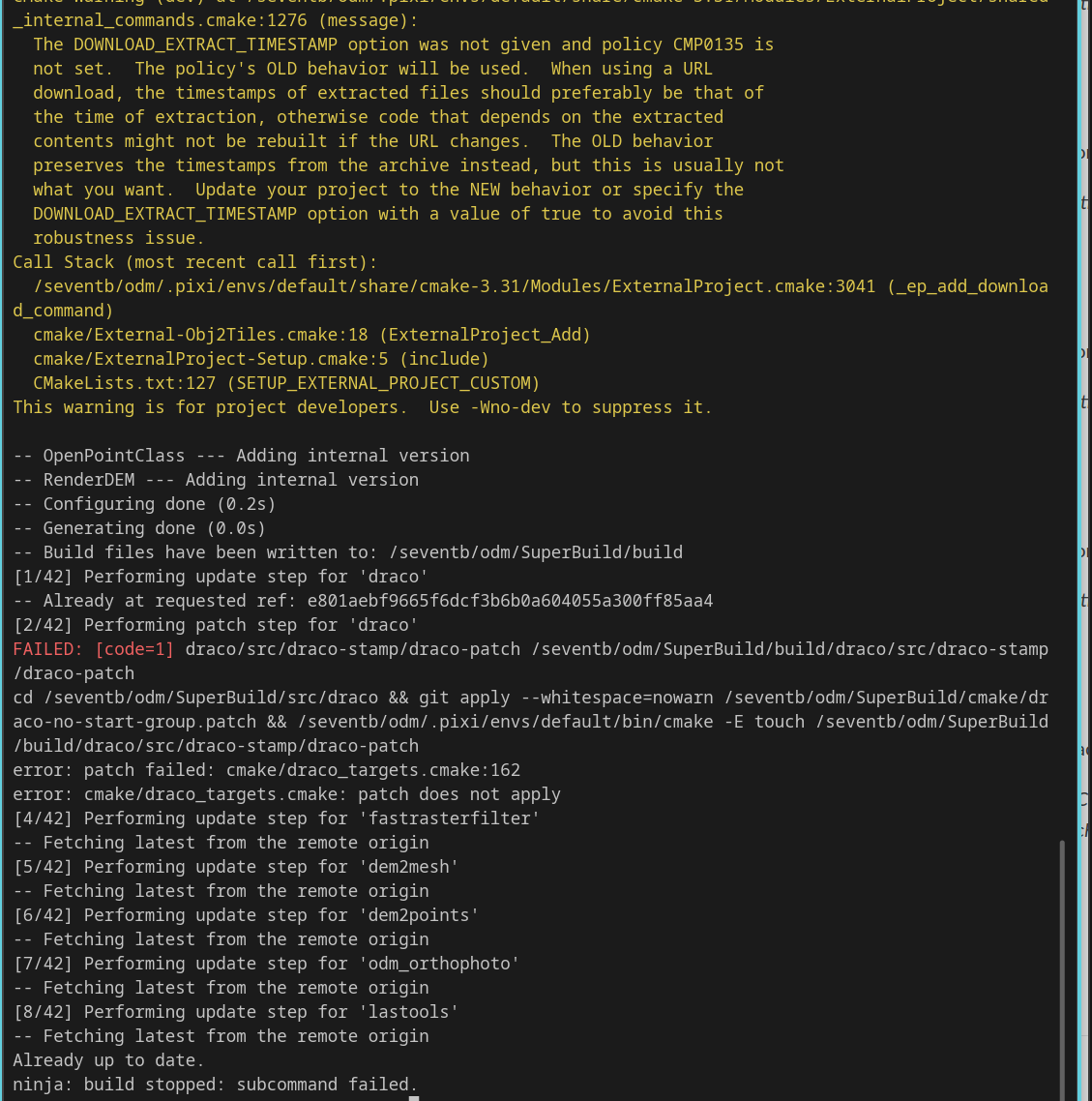

Ignorant question on pixi – once the build is complete, is there an update process? Made changes and thought I could just build again, but running into problems with redoing patches. Ideally I wouldn’t have to clean it every time, but this is a new world to me (and apologies is this is an easy find in the docs – it’s late on a Friday :D).

Oh, I haven’t seen that in my testing. If you make an edit it should automatically pick that up and the next build should be incremental. I’m not sure why this is failing. Can I ask what commands you were running and what you edited to see if I can reproduce it?
The error “patch does not apply” implies that either its trying to re-apply an already applied patch, or the underlying code changed enough that the patch is invalid. If it works after a clean, it hints at the former. Cmake should only apply the patch once though so I can look into that.
Actually I can reproduce it trivially. I must have broken it when I got the windows build working. I’ll check why cmake is trying to re-apply it.
