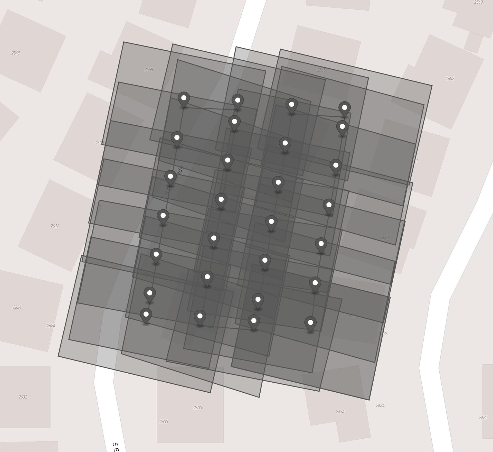

You cannot map over water with OpenDroneMap software, unless you can also capture some of the land in each image (but sounds like this is not the case here).
Maybe “plotting” the footprint of the individual images is more helpful than trying to make an (impossible) map
