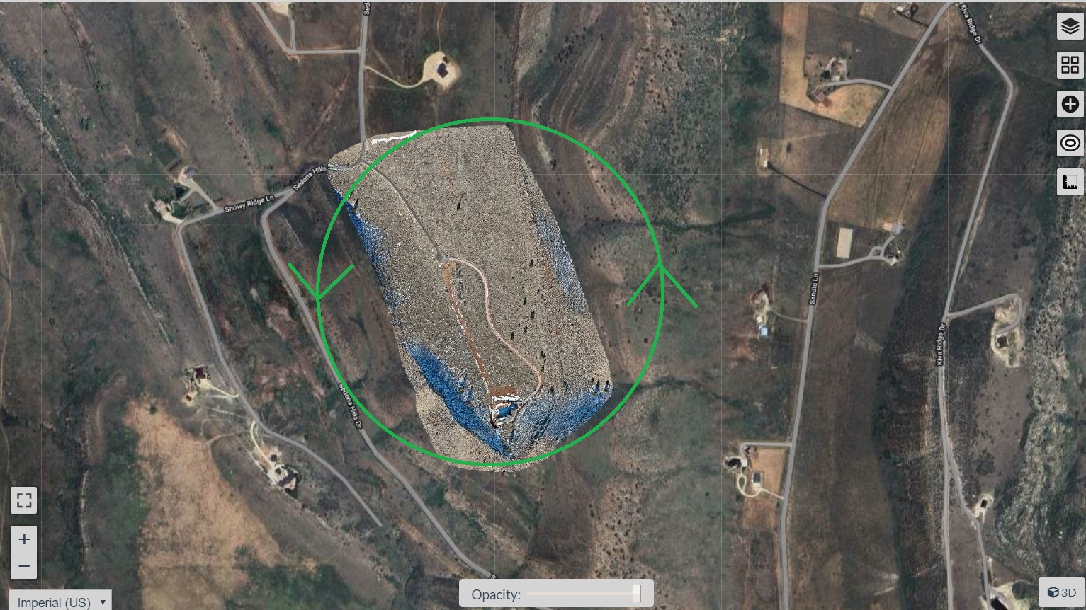

In QGiS I believe you can set the viewing (rotation) angle for a Map canvas. Others may tell if it’s possible in WebODM.
From QGiS:
QGIS would be my go to workflow as well. Although it might be a bit overwhelming for users without (QGIS) experience.

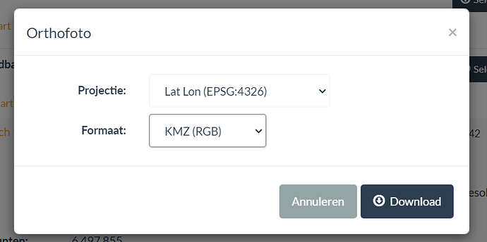

  1. Export your orthophoto as KMZ (RGB) in EPSG:4326 projection

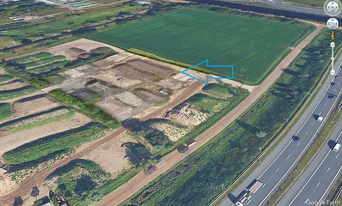

  1. Drag/Open the KMZ in Google Earth. You can use the pan tilt zoom rotate buttons :wink:
    The blue arrow shows the imported KMZ
