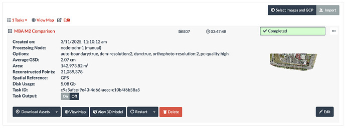

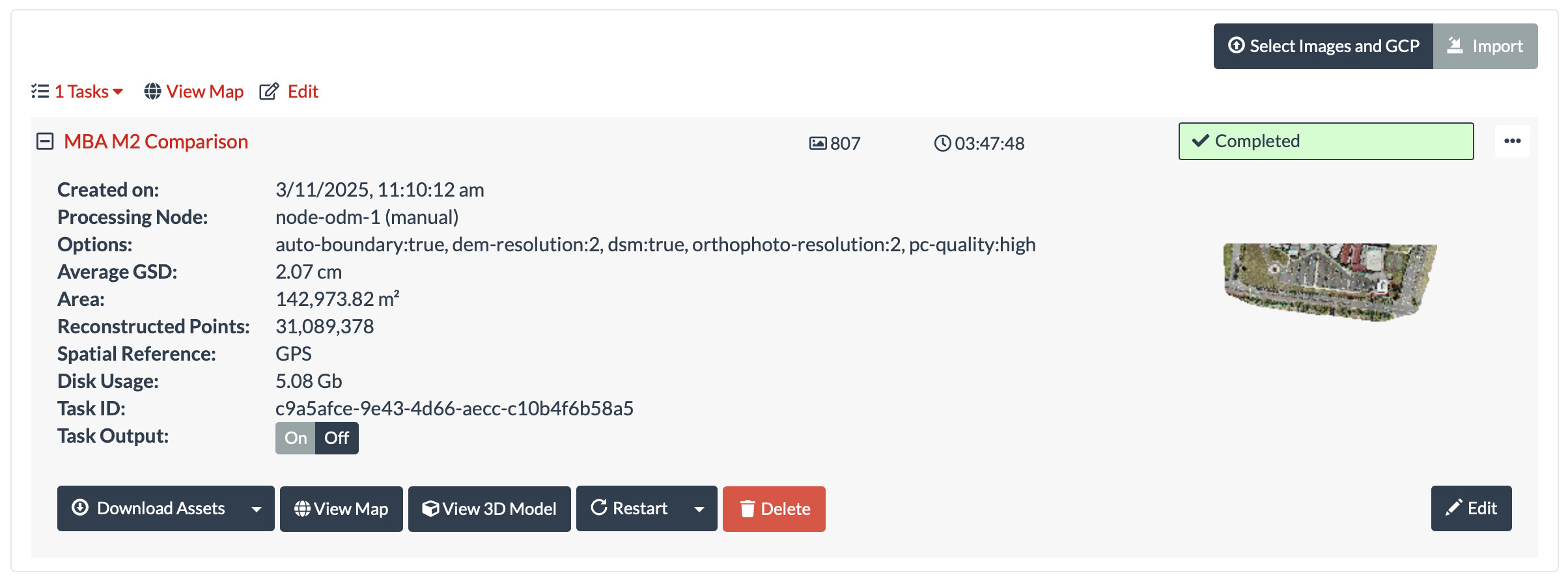

So I ran my 807 image dataset on an M2 MBA with the following options adjusted from defaults:
auto-boundary:true, dem-resolution:2, dsm:true, orthophoto-resolution:2, pc-quality:high
Originally my Docker Desktop settings only had 7.8GB RAM allocated (this MBA has 16GB RAM) and the job failed after a while due to insufficient RAM. I then increased the allocation in Docker Desktop to 15GB and re-ran the job (it already had all 8 CPUs allocated). It then ran successfully* in 03:47:48

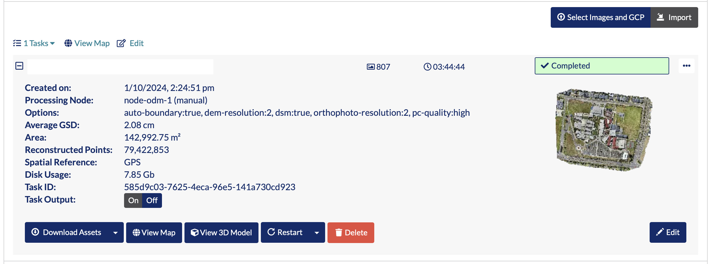

On my production server which has 64GB RAM, the same task with the same settings took 03:44:44 (so basically the same - not what I expected). The server has 2 vCPUs (Intel Xeon Gold 6426Y; 8 cores per vCPU) on Nutanix AHV virtual server.
*When I say “successfully” - it ran and completed. For some weird reason though it has cut the resulting orthophoto cleanly in half (I have no idea why - it has reconstructed less than half the points):
