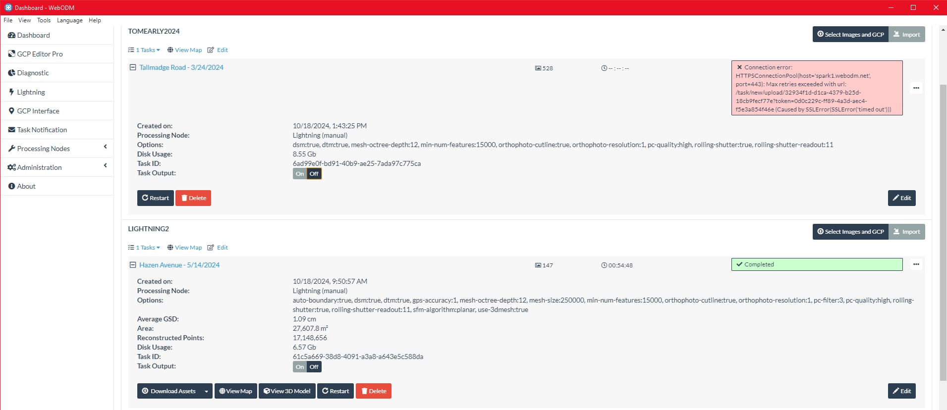

Does Lightning require a “Continuous”, Internet Connection from start to finish?
SURV,
No continuous internet connection needed, unless you want to monitor the job output. Using Lightning thru WebODM. I upload my photos etc, once they are uploaded, I shut down WebODM and wait for the email from Lightning. Simply start WebODM and the finished project will tranfer to your machine. Be patient it can take time for the transfer.
So, if I turn the Task Output on, that could cause an error?
No. Lightning runs independently. You upload your photos and GCP’s and Lightning processes the job on their server. The results are either download by you or transferred to WebODM. If the job was directed to Lightning from WebODM, as long as you have an internet connection(continuous as you asked), you can monitor the Lightning task output in realtime. If you are not using WebODM you can view the task output from the downloaded files once Lightning is done processing.
What I was asking, is, if I start Lightning, and toggled on the task reporting(which is being populated online), and THEN lose connection, it would likely stop the task reporting … ie, a break of the Internet reporting … Could a break in communications cause an issue, of my own making?
In other words … “John, do not ask for the task reporting … You might be courting problems …”.
If you get disconnected, it’s not going to harm the processing.
Is there any way to decipher what might have happened?
I could be wrong, but it looks like you had a significant network outage while uploading the data. I would hit that restart button. You should be able to log into the web interface at lightning and check it too.

I restarted my Lightning session, again, and it “RELOADS”, again, all the images … each and every time, There is no indication about signing into my account …
BTW, Restart results in a “new”, error message, similar to the first, with different Hexadecimal data.

Forgot to mention … twice my upload appears successful to 525 of 527 loaded. At 525, the upload just stops … I still have a connection, but the upload stops.
BTW: a new error …“Error:Could not load task list:error Try again” …
