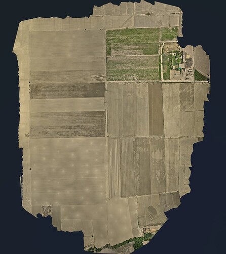

Here are the screenshots of the results obtained when stitching together different subsets of images from my dataset:
The subset of 3000 images:
I have considered the possibility that the observed issue in the orthophotos could be attributed to sun reflection in water or other shadow-related factors. Could this be the reason?

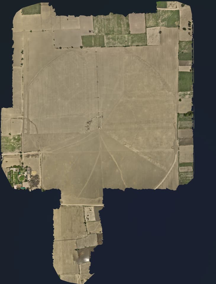

The subset of 2000 images:

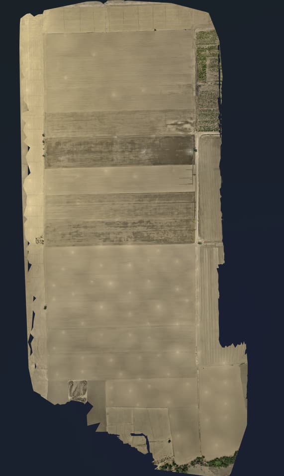

The subset of 2500 images:

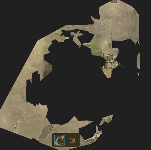

This image is the result of dataset images number 2501-3000.
Can there be any problem in the raw images of this stitched which cause issue when the ODM ran on complete 3000 images?
Try processing all of your images at Default before you go tuning settings.
For instance, do not ever use --ignore-gsd.
