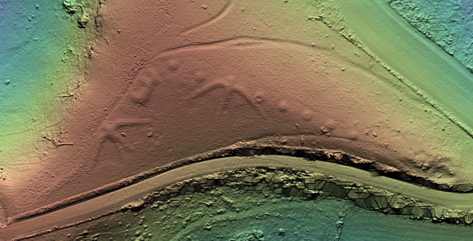

It's not LiDAR - but it's a very respectable result!
Pre-historic hut circles and cultivation remains in the Scottish Highlands. It’s not LiDAR, but an excellent result from 80m AGL.
Absolutely stunning!
What was your setup and processing parameters?

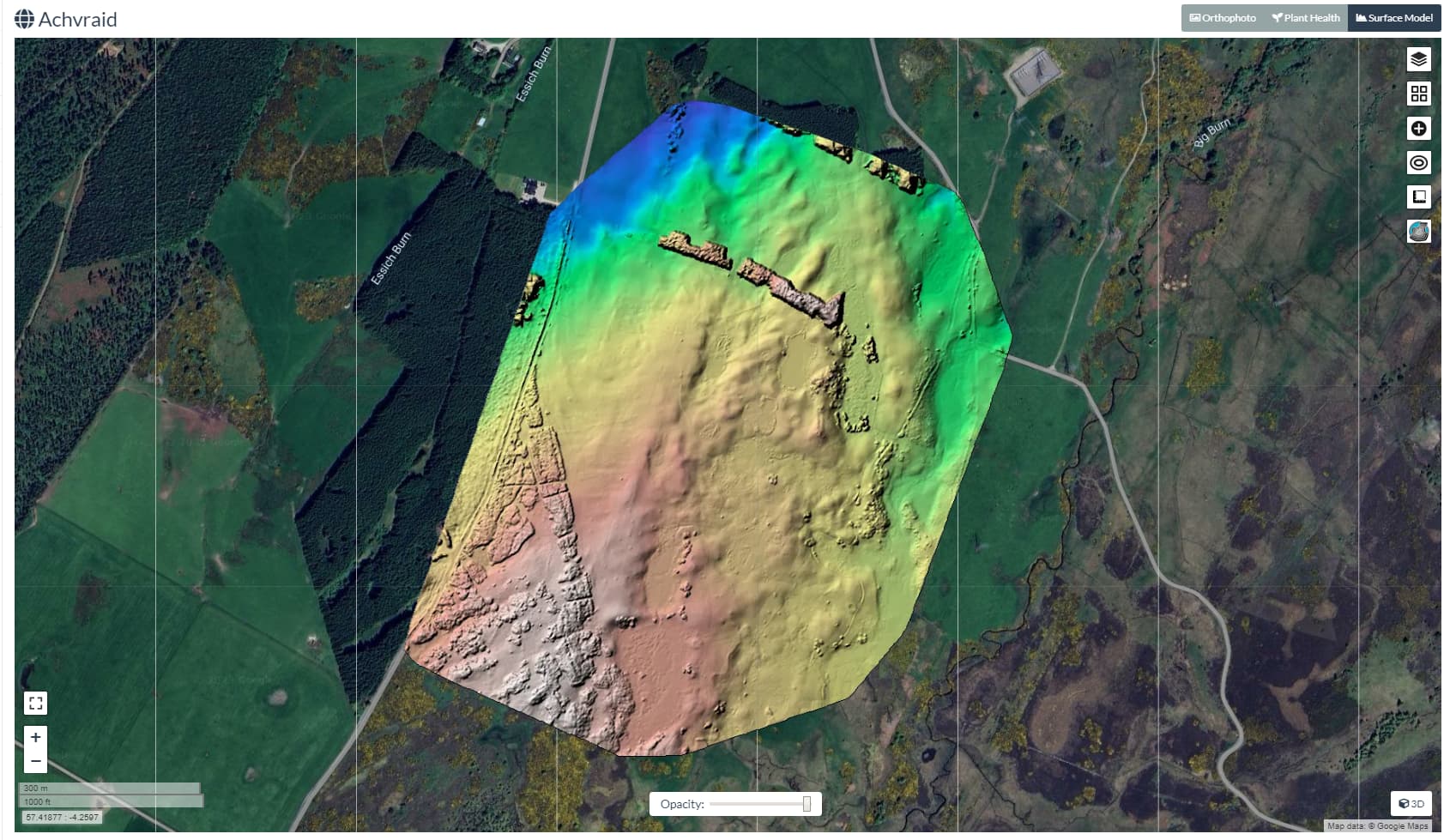

Mavic 3M, 80m AGL. 1154 images (nadir), processed in WebODM. Default settings applied, adjusted to PC quality high (IIRC). This is a zoomed in shot, not the entire dsm.

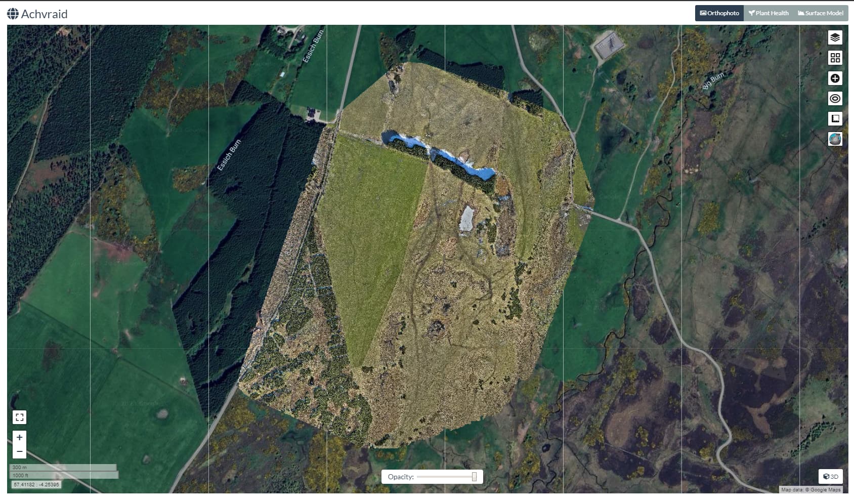

This was the entire area mapped - lots of prehistoric archaeology - hut circles, boundaries, cairns and cultivation remains.
