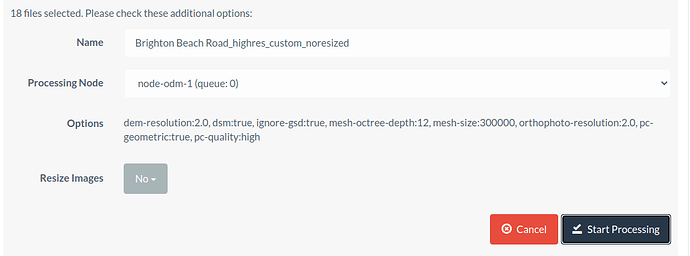

Sure.
--ignore-gsd
You will never need this. Don’t use it. It will break things in unexpected and hard to figure out ways. It isn’t a problem that we have this blocked on Lightning, but I was including it for the sake of completeness.

Hi Saijin, ok thanks for sharing all the info. I think I get the picture; for the sake of not extending to much processing times, the setting “high” for --pc-quality and --feature-quality does the job in a satisfactory manner in most cases. Is that assumption correct? I also would like to confirm with you the --ignore-gsd option; this option would be used, if you don’t want to get the “native” GSD from the survey. Deactivating this feature ignores automatically --orthophoto-resolution as you already defined the output GSD, correct?
Best,
Gabor
Pretty much!
--ignore-gsd also disables a number of other optimizations that will almost always cause memory consumption to spiral out of control. It has its purpose, but OpenDroneMap has a very robust estimation of GSD and I’ve yet to see it be wrong. In other words, forget it exists.
--orthophoto-resolution and --dem-resolution are still taken into account. However, they can not go finer than the calculated GSD (plus a bit of a safety margin).
So for instance, if your survey was 12MP at 400ft AGL / 120m AGL with an effective GSD of 4.33cm/px and you set it to 1cm/px without --ignore-gsd, --orthophoto-resolution and --dem-resolution can not go finer than 4.33cm/px. However, in that same situation, if you set them to 10cm/px, they will go coarser.
If you set them finer with --ignore-gsd, you can go finer, but you’re just interpolating and making up fake data. It has no value in such cases, I don’t think.
