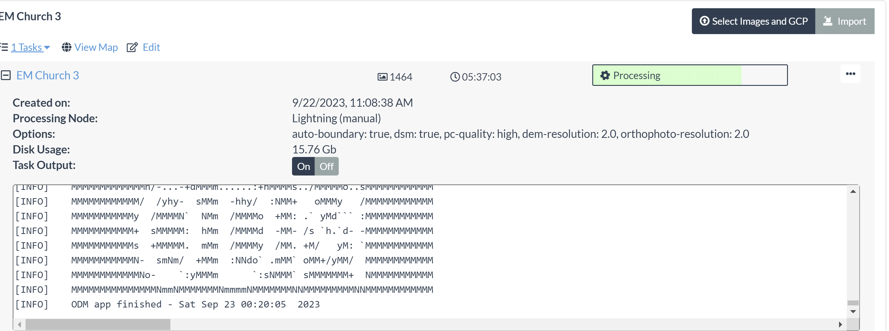

Indication processing is completed - but process bar is only 75% completed
I am trying to process this project with 1465 images and this is my 3rd attempt. It keeps hanging and I have the current updated version.
The TaskOn indicates it’s completed processing, but the progress bar shows only 75% (aprox) completed.
Thank you, I used the installer.
Windows PC
11th Gen Intel(R) Core™ i9-11980HK @ 2.60GHz 3.30 GHz
32Ram
NVidia GEForce RTX3080
I found a work around. Went the web version and donloaded the file and then imported. But not sure why the desktop version is doing this.
Better way I should be optimizing this?

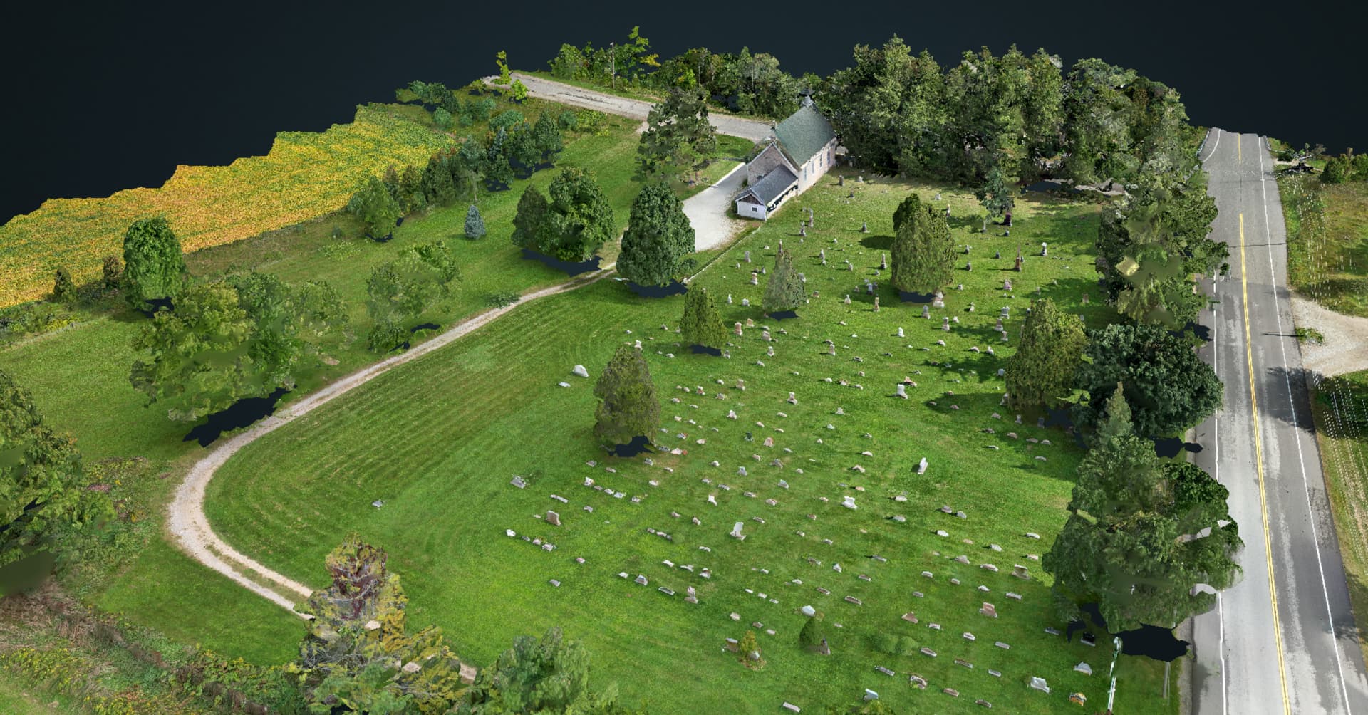

It’s a bit of a complicated model - old church and cemetery.
Please try updating your copy. Piero released a fix that should resolve this behavior.
Thank you, I had just done the update in the morning.
I’m not sure of your timezone, but the fix was made about 6 hours ago and the CI/CD and build can take about 45min, so if you’ve not checked in the past few hours, I’d recommend doing so again.
Thank you - will check it and re-try.
