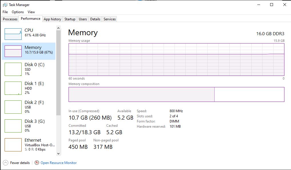

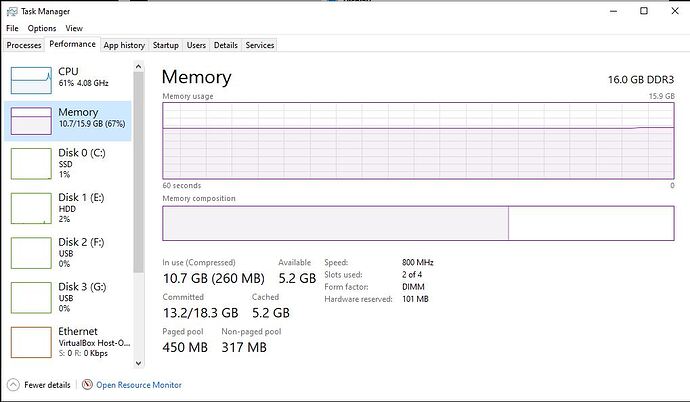

I tried some experiments running just a single Docker instance with the images on a different drive after updating the VM to include the additional path and that single instance failed.
I then cleaned out the results from the directory path that originally passed and ran the process again. The first time the process was run, passed but subsequent runs fail with the same error. I then tried deleting the old default VM and running the Docker Quickstart again to recreate the VM.

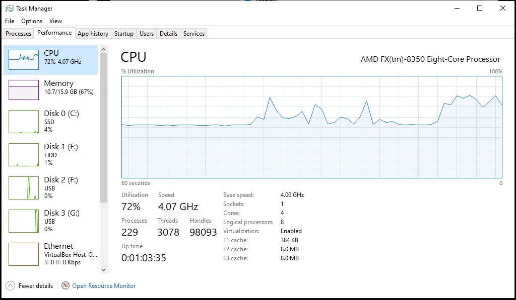

My PC’s memory utilization looked stable while running the process.
CPU Graph
