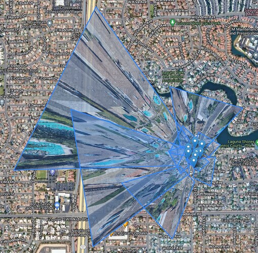

The application DOES process oblique images… to a certain point. The problem is the greater the obliquity, the greater the distortion. At a certain point, it loses all accuracy.
Here’s an acceptable example:
Here’s a very poor example:

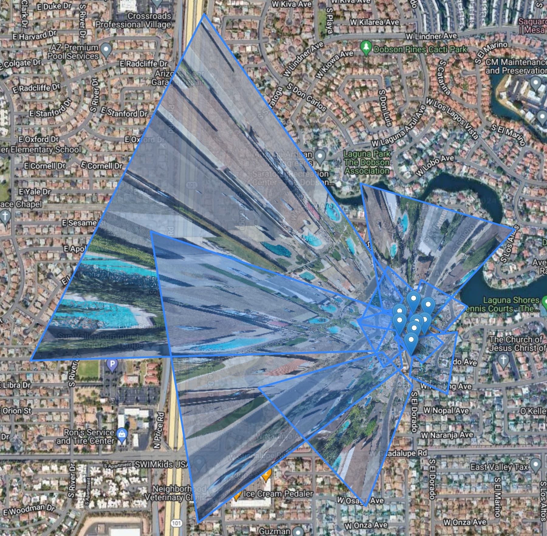

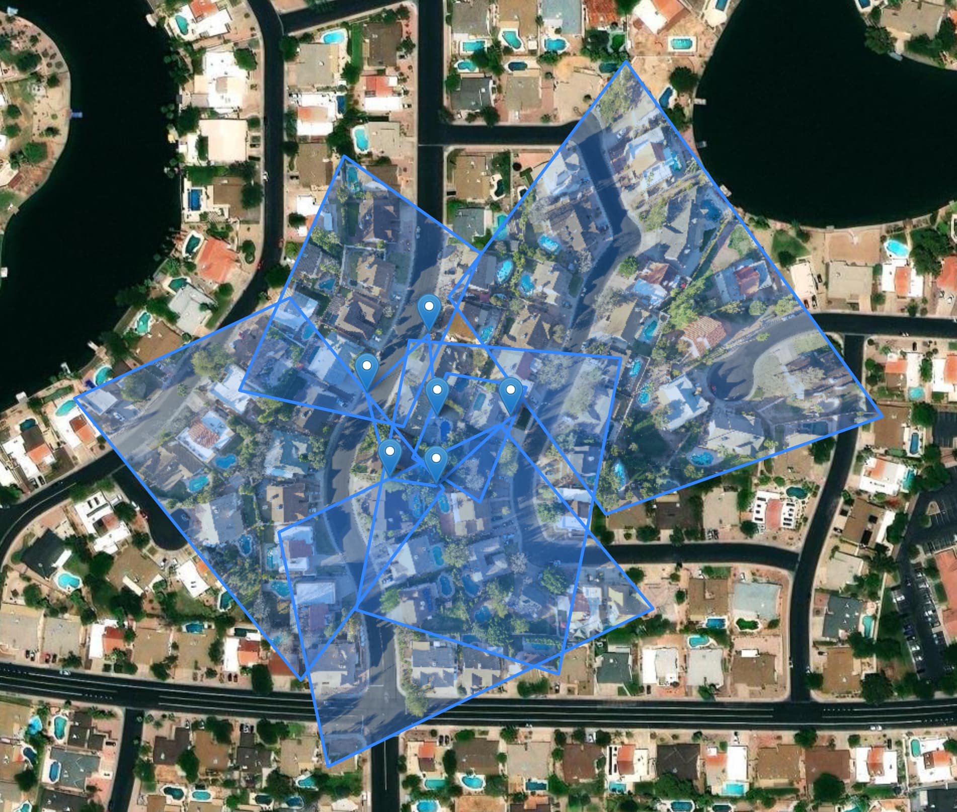

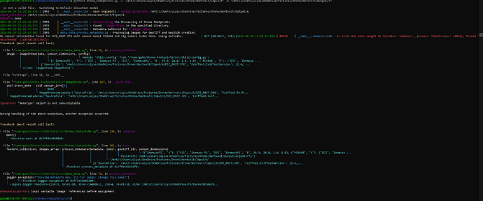

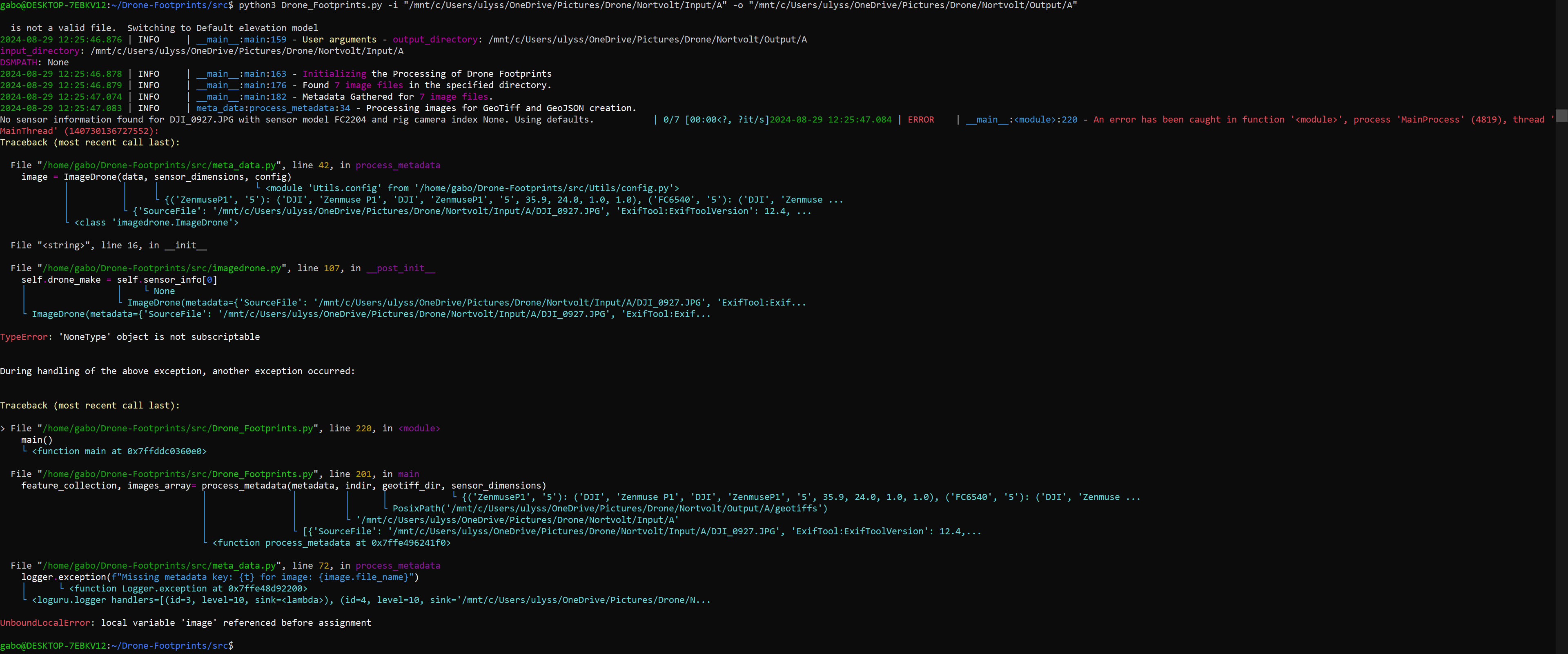

So i’ve spent all morning trying to run drone-footprints.py, first on a cmd line terminal on my windows machine, then in a conda env where i was able to succesfully instal gdal libs and finally on a linux terminal where it brought me the further i was capable of going so far but it seems the program couldn’t go further without my drone camera specs…
Here is an image of my linux terminal :
Here is a sample of the images i was trying to pass through drone-footprints.py : A – Google Drive
im all out of ideas to try and make this work, if you find the time to help it would be greatly appreciated!

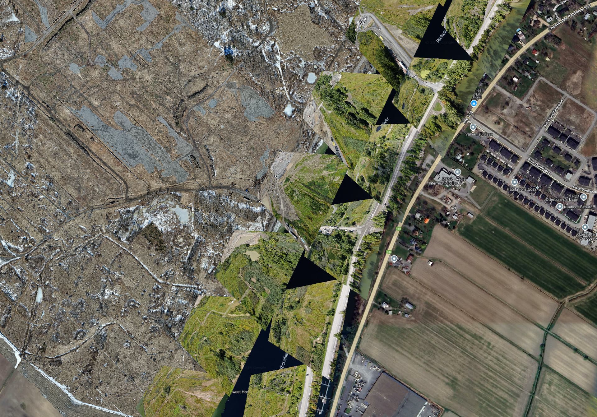

I’ve updated the csv file containing the specs for my drone (Mavic 2 zoom) and it worked! Although the images seem to be georeferenced according to the position of the drone and not where it should be on the map, also the polygon looks inverted? like to bottom is larger than the top of the image. in all the examples i’ve seen in this thread it was the opposite…
Hi. Thanks for the kudos. Your test dataset of images is at a steep oblique angle. I’ve added a cut off to the code (not published as yet) that sets it at -60° and 7 of those images you provided are beyond that. I set the cut off there because the at and beyond that angle, the images become too warped and will not match up correctly. The new code to be published SHOULD also fix the inversion issue.
Oh yeah these photos were taken at -35 deg. Thanks for the update!
