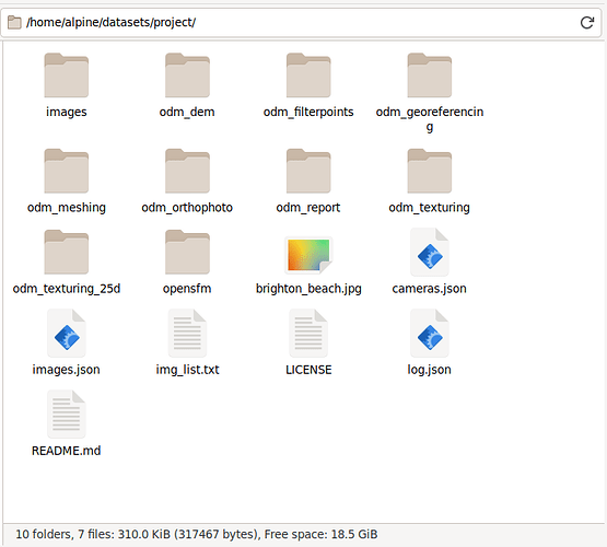

If you followed the guide, the data you want should be found in the directory where you loaded the images:
For me, that looks like this:
docker run -itv --rm /home/alpine/datasets/:/datasets opendronemap/odm --project-path /datasets project
If you’re asking about how to view the products, I recommend QGIS for viewing the DEM products and Orthophoto products. It can also load the Point Clouds and some distributions of it have limited support for loading the model, but something like MeshLab, Blender, or CloudCompare will be better suited for viewing these 3D products for the time being.
