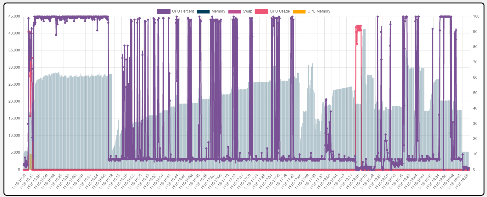

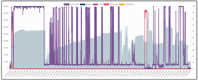

Here a graph of the hardware usage during a process:
The purple line is CPU usage, the red line GPU usage and the light blue bars in the back is the memory usage.
Depending on the size of your project some parts can be much, much longer or shorter. Also depending on your settings.
In the center third you can see the many spikes in CPU usage. If you were to watch that on the windows task manager, you would probably have to stare for minutes to catch one of the spikes.
In between the spikes only 1 or 2 cores are used.
Also see the red line only spikes twice during the whole project run. Those are the only parts that the GPU can contribute.

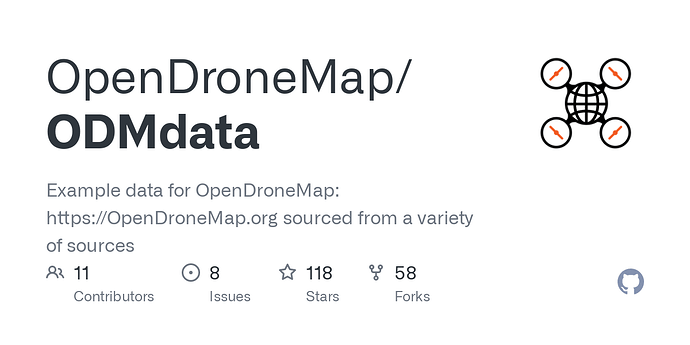

If you have doubts about your settings, first make sure that your setup works at all. Under
you can find test datasets that are known to work. Run a small one <100 images and you know your setup works.
