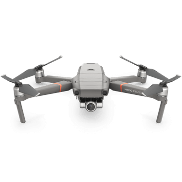

Oh, I’ve read further, so you need an UAV with a thermal camera for “Rehkitzrettung”. You don’t need it for mapping purposes, only to find the deer babies. You would be better off buying something like a
or an
so what you need is a thermal imaging device therefore you will blow your budget big time.
Plus all the necessary insurance (Haftpflichtversicherung) and registration according to your country.
