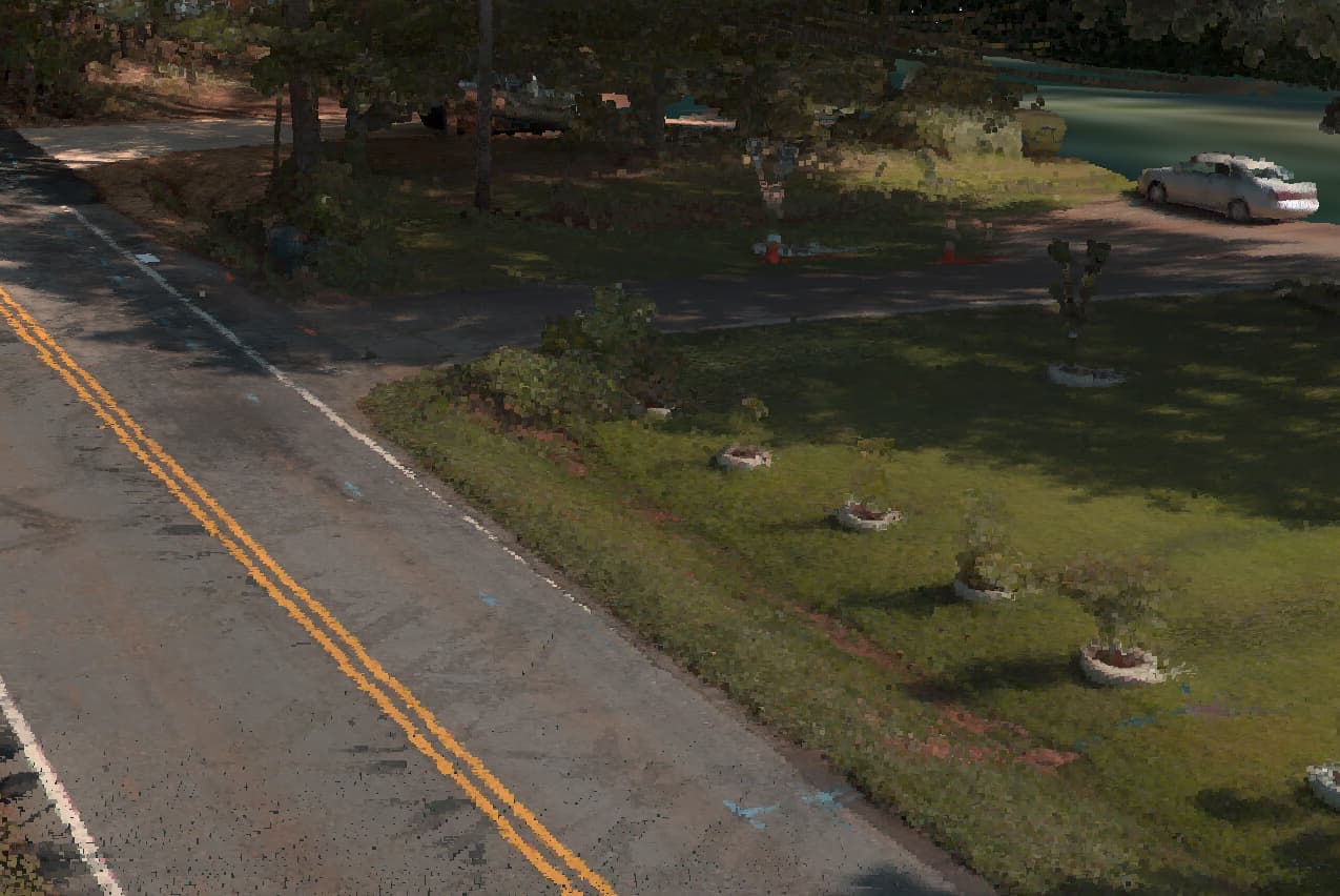

Both produced beautiful output. Next thing to noodle on is how to get auto-scaling using the GPU-enabled machines. As it stands now, auto-scaling launches the standard nodes I believe. The other thing of interest is to get a “use captured LIDAR for PC” switch.
Here’s a little of the Lidar PC for that same shot. Demonstrates why we’d like to combine the photogrammetry and Lidar capture to save a lot of time on trees, etc. during reality capture work.
Your model looks good, what were the options you used?

Started with the High Res template, then set the following options - auto-boundary: true, camera-lens: brown, dem-resolution: 2.0, dsm: true, dtm: true, orthophoto-compression: JPEG, orthophoto-resolution: 2.0, pc-classify: true, pc-filter: 0, pc-quality: ultra, pc-rectify: true, use-3dmesh: true
