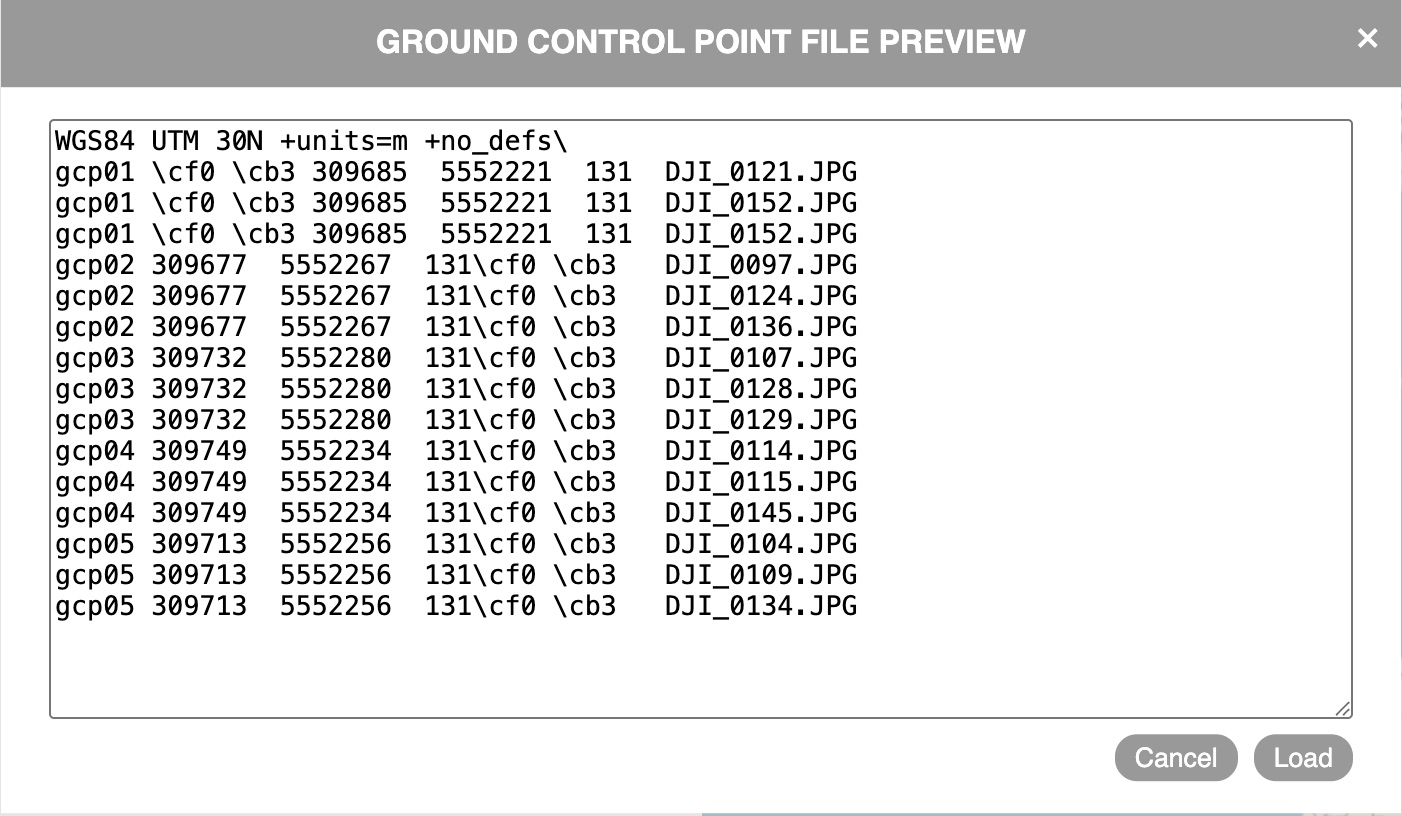

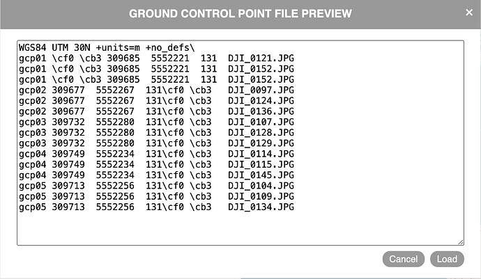

I followed the format shown in the guidance but it did not like something. So I changed it to the following and that did not give any errors, except that there are now additional characters in each line in the file. I guess something is not as it should be.
Having done all that, I am having trouble starting the process going since if I load all the survey images in the main dashboard as normal, then before pressing Review, I go the GCP interface to load the txt file and the marker specific photos (15 of them), then I’m not clear what to do next. There are instructions that suggest I do something on the big map to the side but all the information is already in the txt file and the linked photos. If I return to the main dashboard, all the uploaded photos have gone. There is clearly a correct sequence for doing these two parts.

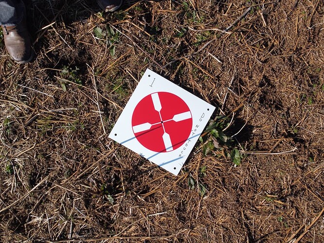

NICE marker … I wonder if I might find a way to make something similar, with environmentally friendly dissolvable 12" material?
My old bones barely get me to where I can place these random reference points in brushy areas … returning to pick them up is about out of the question … until I get my hip replaced … maybe.
These were about $60 for a set of 10 and are waterproof and about 2mm thick, red on one side and black on the other. I wrote on them with a marker pen since there is a survey coming up where somebody may be inclined to treat them as a removable find when I am too far away to say otherwise. As you say setting them out and retrieving them is the hardest part!

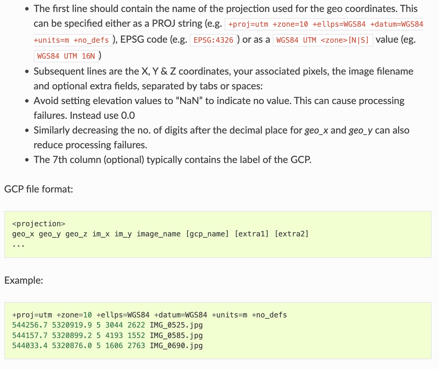

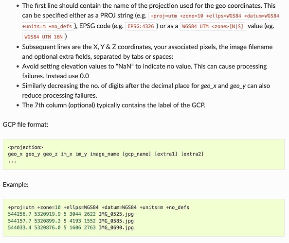

Looking at another part of the guidance notes it mentions including ‘associated pixels’ in the txt file (see grab below). What are those? The height and width of each of the marker image files? Perhaps I need to use a higher resolution value for the X and Y with more decimal places, although it does say that reducing the number of digits after the point will reduce the number of processing failures?
There is no specific guidance on the image loading sequence and only reference is made to the upload of the marker images. Reading other posts it seems that all the survey images are loaded via the GCP interface and then those that are relevant to the GCP txt file are marked and show on the map to the right. For me this is a big duplication since I have already found the photos with the markers in them by a different route and included those file names in the GCP file. Is there a way around this duplication?
I think that it is refering to the x,y count of the pixel nearest to the center of the target of the jpg photo. You should find the same target in several different photos. In each row of the gcp.txt file, the gcp coodinate values will be repeated while the pixel x,y will vary with the jpg.
