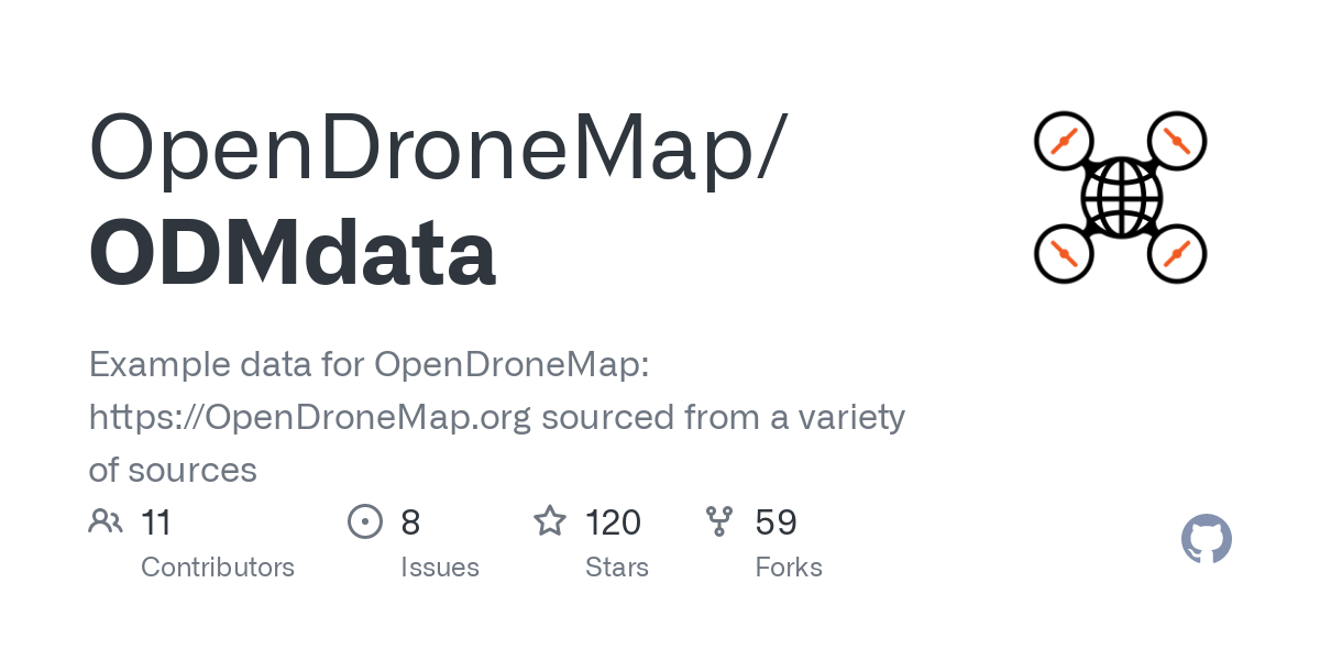

PS: would you guys be interested in a sample dataset of an Autel Evo II Pro RTK with Rinex and GCP’s?
Probably!
Would you want to add it to our ODMData list?

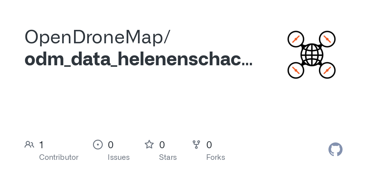

yes I would gladly contribute.
Trying to upload the files 2 days in a row to GitHub but it always fails. Either too many files at once (yes, tried 100 at once) or when I zip them, the file is too big.
I’d really appreciate someone else uploading them from my OneDrive , password is “enjoy”
*edit: files are still syncing, it might take 1 hour
Thanks so much for your contribution!
