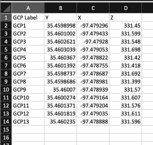

I’ve watched numerous videos and read several posts but obviously I’m failing to grasp something. I have created a .csv file with what I presume to the best of my knowledge to be in the correct format. Yet webODM has a red shading when I try to drag and drop.

Step 1, have the coordinates of the GCPs in the real world and know in which coordinate system.
These coordinates should be in a txt file in the following format:
Coordinate system in String proj4 format
NameOfGCP1 XCoord YCoord ZCoord
NameOfGCP2 XCoord YCoord ZCoord
NameOfGCP3 XCoord YCoord ZCoord
NameOfGCP4 XCoord YCoord ZCoord

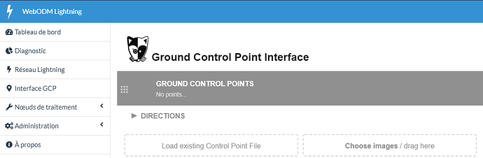

This file is the one you have to provide in the Load Existing Control Point File button in the GCP Interface tab:
Step 2:
Once this file is selected, the map on the right should position markers at the actual positions of the GCPs. If this is not the case, there is a problem with the coordinates of the GCPs or the announced Coordinate System.
Step 3:
After that you have to import the images and proceed to the selection of the GCPs on the images and their correspondence on the map. This is for me the simplest step but where the interface is the least well done (I highly recommend using GCP Editor Pro to generate the complete GCP file)
