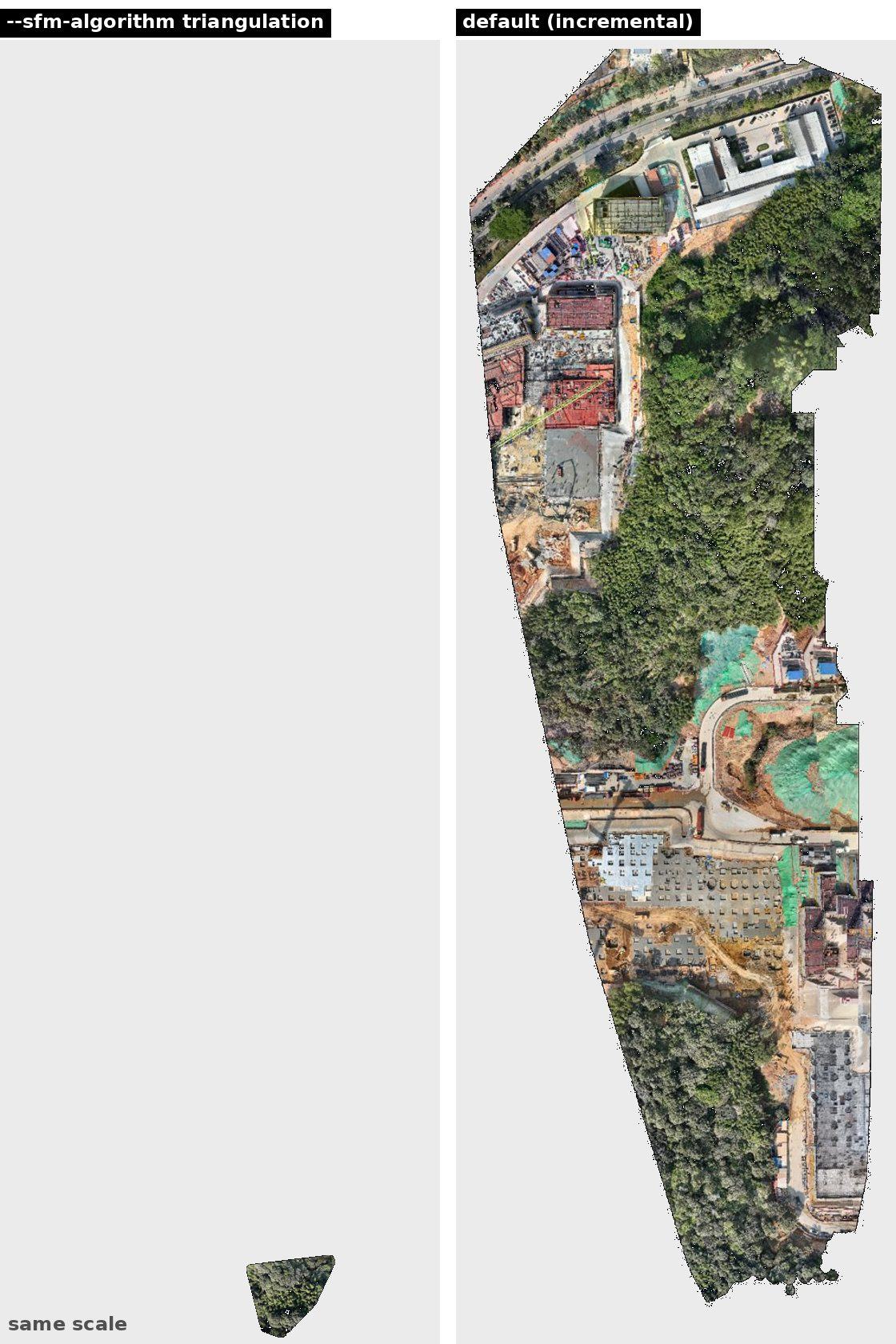

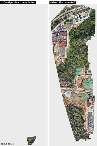

We ran your 99 M3D images (odm_datasets.zip) with your exact command (without --gcp) and with variations:
options reconstructed points orthophoto
your command (--sfm-algorithm triangulation, feature-quality low, fast-orthophoto) 1 329 broken (only a 56 × 52 m patch)
same + --auto-boundary 1 213 empty
same but without --sfm-algorithm triangulation 19 442 complete, 258 × 800 m, 10 cm, 2.8 min
Both orthophotos at the same scale
Cause: triangulation does not estimate the camera orientations, it trusts the gimbal angles in the EXIF. In 23 of your images (at the start, 0004–0033, and the end, 0095–0100) the camera was really tilted 11–51° away from the recorded −90°. The points triangulated from those images land far outside the site; in your run the model bounds became ±16 km (Model bounds x: -15933 → 10126), and the orthophoto for that area needs 558 GB – hence the memory error.
Fix: use the default sfm-algorithm (incremental) and keep --auto-boundary. The rest of your command can stay as it is.
