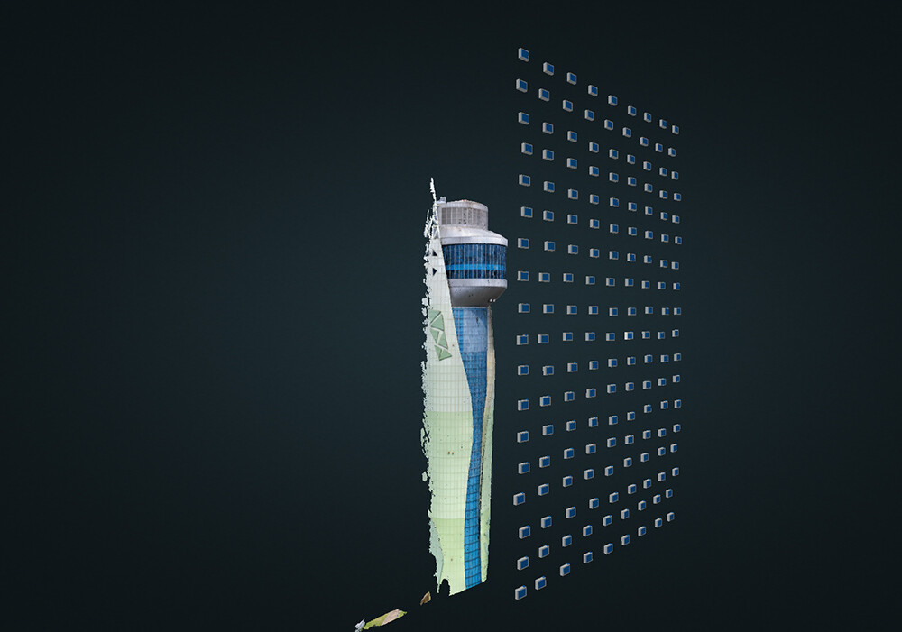

and my question is it looked way better before I updated the ODM new enginie, it was almost perfect with the default setting, but now with the newly updated engine, I don’t think I can make it any better without help.
The result data in the folder was processed with the following parameters by the way.
auto-boundary: true, crop: 0, debug: true, dem-gapfill-steps: 4, dem-resolution: 1, depthmap-resolution: 2048, feature-quality: ultra, gps-accuracy: 1, mesh-size: 300000, min-num-features: 64000, orthophoto-resolution: 1, pc-classify: true, pc-filter: 0, pc-geometric: true, pc-quality: ultra, pc-sample: 0.001, resize-to: -1, use-3dmesh: true, verbose: true
and the camera positions look like this.
Processed on the chrome and my system set up is,
Windows 10 - WSL2 - DOCKER desktop - WebODM
within the past 2 days, I’ve tried with different settings of the parameters and I keep getting almost no usable result. It would be appreciated if anyone can guide me. :folded_hands:

In your survey design, you should increase overlap/sidelap a fair bit more, as well. it will make reconstruction much better, and much easier.
Wow… this is so cool!! and this is jaw-dropping information for me, and thank you so much for the reply Gordon. :pray::+1: and you are so generous to share your tips of years of experience. I will try to figure out the GEOJSON part as well. The idea you pointed out helped real big. :raised_hands:
Saijin_Naib, you are like the Genie😀 in this community, and increasing the value of both changed a lot for the result. still need to work on the detail more but looks dramatically great already now.
They were 75 / 75 % each and changed to 85 / 85 % and the result looks like this.
Again, thank you so much for the tip. :pray::+1:
