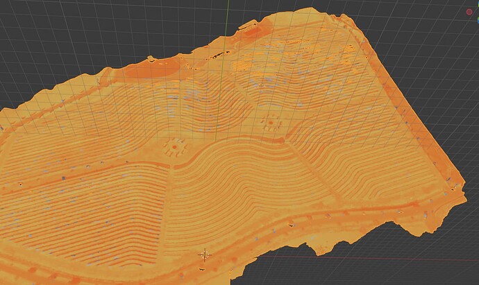

Something like that?
I do it quickly so everything is not following the yellow to red color ramp. It just to see if it is what you want

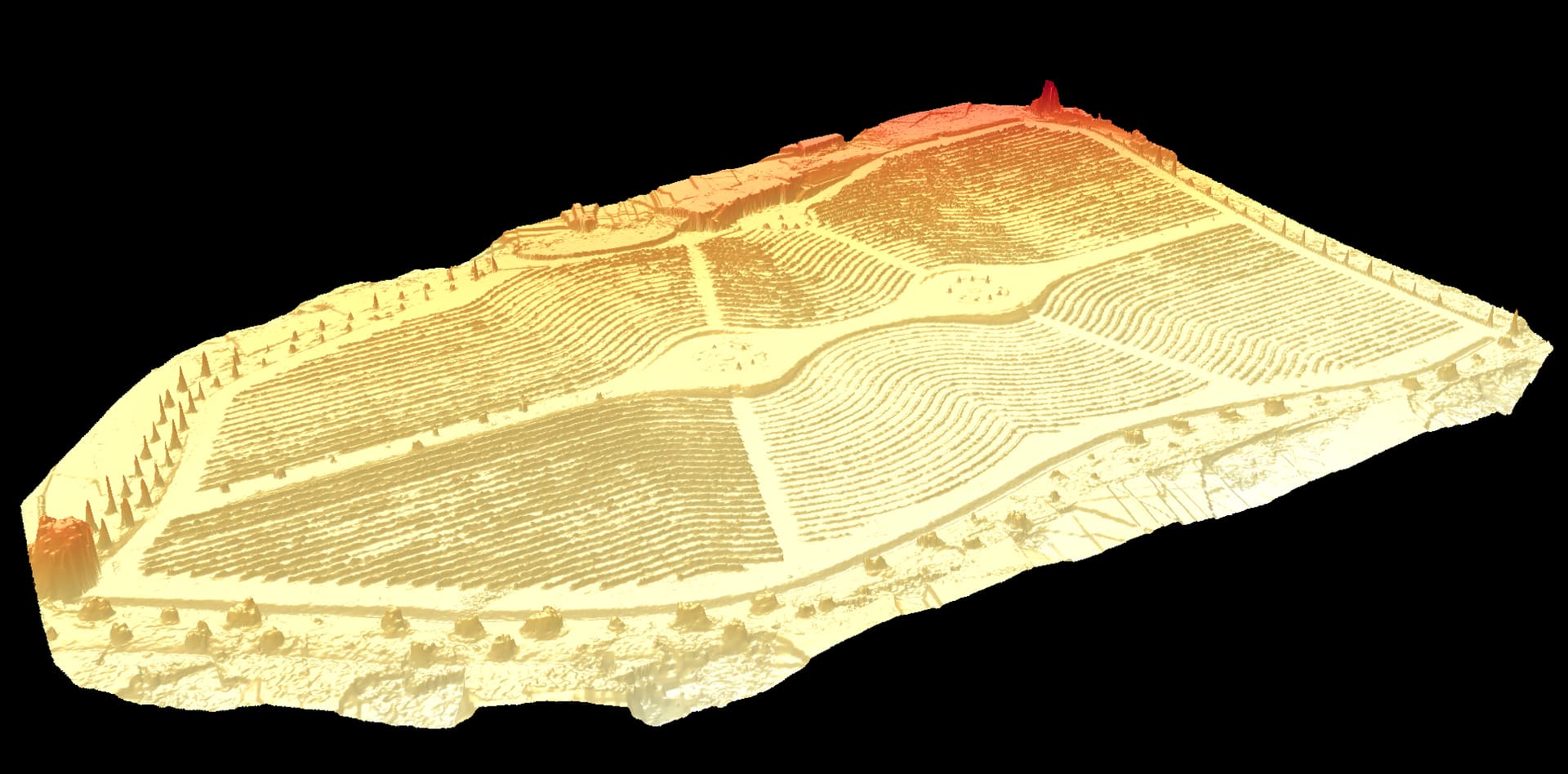

I took a stab at it (post-processed using temp as the height with some hillshading), because it’s lunch time! :grin:
As far as I’ve seen, there’s no method to use custom palettes for the 3D viewer, or specify color scales like you are describing. This would have to be developed.
As Dhuyp mentioned above, you will have to perform some post-processing for what you’re after. If you need something low-cost, then I would recommend QGIS to understand how to import 3D Model and adjust the shader options to your content.
