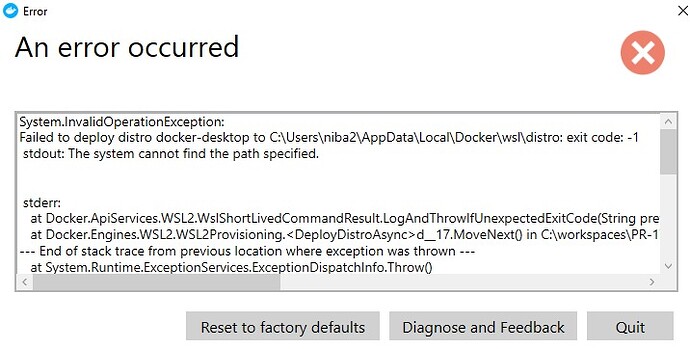

Hello, I’m new here and I’ve been reading “The missing guide”, but I haven’t been able to launch docker since I get this error:
I’ve tried many ‘solutions’ I’ve found online but none seem to work. I’m on Windows 11 Pro.

Hmm…
How did you install Docker? Have you verified that Docker is working correctly on its own?
I used the Docker Desktop Installer downloaded from Docker’s website. I can’t check if it is working correctly on its own because as soon as I open Docker I get that error.
