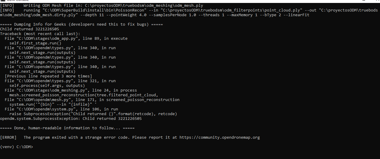

Error 3221226505
Hello Houston… we have problems here , When I made an attempt to do a process in native odm in windows 10, to get an improvement with dsm, the previous work I posted in the “split for newbes thread”, it gave me this error, I am doing it with little 4gb ram and 56 photos.

This error has been reported a few times before, but it still eludes us because I haven’t been able to reproduce it on my Windows machine, so I’m not sure what’s causing it.
Can you provide as many details as possible about your computer? Hardware, software installed (do you run any antivirus / security software?), OS version, disk space available would help.
