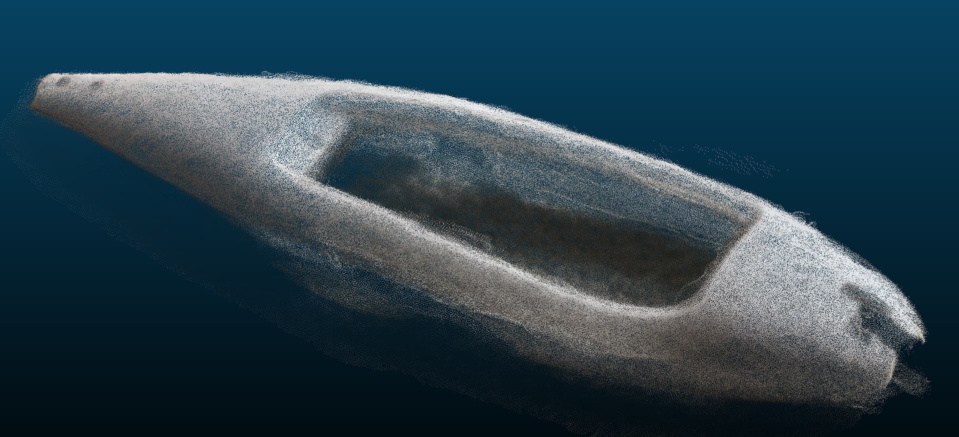

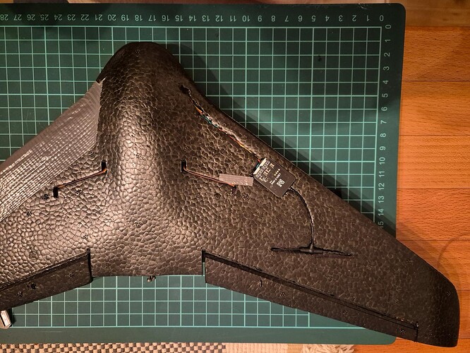

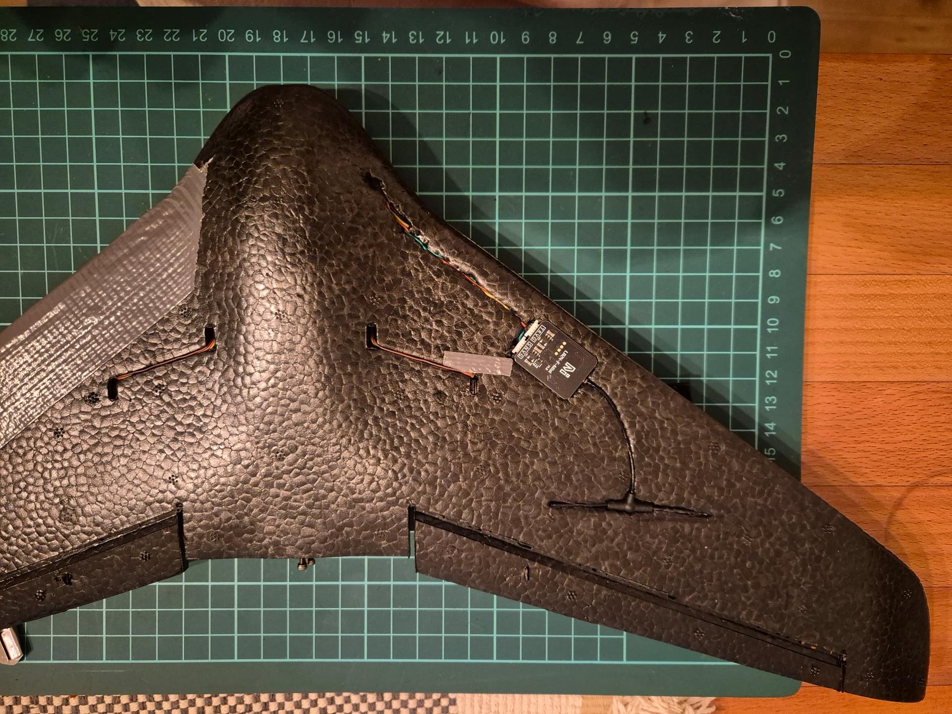

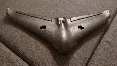

Took a bunch of photos of a cool partial drone body as a potential scan for a friend working on a drone build across the Atlantic. No plans to use it at the moment, but thought it was a fun drone inception case, so I thought I would post it.
A while ago i made a model of a concrete wall at work with my iPhone and GCP’s.
You only need a camera and WebODM.

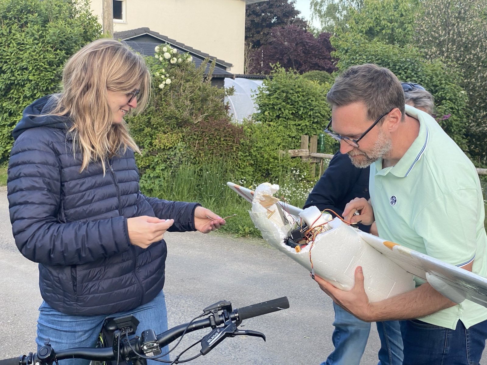

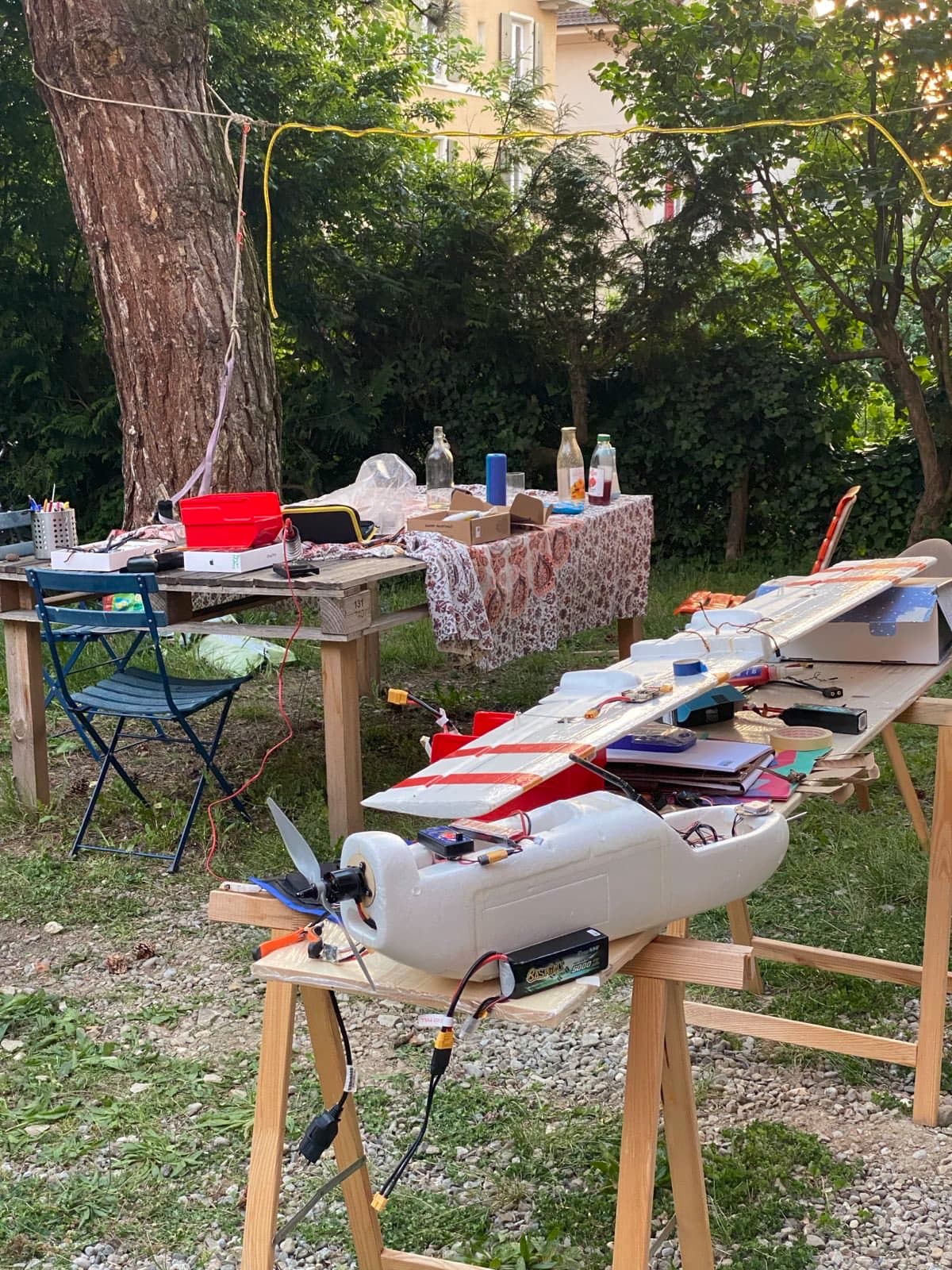

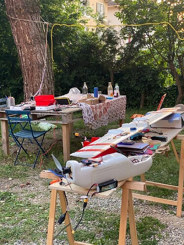

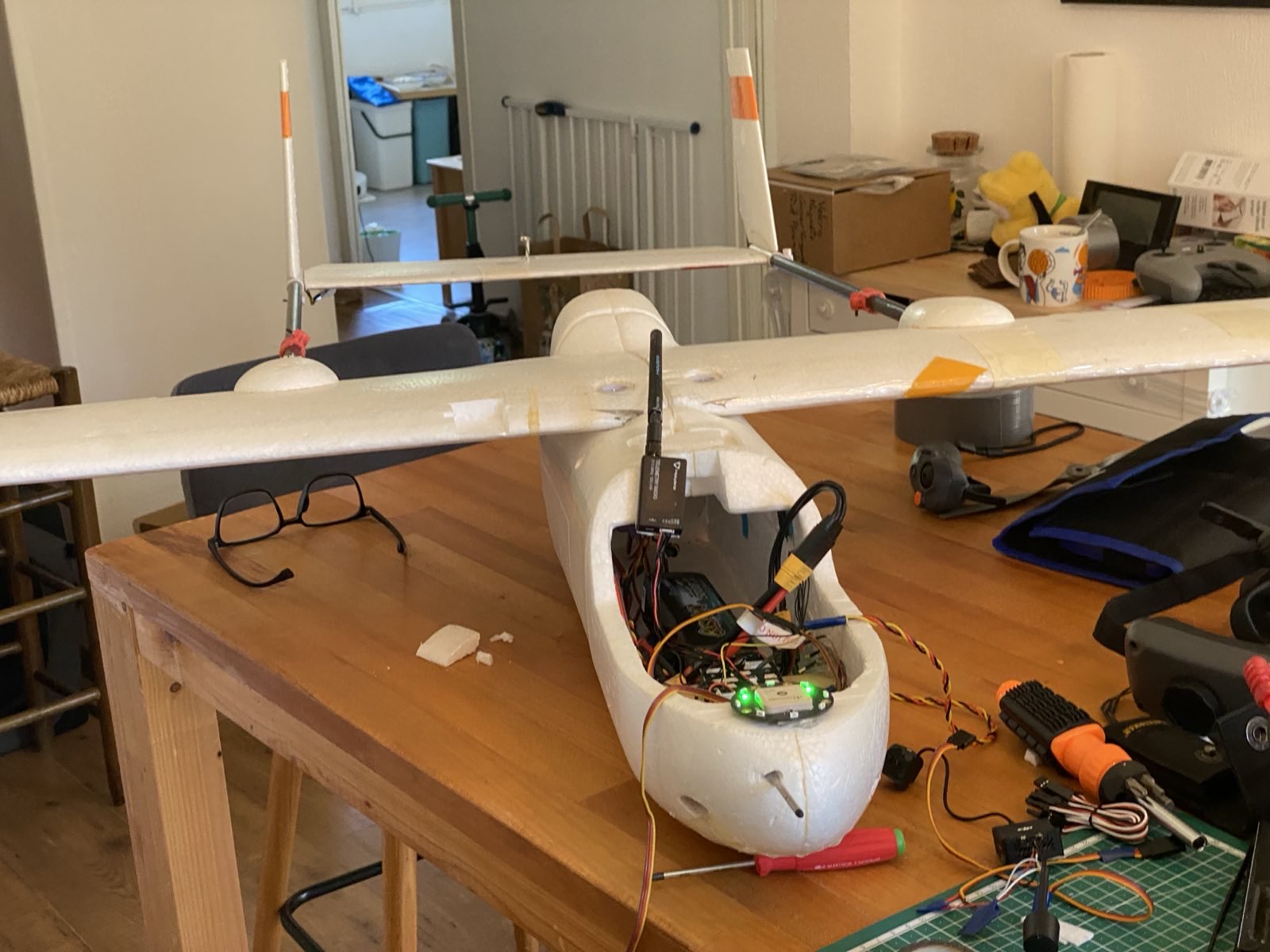

When we arrived, we didn’t have any fixed wings to fly. So Oriol dusted off an old Skyhunter and we started to build it out.

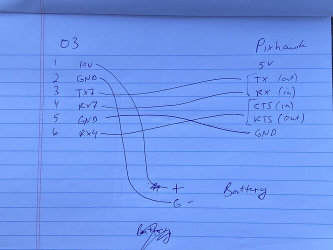

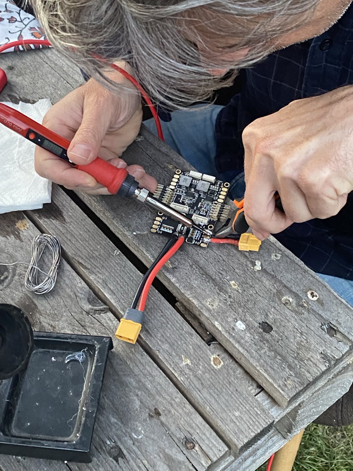

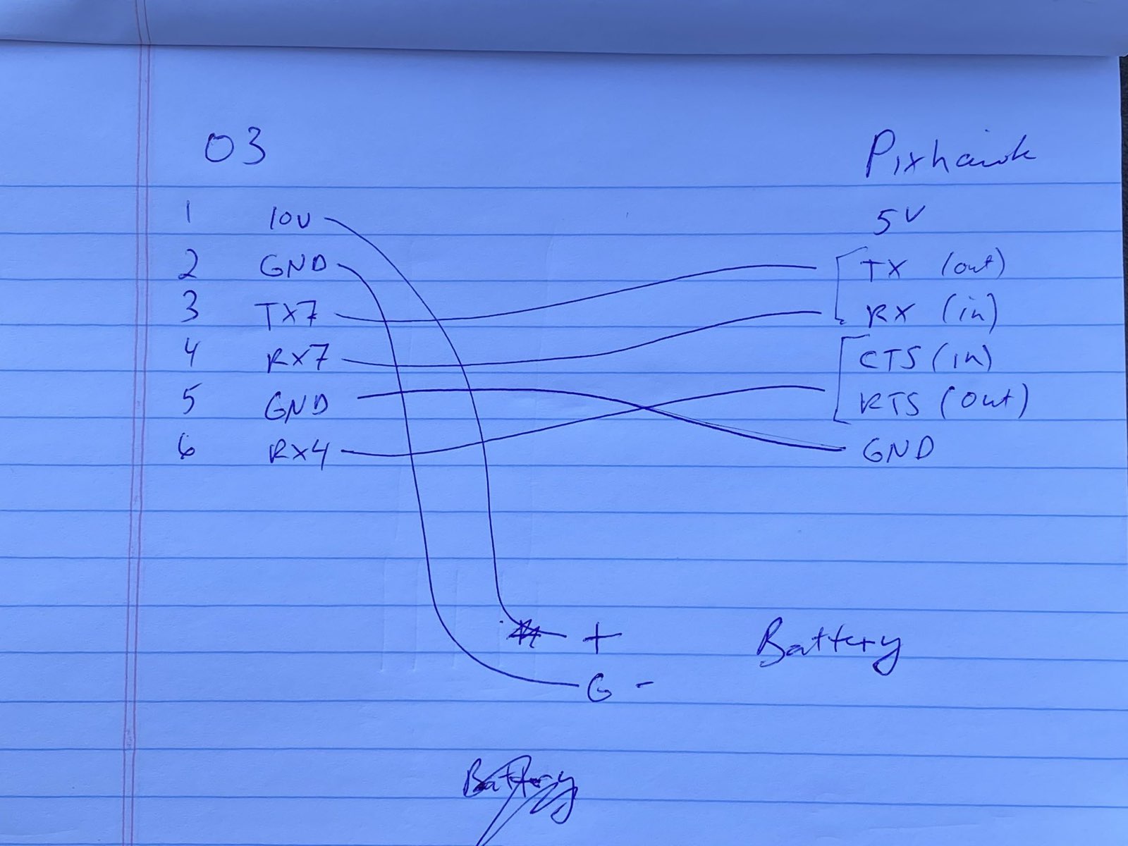

It took a couple days to complete the build. We married together a Pixhawk and a DJI O3. It was an unholy marriage, but gave us nice camera quality.
So we took it off to the field (sadly after Hubert’s departure) and flew it in the Jura mountains with a couple of Oriol’s friends, plus a munchkin in tow:
And we got the renewed bird in the air for a couple delightful flights:
ezgif-5c0e9a15f49464
Due to what was probably a power failure combined with lack of GNSS (GPS) compounded by a remote that defaulted to 50% throttle, we managed to crash spectacularly:

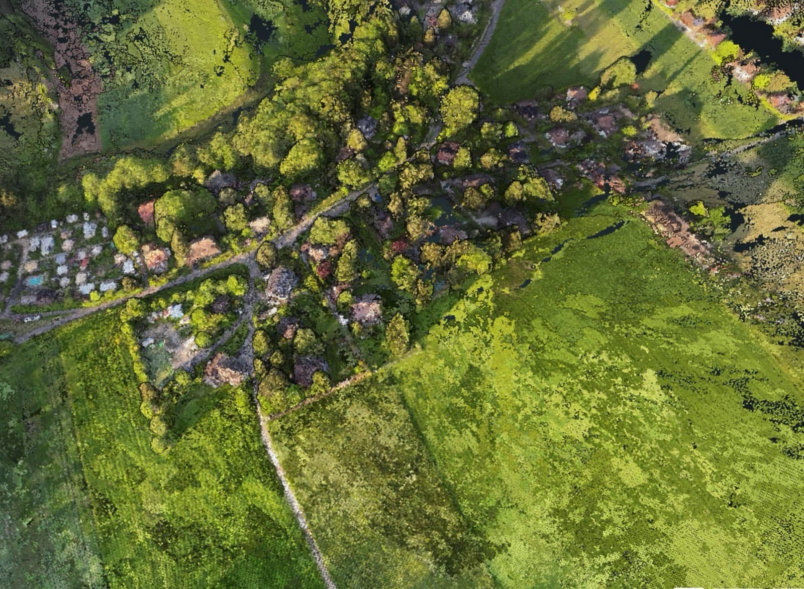

But not before gathering some data!

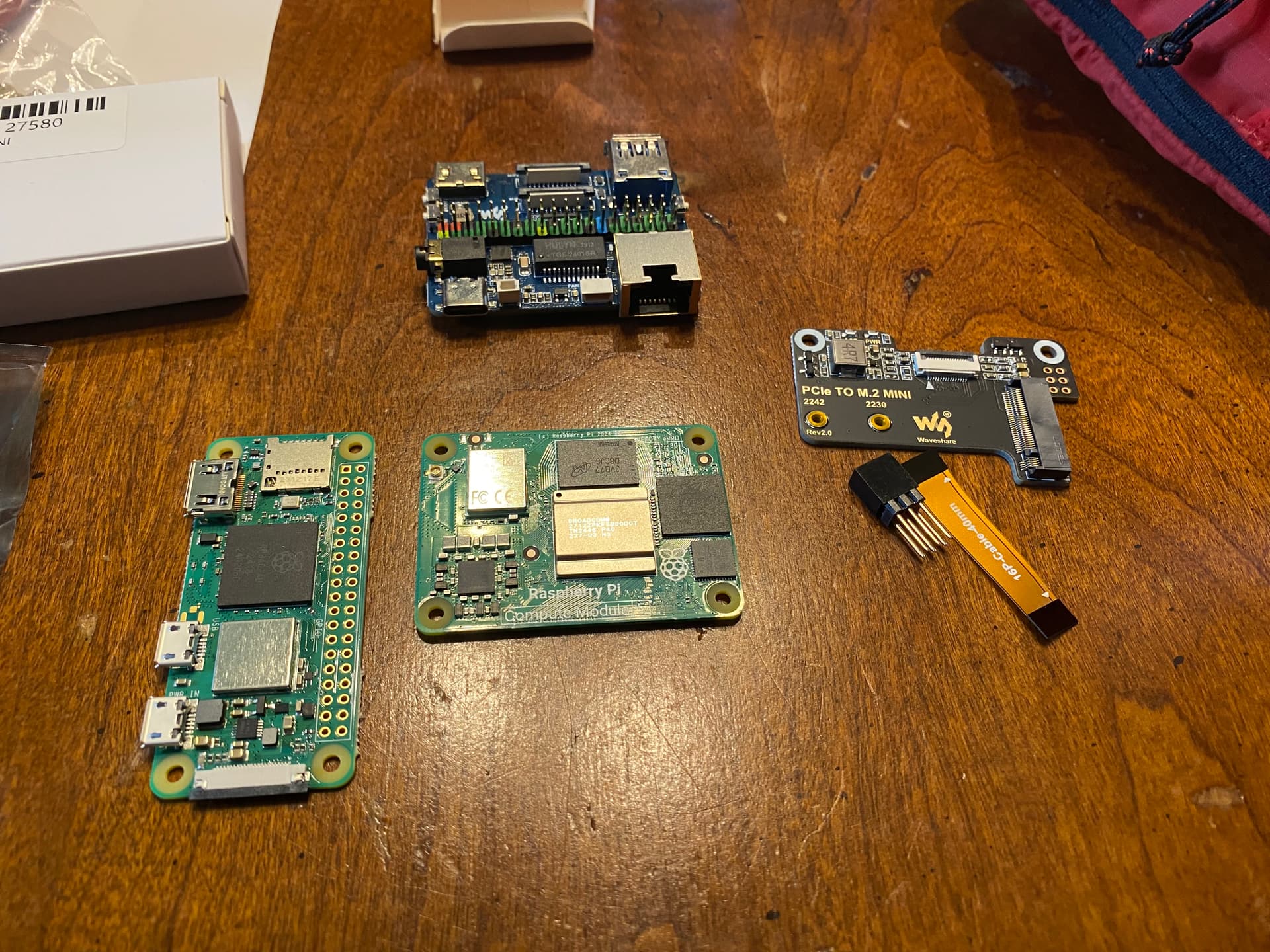

Some parts arrived today. I didn’t realize quite how small the Raspberry Pi compute module is:
Here it is next to the pi0 on the left.

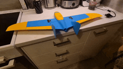

So what will the airframe look like? We don’t know yet, but we are testing a few things. We could focus on wire cut frames like a scaled up clone of this frame:
little_drone
or 3d printed frames like the Gremlin 640mm FPV plank:
big_drone

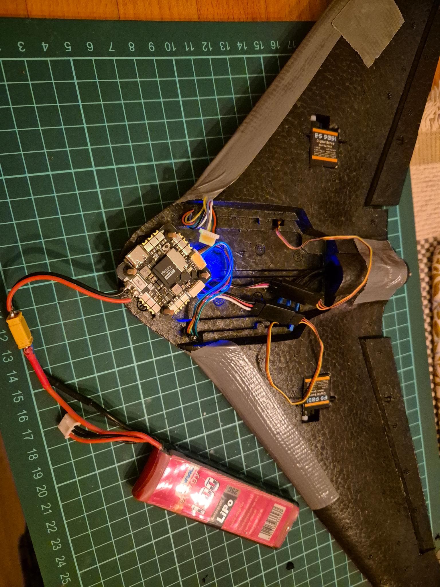

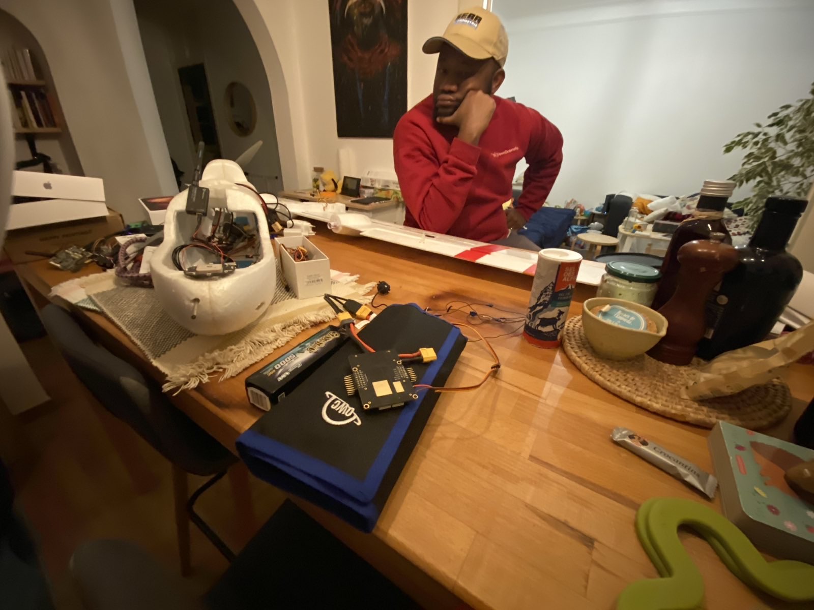

Oriol has sent us new pictures from his secret laboratory in Switzerland!
Ok. Maybe that’s his dining room table. It’s hard to say. But the little fixed wing should be flying soon, assuming the compass is willing to cooperate.
