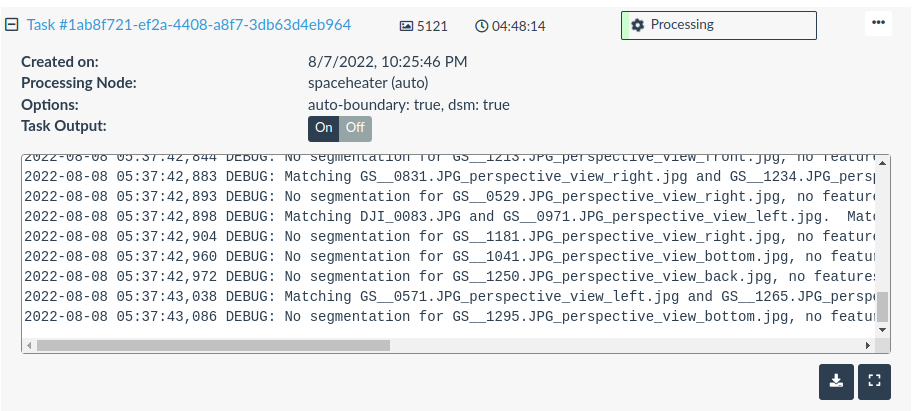

Hello!
I have been attempting to process a mixed data set (drone and GoPro 360) of images and have been getting odd errors. Everything else processes just fine but these datasets freeze.
They get about 3 hours in (11 hours on more intense settings) and stop processing but the task log does not show any errors.
Every time I refresh, the processing timer, resets to whenever it got stalled I guess. So if I check and it says 3:11:52 and I leave it for 5 minutes, it will say 3:16:52 and appear to be processing.
But if I leave and come back to the page or refresh, the timer resets to 3:11:52.
The processes also don’t successfully cancel. Is this a bug or a processing mishap? What are the next troubleshooting steps?
Note: This occurred before and after an update and I am currently running WebODM 1.9.15.

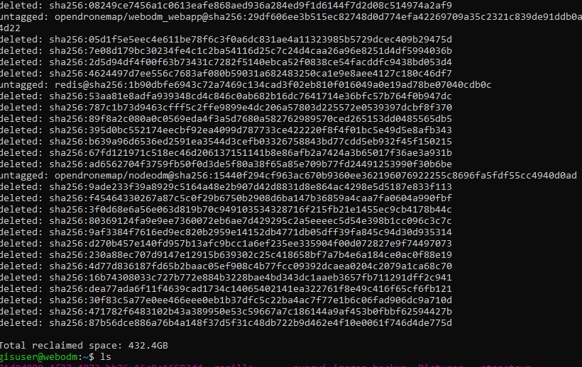

Still didn’t work…so I did something risky and messed around with docker.
I was getting errors in syslog about being unable to mount because ports were already allocated and thought maybe docker containers were hanging.
I ran: docker kill on the current container and then docker system prune (see image
After all of that, I still get a refused to connect error when I try to access webodm from the internet.

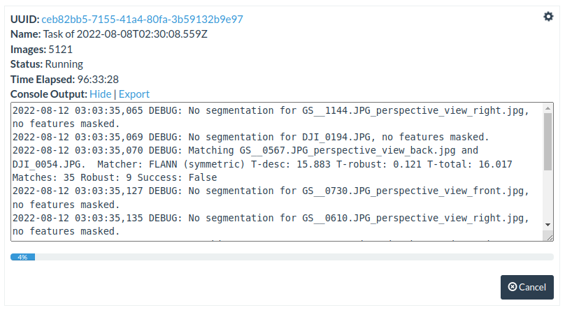

The dataset did indeed stall again. I will monitor the progress of the next attempt via the method you outlined.
Update:
There have been several stallings since my last attempt. But something odd happened. One instance where I had trimmed everything down to 988 images appeared to have stalled but when I ran a webodm down, update, start, the data set was marked as completed.
It didn’t look great but it was complete.
I tried to run two other datasets for about 20 or so hours. They were 1303 and 5110 images respectively. It appeared as though they had stalled so I attempted the webodm command again but this time I got a processing node went offline error for both.
I feel like this dataset is triggering a bug where the front end and task output may not be updating with what is actually going on in the background. In addition, the dataset is taking a long time to process given the number of images and amount of RAM I am working with.
