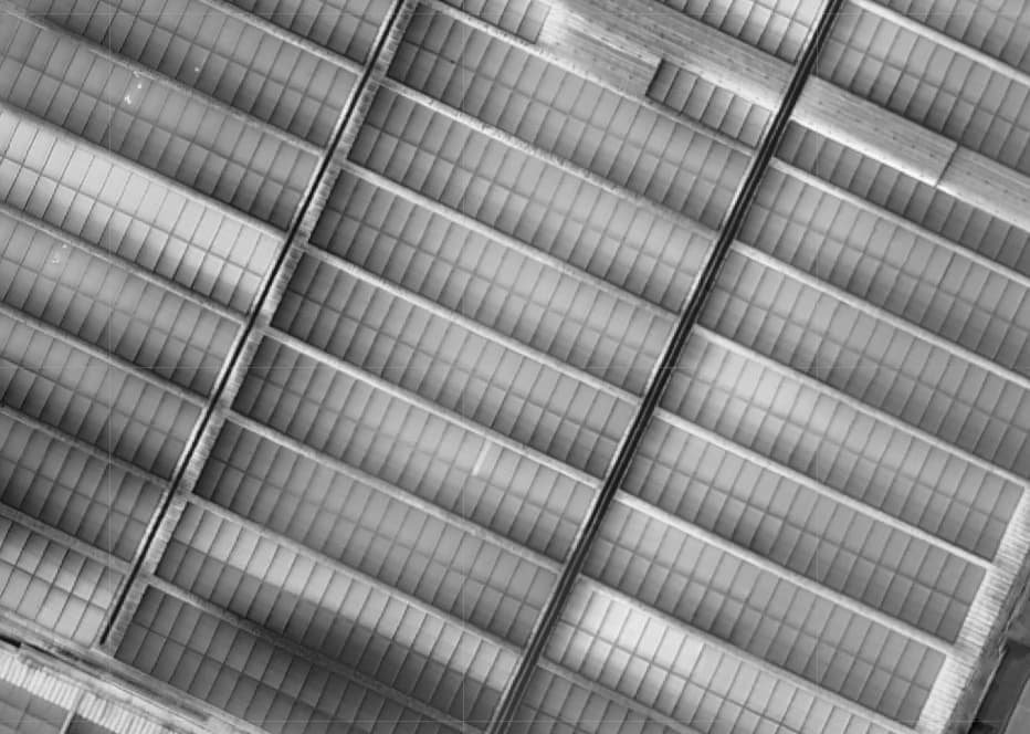

Distorted Orthomosaic
Hi!
Heads up, this is my first time using ODM or any photogrammetry tool in general.
Here’s a brief detail about the issue.
Objective
I’m trying to create an Orthomosaic of solar power plant.
Issue

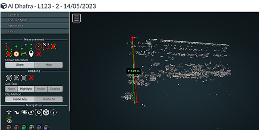

  • Distorted Orthomosaic possibly due to poor point cloud.
  • PC spans ~700m in height/depth.
Processing parameters
auto-boundary: true, mesh-size: 300000, feature-quality: ultra, pc-quality: ultra
Any advice on trying with different parameters?
Deployment stack
Docker + GPU (Tesla T4) on EC2
Dataset link (425 Images)
https://drive.google.com/file/d/1kNZSmRu9OOzWvoPbV8La5h8gAyTq5cPF/view?usp=sharing

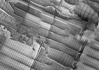

Distorted Ortho
All downloadable assets link -
https://drive.google.com/file/d/1jXN1gUOarYl7PyuNjzTrcxG1Q6d6cH3V/view?usp=sharing
Point cloud image

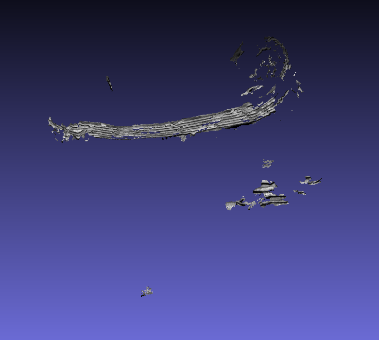

I’ve had a few goes at this, one produced an ortho with a bit less distortion than your image above, but the others failed, telling me my Graphics card drivers were out of date (they aren’t) and then running out of memory, which is very strange, as I don’t see that error with 389GB of RAM (96GB) + virtual memory, with much larger tasks.
I also noted that only a small number of features were being found, even going to very low thresholds (I think well into noise) only ~3-4000 features being detected.
However the time it worked, it did produce a single reconstruction, even though it is very messy.
3D model in Meshlab
Sorry for the trouble! Could you please start by describing your dataset and your Processing Parameters?
For example:
  1. Image Resolution (Megapixels)
  2. Image Count (Number of Images)
  3. Image Band Count/Type (BGR [3], BGRN [4], etc)
  4. Flight Plan (Grid, Cross-grid, Corridor, Orbit, Free-Flight, etc)
  5. Flight Plan Frontal Overlap and Sidelap
  6. Flight Plan Ground Sample Distance (GSD)
  7. Processing Parameters from WebODM
PFB dataset details
  1. Image Resolution (Megapixels) - width:640, height:512, Megapixels:0.328
  2. Image Count (Number of Images) - 425 images (subset of whole solar plant containing ~2.7K images)
  3. Processing Parameters from WebODM - auto-boundary: true, mesh-size: 300000, feature-quality: ultra, pc-quality: ultra
  4. Image Band Count/Type (BGR [3], BGRN [4], etc) - Grayscale IR images have a single channel and represent the intensity or temperature values. There is no color information in these images. There is only one band representing the intensity of the infrared radiation.
  5. Flight Plan (Grid, Cross-grid, Corridor, Orbit, Free-Flight, etc) - The flight plan was a corridor Mission, however, we collected the corridor mapping with a 17meter distance between the flight path lines, which will be around 42% of side overlap at 4.5Cm/Pix
  6. Flight Plan Frontal Overlap and Sidelap - Frontal Overlap of 60% and Side overlap of 42%
  7. Flight Plan Ground Sample Distance (GSD) - GSD-4Cm/Pix

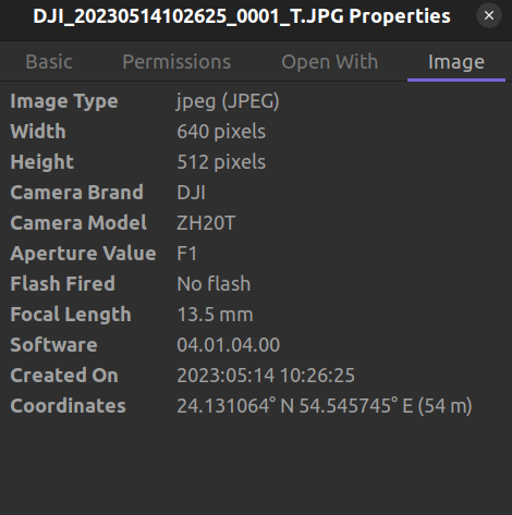

Also attaching properties and exif data for one of the image for a quick glance
Screenshot from 2023-06-09 11-25-43
EXIF Details

Minimum recommend overlap and sidelap is 65%, so you are well below that, unfortunately.
With these really low-resolution Thermal images, tighter is way better, and makes for less frustrating reconstruction and better results.
Can you refly with frontal overlap maxed out, and side overlap at 75% or so?
If you want good 3D, you will want 85% or tighter.
I am curious mostly for my own knowledge if you are attempting to create a ortho of this site then why use the thermal images instead of the regular 12mp images this camera is capable of?
Hot-spotting on the panels can show potential damage or upcoming failure. Really important for maintenance and inventory.
that makes more sense now.

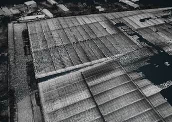

Hi, unfortunately, getting images with higher side overlap of same solar plant was not possible.
But I was able to get my hands on another dataset with ~80% front and ~60% side overlap and was able to get much better point cloud and ortho for most part.
Point Cloud
Ortho

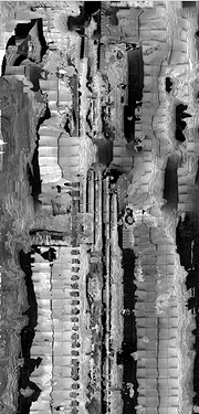

But there are still some places where ortho is very distorted
I was wondering if I can apply wallis filter which adjusts brightness values in local areas so that the local mean and standard deviation match user-specified target values, which in turn, may help in identifying more key points for better matching images.
But I’m unable to process the dataset with error -
The camera directions mean is unbalanced; the scene will be considered unbounded (no ROI).
I had also checked that EXIF data is copied to wallis images for geo-referencing as suggested here.
Assets
Dataset - 6GSD_IR.zip - Google Drive
Wallis Dataset - 6GSD_IR_wallis.zip - Google Drive
Failure Logs - console.txt - Google Drive
EXIF original - DJI_0001_T_orig.txt - Google Drive
EXIF Wallis - DJI_0001_T_wallis.txt - Google Drive
Python script to convert original dataset to Wallis - wallis.py - Google Drive
Let me know if any more info is required which might be missing. Thank you.
Also, any update on these queries.
