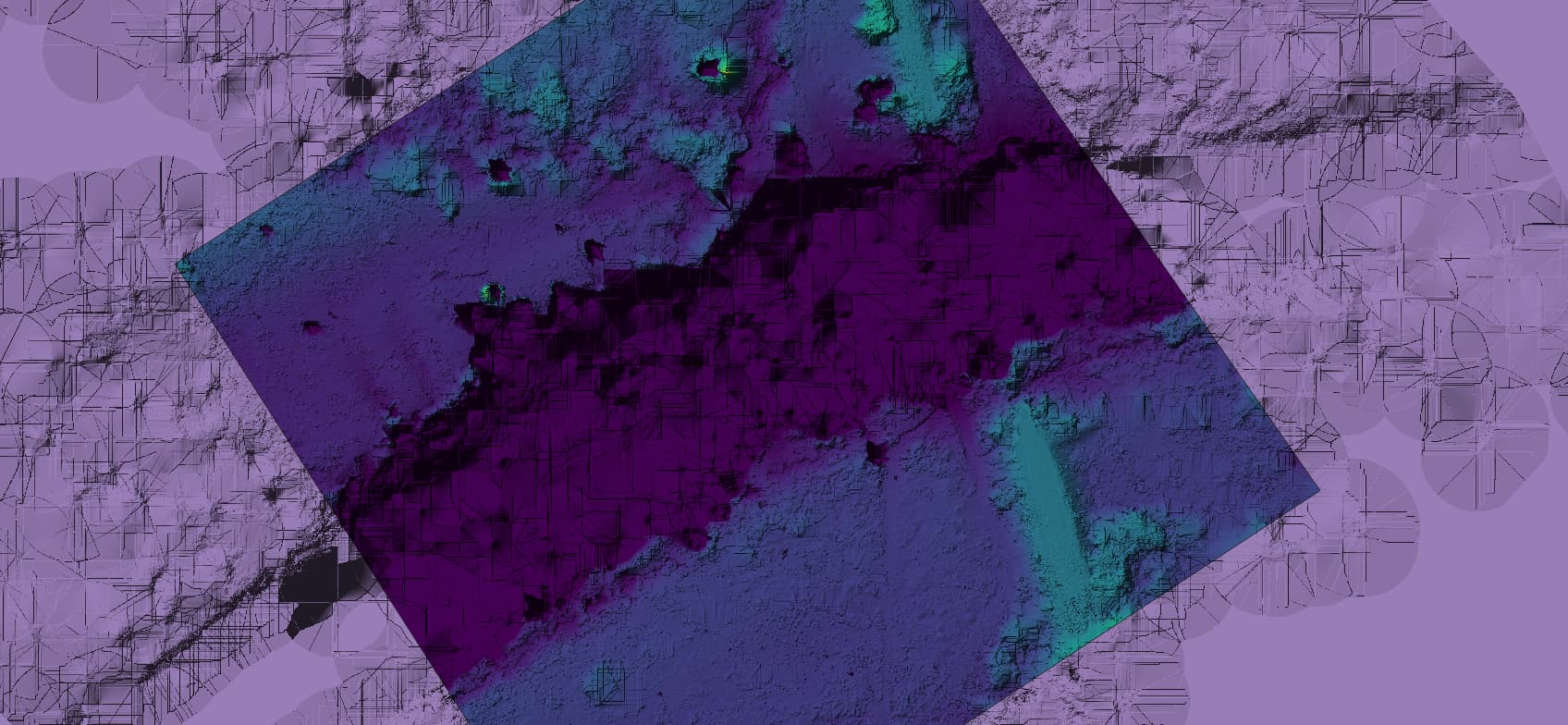

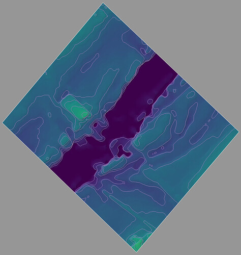

I am working on a project that requires some refined handling of elevation models over waterways and I am refining an approach that looks quite promising. With defaults, we see a terrain model that looks something like this (presented in QGIS, so trimmed with a mask, etc.):

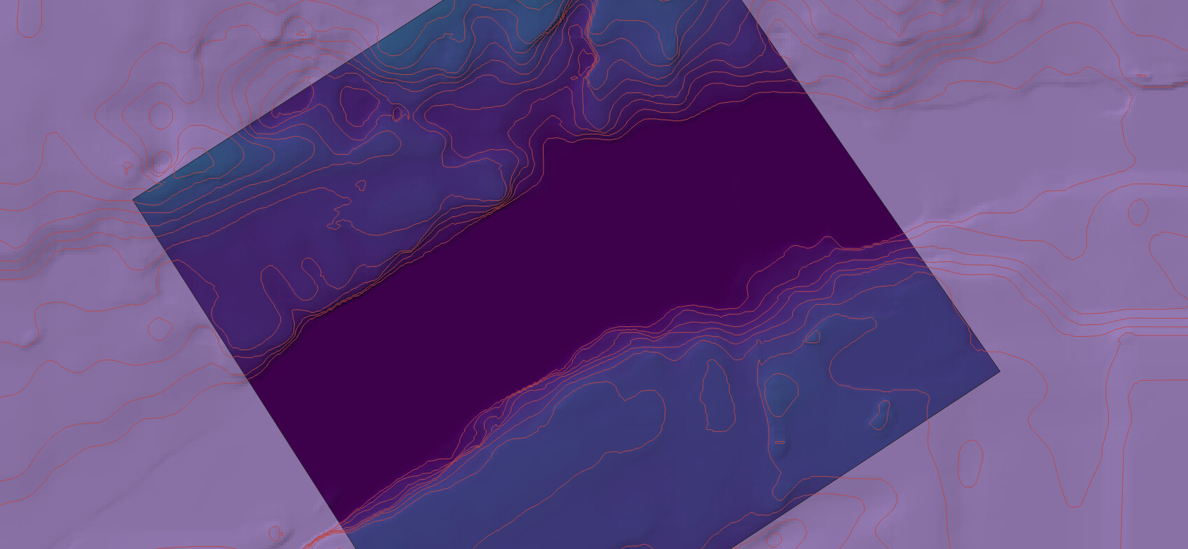

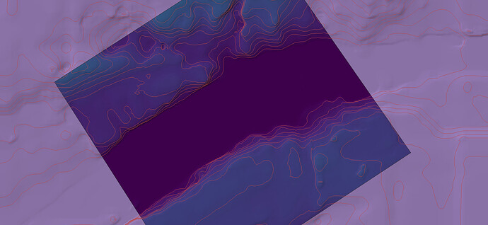

It’s a bit messy to say the least, especially along the shorline. With some refinement of approach, and the addition of a minimum elevation, we can get something like this (with 1m contours added so you can see how smooth it is):

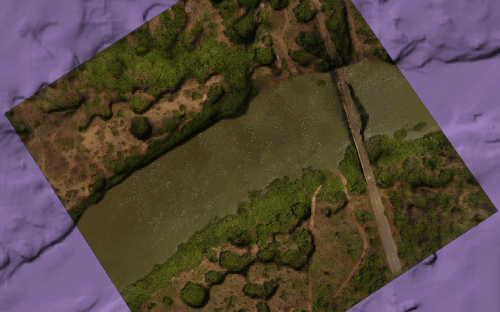

One more view with orthophoto (overlayed with hillshade of DSM), resultant DSM, and final DTM:
bamboi_filtering
That looks really good! I vote for including in ODM with a separate configuration option (vs separate processing utility). If no other test data appears, I’ll check my archives when I’m back in the office at the end of the week.

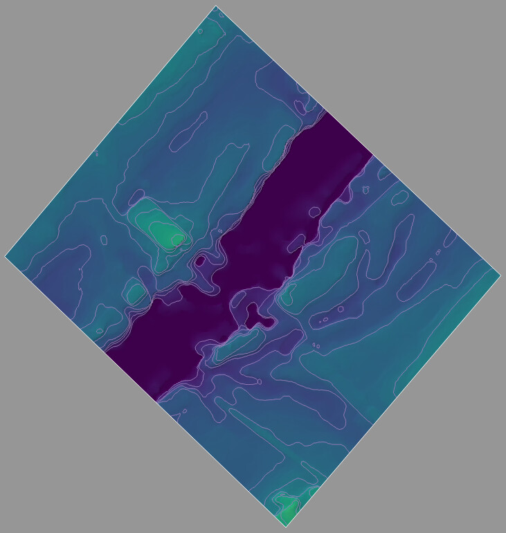

A vote for integration, and I look forward to the data! I tested a second dataset, and it worked well, but is not without it’s challenges, so other examples still quite welcome, as I’m sure we’ll find some edge cases (DTM, with hillshade and contours (1m) after processing only):
We can see this one doesn’t isolate the water as well, but I’ve got another project in the pipeline for that. We can’t expect a single parameter model to do all the heavy lifting, I guess. :slight_smile:

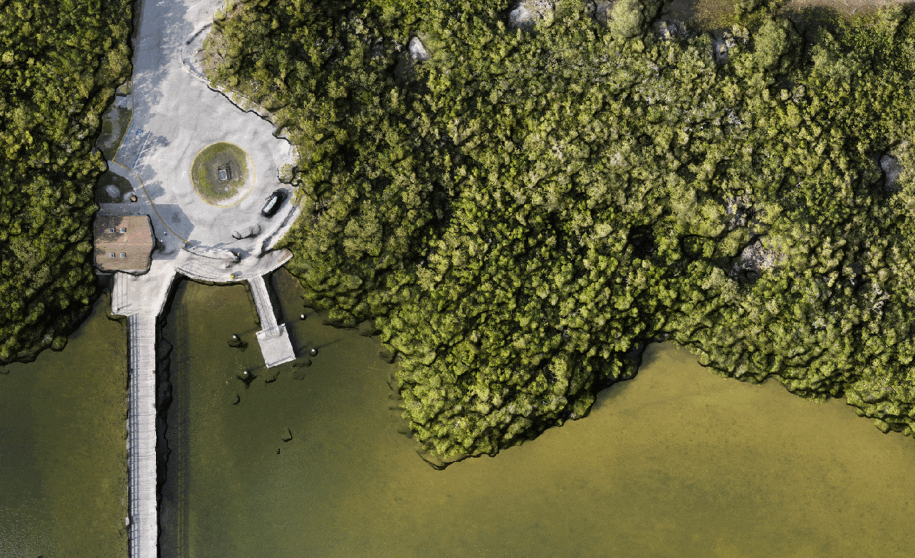

In the meantime, here’s another test dataset, this one with proper flat water unlike the river examples:
ezgif-3-e53e64d991
And here’s a couple of intrepid explorers verifying the flatness of the water as some dolphins zoom through in the background:
