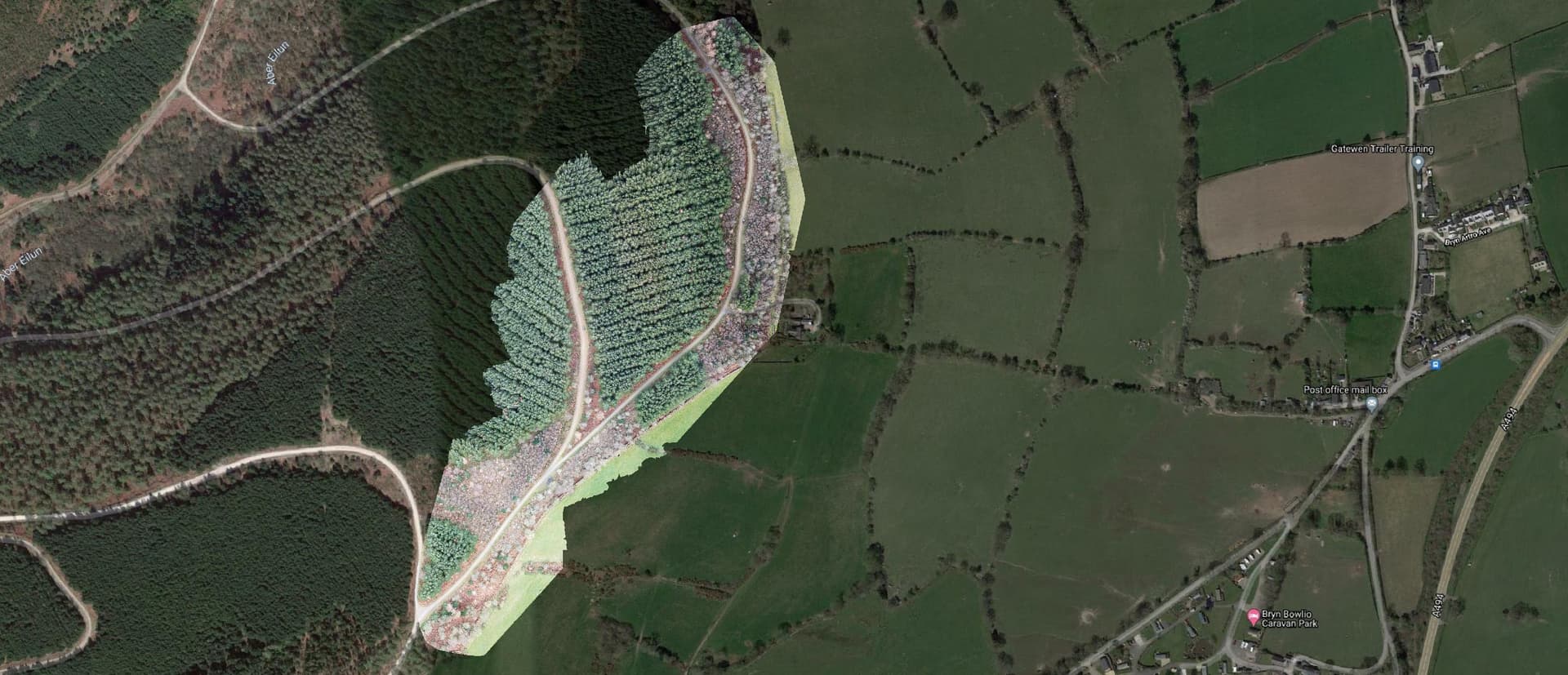

Hello, I’m afraid I’m a real novice to this!
I’m hoping somebody might be able to help, for some reason I keep getting incomplete orthophotos and I’m using the default settings in webODM. My result is below and the images are here:
https://www.dropbox.com/sh/wxmu184u267zf01/AABw5owVd3PAl9By1zAFIJD2a?dl=0
The area was flown at 100m with 75% overlap front and side.
export settings:
Created on: 1/1/2022, 11:41:48 PM
Processing Node: node-odm-1 (manual)
Options: ignore-gsd: true
Average GSD: 5.67 cm
Area: 372,501.83 m²
Reconstructed Points: 1,508,045
many thanks
Jonathan

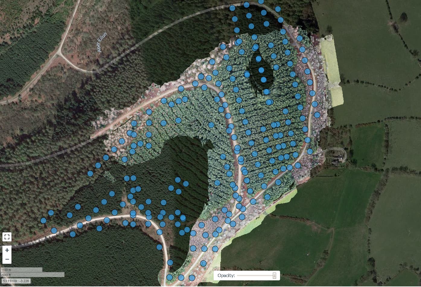

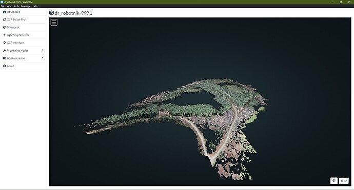

I think we have a bit of a interplay between terrain and overlap/sidelap, as well (look at the ridge):

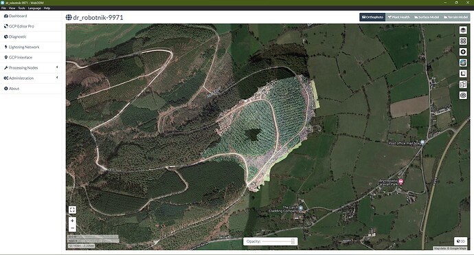

Created on: 1/2/2022, 7:12:16 PM
Processing Node: UAV4Geo - Lightning (manual)
Options: auto-boundary: true, crop: 0, debug: true, dem-gapfill-steps: 4, dem-resolution: 1, dsm: true, dtm: true, matcher-neighbors: 0, mesh-size: 300000, min-num-features: 64000, orthophoto-resolution: 1, pc-classify: true, pc-filter: 1, pc-geometric: true, pc-quality: high, pc-sample: 0.01, resize-to: -1, use-3dmesh: true, verbose: true
Average GSD: 3.31 cm
Area: 446,070.47 m²
Reconstructed Points: 12,791,419

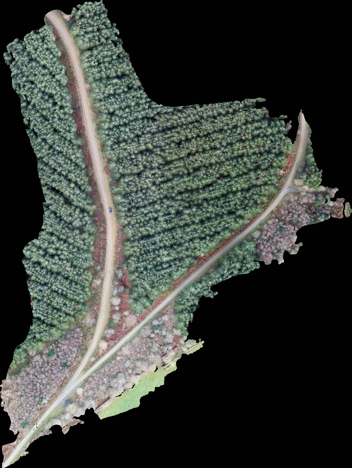

My ortho attempt, showing the photos I thought I could use, with the most blurry ones removed, but almost all of the remaining ones showing motion blur.
Shutter speed should have been no longer than 1/50 sec for the GSD of 5.6cm in your QR.

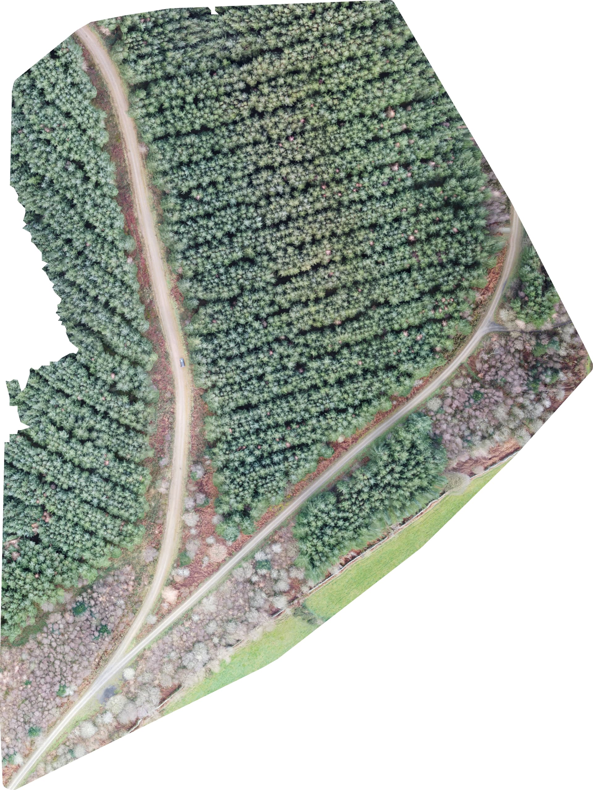

Strange that I’m using your same settings but my result is not as complete as yours?
Created on: 1/3/2022, 1:51:23 PM
Processing Node: Lightning (manual)
Average GSD: 6.33 cm
Area: 434,369.54 m²
Reconstructed Points: 2,919,652

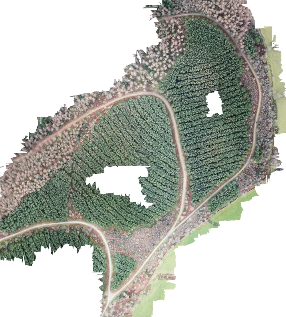

Created on: 1/3/2022, 11:13:32 AM
Options: auto-boundary: true, crop: 0, debug: true, dem-gapfill-steps: 5, dem-resolution: 1, dsm: true, dtm: true, matcher-neighbors: 0, mesh-size: 300000, min-num-features: 32000, optimize-disk-space: true, orthophoto-resolution: 1, pc-classify: true, pc-filter: 1, pc-geometric: true, pc-sample: .01, resize-to: -1, skip-3dmodel: true, verbose: true
Average GSD: 3.34 cm
Area: 416,951.75 m²
Reconstructed Points: 3,642,026
Mine turned out like this however I changed the settings a bit.
