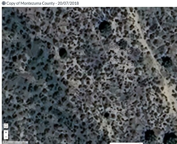

First go with 10000 min-num-features looks the same, so I suspect not enough overlap, plus it’s just a single line of images. The DEMs are more complete, but with artifacts. Single reconstruction reported, but it is a number of just off E-W stripes.
Running this task with various settings I discovered that DSPSIFT completes (the ortho is broken), but SIFT fails, with everything else identical.
[Copy of Copy of Copy of Montezuma County - 20/07/2018](javascript:void(0):wink:
00:01:34
Processing failed (4294967295)
|Options:|dem-resolution: 1.0, dsm: true, dtm: true, feature-quality: ultra, gps-accuracy: 10, mesh-octree-depth: 12, mesh-size: 500000, min-num-features: 30000, optimize-disk-space: true, orthophoto-resolution: 0.5, pc-filter: 4, pc-quality: ultra, pc-rectify: true, rerun-from: dataset, use-3dmesh: true|
00:04:12 Completed
|Options:|dsm: true, dtm: true, feature-quality: ultra, feature-type: dspsift, gps-accuracy: 10, mesh-octree-depth: 12, mesh-size: 500000, min-num-features: 30000, optimize-disk-space: true, orthophoto-resolution: 0.5, pc-filter: 4, pc-quality: ultra, pc-rectify: true, rerun-from: dataset, use-3dmesh: true|
|Average GSD:|0.32 cm|
|Area:|57.98 m²|
|Reconstructed Points:|1,236,397|
