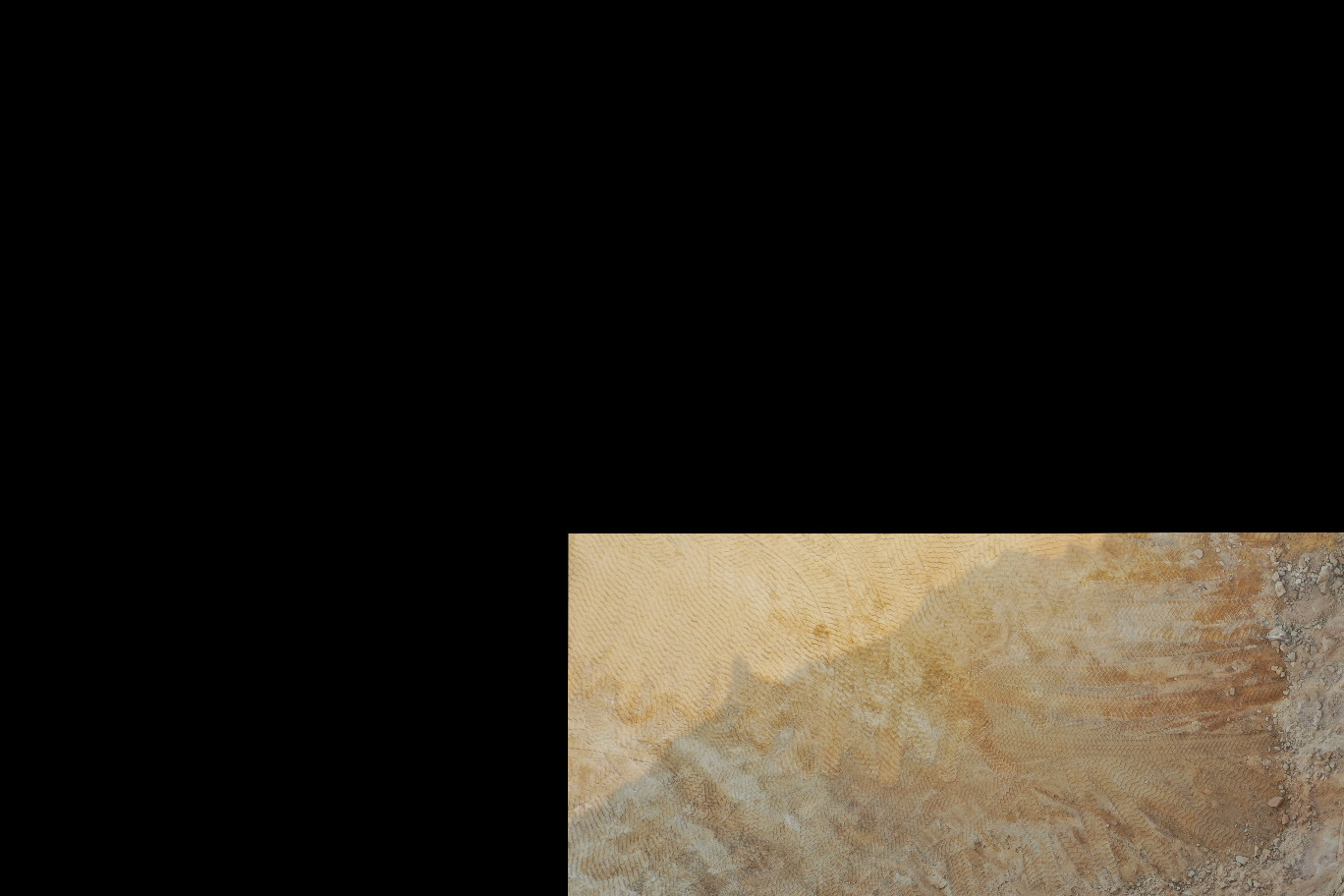

I noticed an issue in dense pointcloud reconstruction for some datasets. The boundary of the dense pointcloud is far smaller than the sparse one. I’m not sure why it happens. Tried both pc-geometric and pc-skip-geometric but won’t help. If you can see the first image, the sparse one basically covers all the area that the drone covers, but the dense point cloud in the second image, missed a lot of area around the boundary, and also has strips probably due to particular images’ depth data is not merged. I used docker odm 3.1.7(latest), tried feature-quality medium, and high, pc-quality, low, medium, and high. Also can confirm older version exist the same problem.

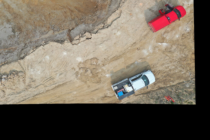

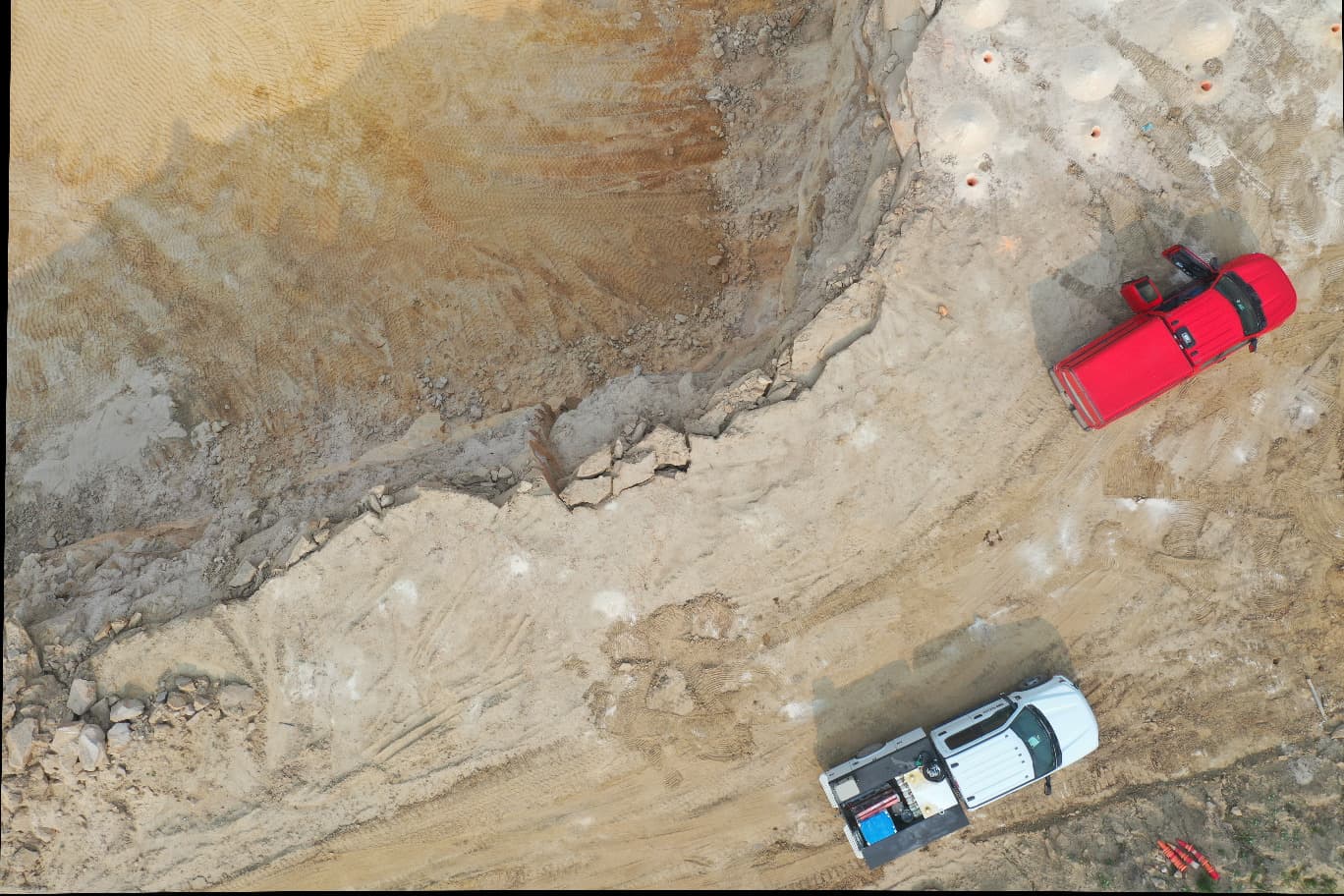

I found the cause, the problem still comes from opensfm stage. The undistorted images are all like this(feature-quality:medium). The overlapping looks decent, I’m trying to tweak the parameters to see if it can be fixed.
feature-quality: high

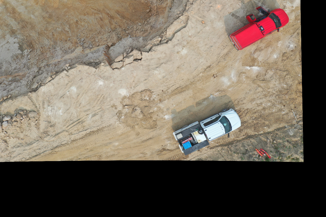

feature-quality: low
And amazingly, feature-quality:low and min-num-feature:500. This gives the best dense pointcloud reconstruction results.

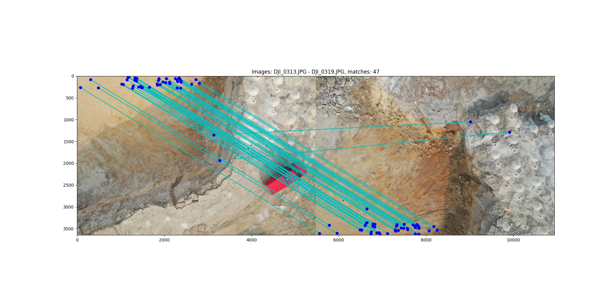

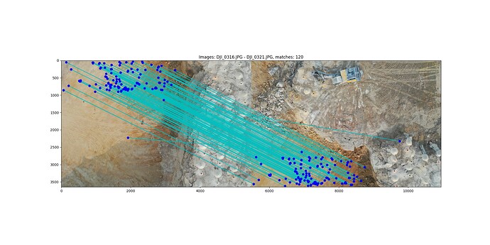

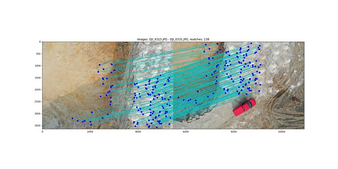

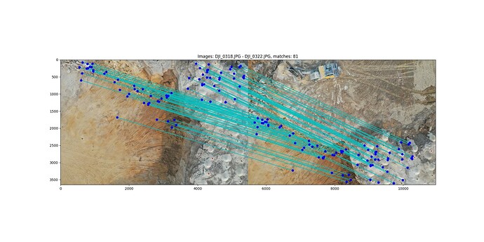

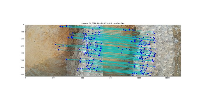

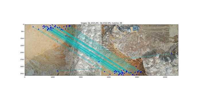

Did some checks on the matching results. For medium quality, most matches could have 1 or 2 mismatched features, but overall matchings are still good. I think these wrong-matching features should be filtered out during bundle adjustment because good matches are still in majority? But seems the wrong matches are affecting results. In feature-quality: low & min-num-feature: 500 reconstruction, there are fewer features matched, but at the same time, there is no wrongly matched features
feature-quality: medium
ORB feature works properly in this dataset, also no wrong matches when I plotted the results, I guess it’s some issues related to SIFT?
