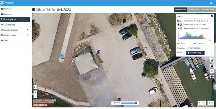

After that, I ran processing (I selected all images and file_gcp at the same time and uploaded), after processing was done, I could see that everything looked good, in the report GCP are under 1cm in the orthophoto GCP is on my markers, but in the left corner, I see coordinates that are in WGS 84, so why are not in my projection?

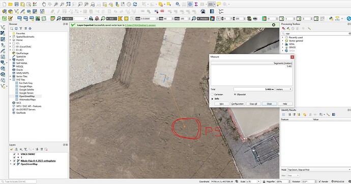

I exported the orthophoto with EPSG 3909, and after I uploaded it in QGIS I noticed that CRS is 6316 (why)…I uploaded my GCP and I could see that the markers are about 5m away from GCP points, although in WebODM UI were in a good place
I also exported Ortophoto and GCP in the same projection 3909 (also 6316) and again GCP is not on markers on Ortophoto, 5m far are.

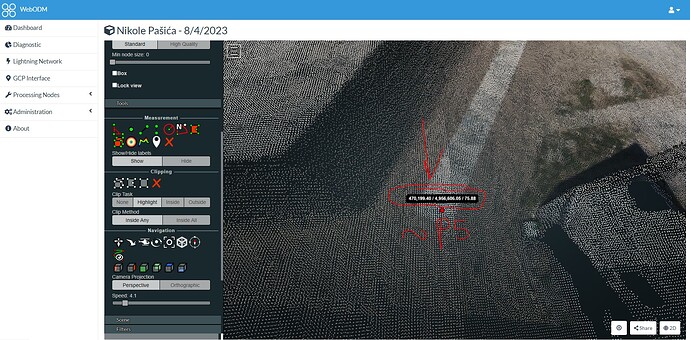

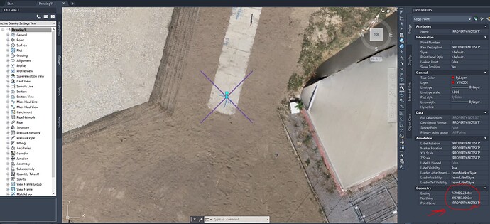

Also in Point Cloud I saw that heights are good but some strange coordinates are shown when I place points on my marker in Web ODM UI and compare results with my coordinates for this marker.

We currently always do reconstruction in the most appropriate local UTM CRS, so you might want to convert all input/output products to match that CRS to reduce such issues.
Qgis tries to guess the right EPSG/crs, if it gets it wrong then you need to set it yourself.
