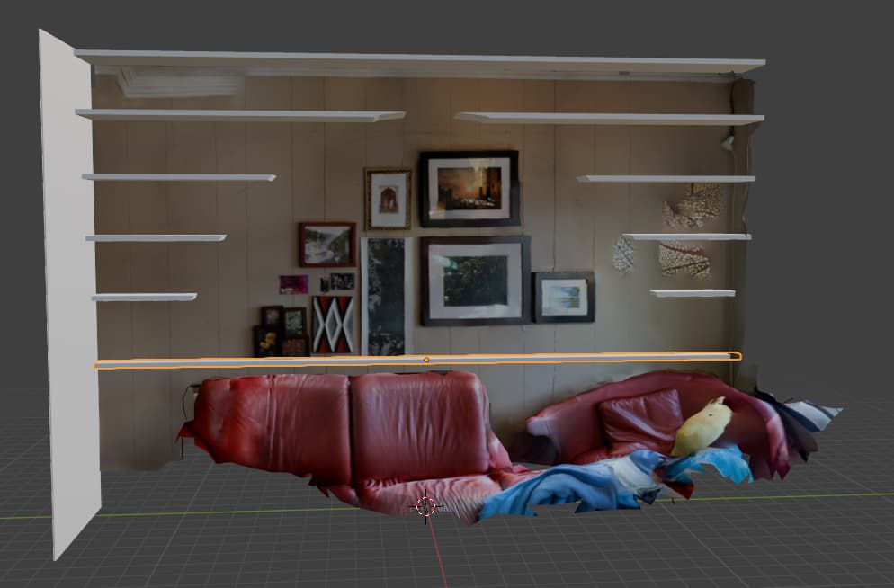

Here’s a mock-up I did of my living room wall propose shelving with existing wall art and a little of the couch:
