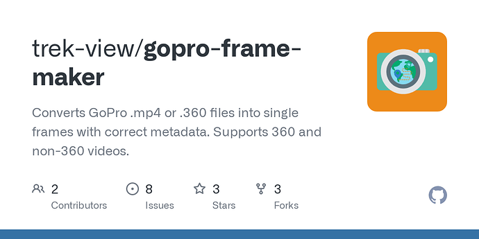

Depending on the current format of these data (especially if they’re in a video format)you might need to do some pre-processing with e.g.
Or this:
Let us know how it goes!

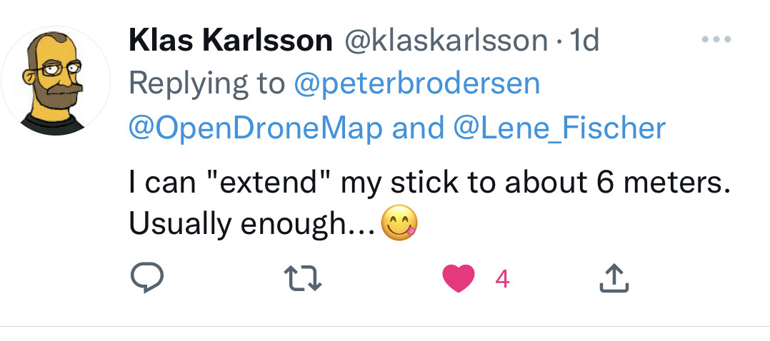

I wonder how long the stick was, he used…
Looks like the max he can extend is 6m:
