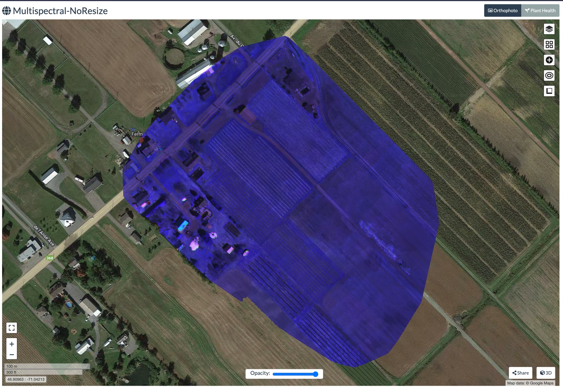

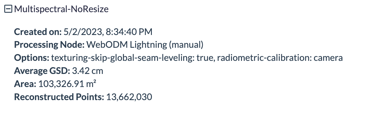

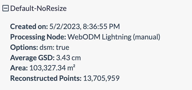

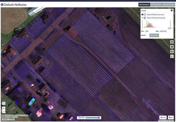

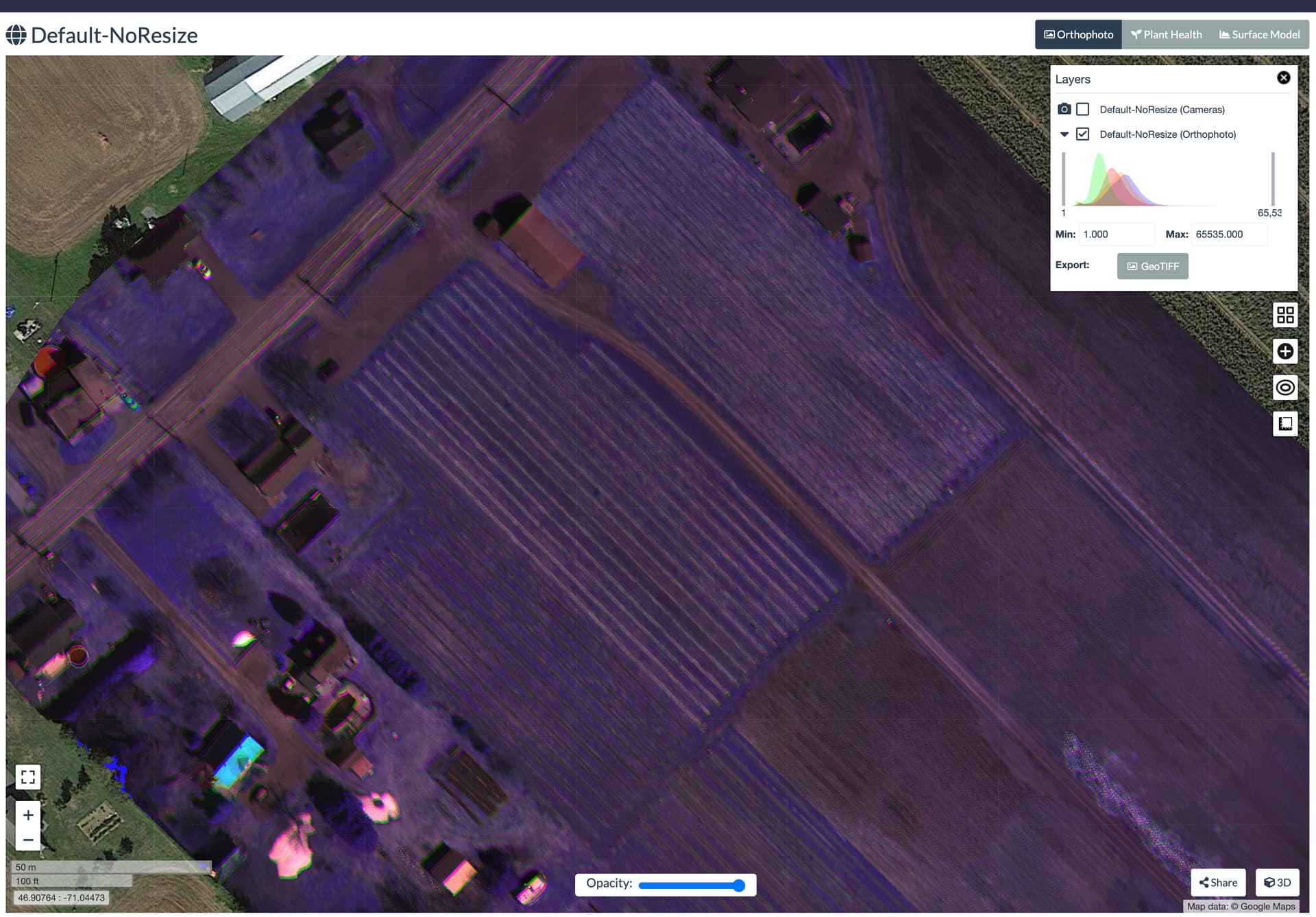

I just try 2 new tests with the same dataset. (972 images w. 4 bands)
The first test is default w. no-resize.

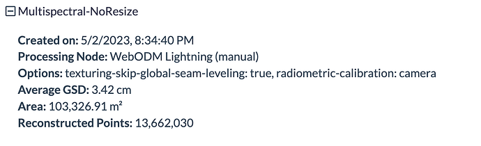

The second test is using the option “Multispectral” w. no-resize

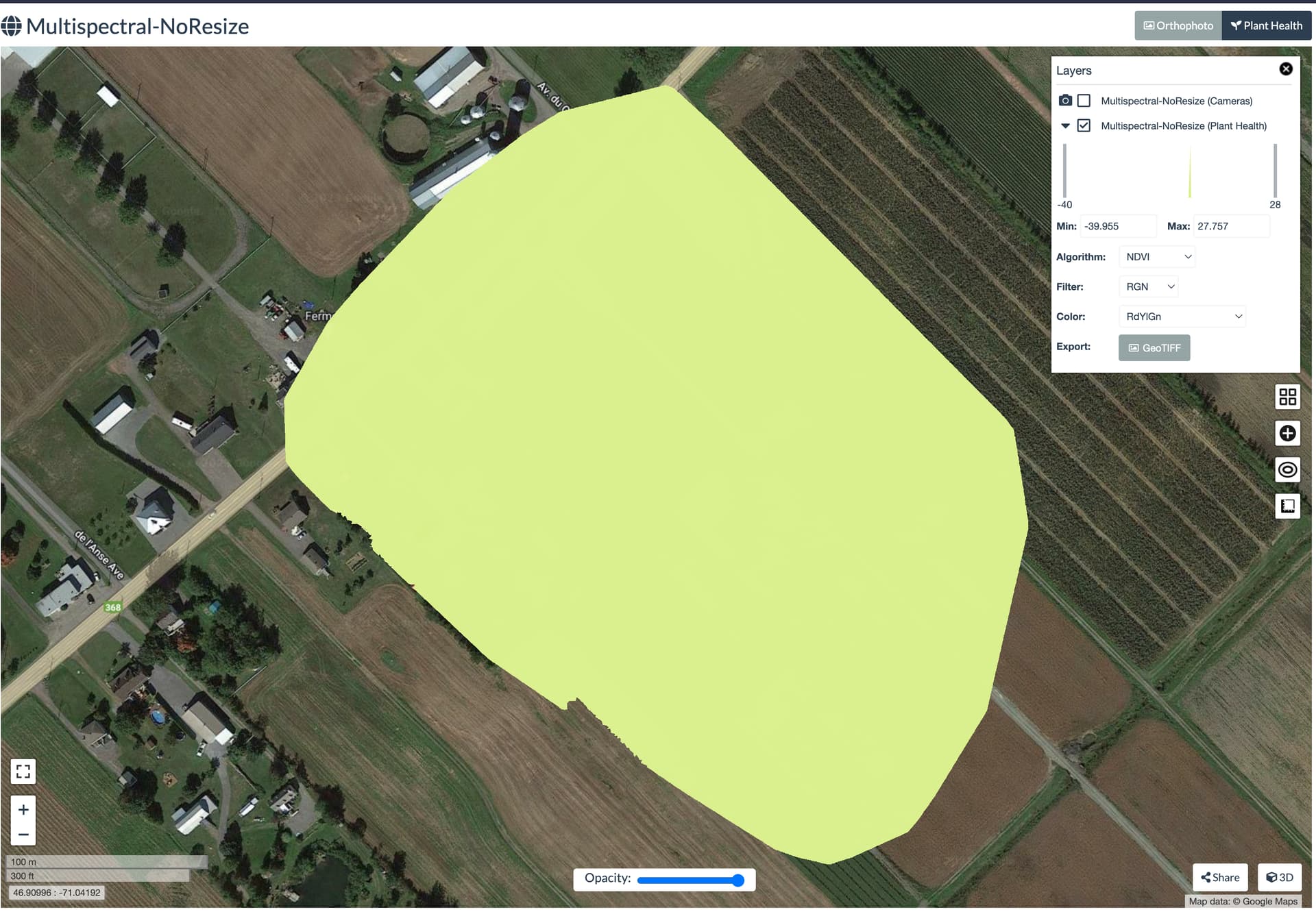

Looking my second test, we can’t selection the options “'multispectral” for this expected result. The wording it’s just weird because using a M3M (Multispectral) we expect working for analyze indexes from multispectral camera. It’s not like using a DJI P1 for reconstruction or field survey.

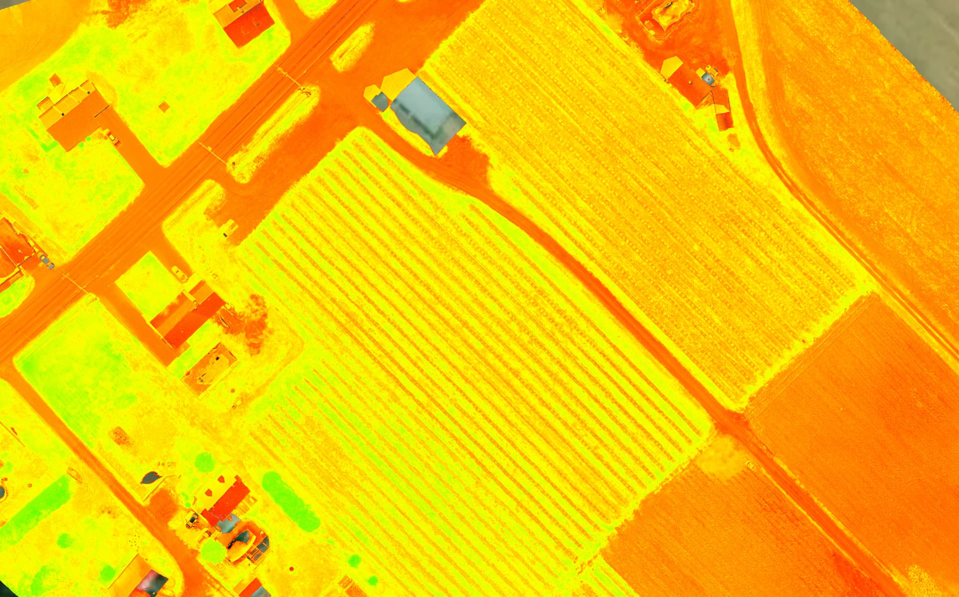

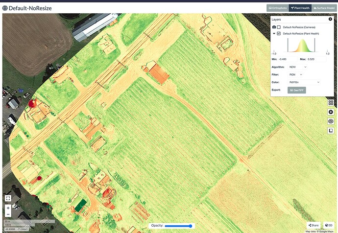

If you look the first test, just selecting Default, we can see some results of indexes but at the first look, I have some concern about if it’s real indexes coming from real dataset with 4 bands. I have some doubt because the results of the index NDVi (for example) it’s far of the expected results we can have using Pix4d. You can see here the same dataset rendered from Pix4Dfields.

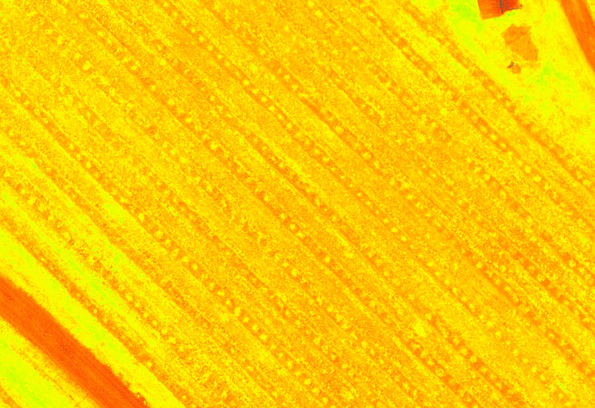

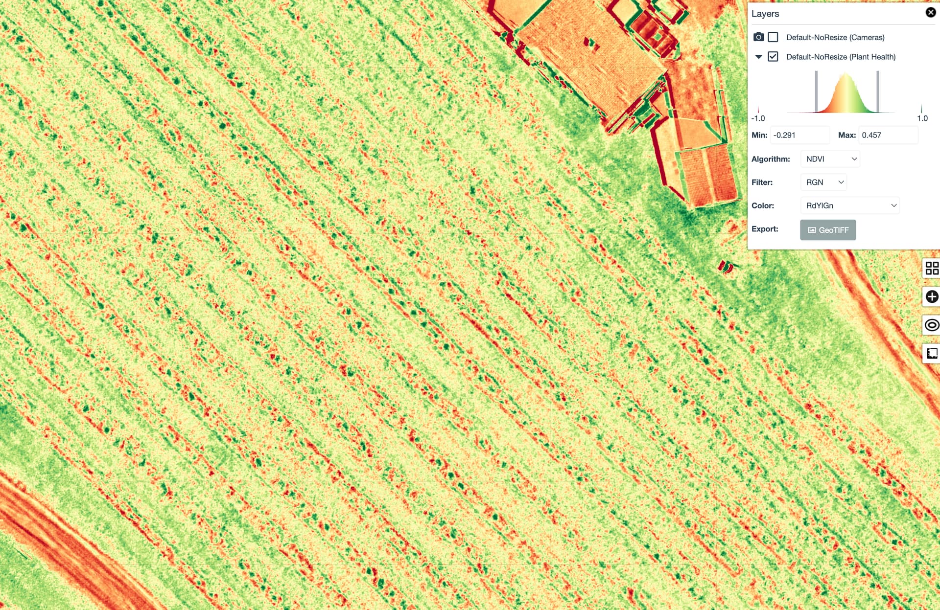

Compared to WebODM, it’s a lot difficult to make analyze because the image contains a lot of noise.

It’s hard to say because these are using different colour scales, and there appears to significant manual scaling to the WebODM results we don’t see in Fields. Have you done a comparison of the two different results in a third party GIS tool to discern whether we are seeing different ranges of:
  • raw data
  • data processed into indexes
QGIS would be a good tool for this.

Yes: what’s unclear is the real numbers behind the display of the data, which is difficult to compare in WebODM or Fields.
It’s always good to understand: does the raw, unindexed data correspond between the two methods and from there discern whether the indices have the same meaning.

I never noticed in the thread where the filter order was mentioned. I think the word filter is an understandable name for the field but isn’t really descript. The filter field should represent the order in which your bands are presented. For example in my file structure for the Rededge mx, the files are in the order: Blue, Green, Red, Near Infrared and Red Edge so I select the apropriate drop down. I am mentioning this because I see in your screen prints that you have selected RGN. Perhaps that is correct for the M3M, but I doubt it. Good luck.
