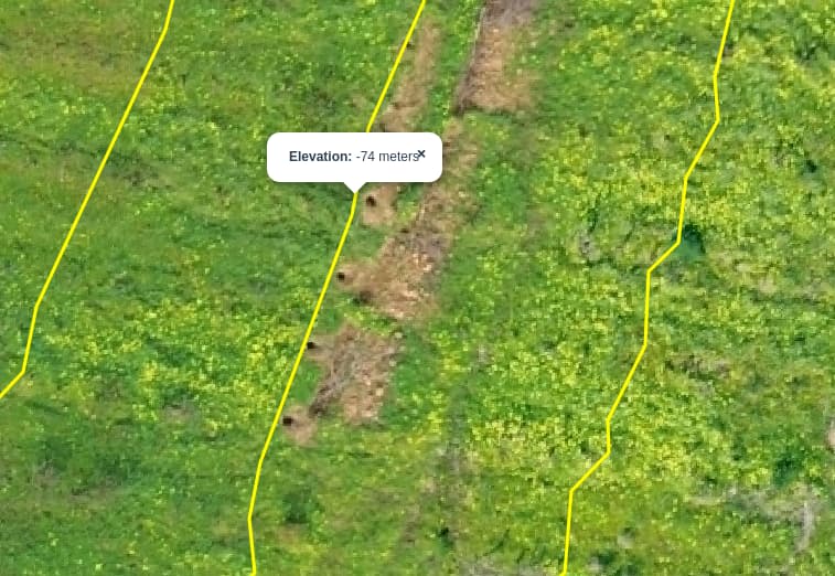

Just curious I’ve been experimenting with a map I made and I wanted to see how the contour feature would come out. Everything came out nice expect when I click on a line the elevation will read in negative numbers. Its identifying hills areas but its not reading a correct topo. For example highest part of the hill reads -30m while the bottom is reading -37m . According to a local topo map the top part of the hill should be at 150 Feet which is about 48m.

Higher curve is still -56 meters. And mission is performed at 50m height… so it makes sense.

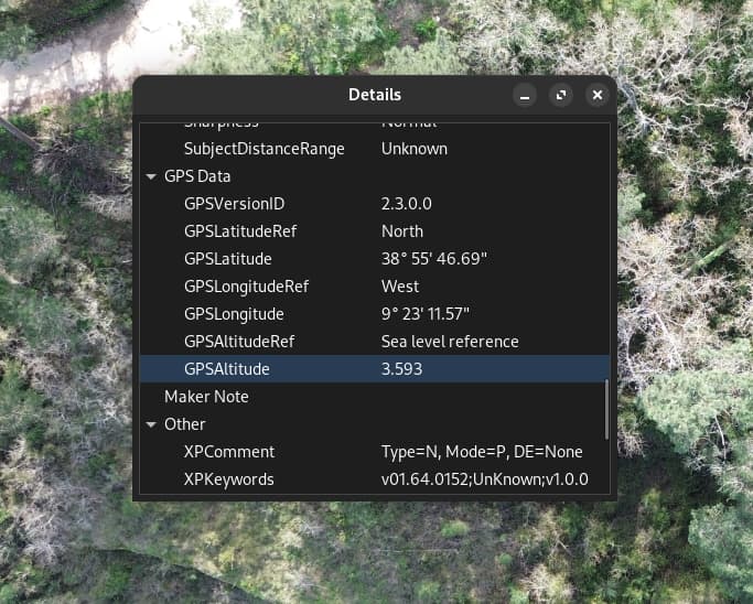

GSD data altitude on EXIF is 3.6 (meters?)… what makes no sense at all as Sea level reference.
So, for some reason, drone is not not saving real AMSL altitude…

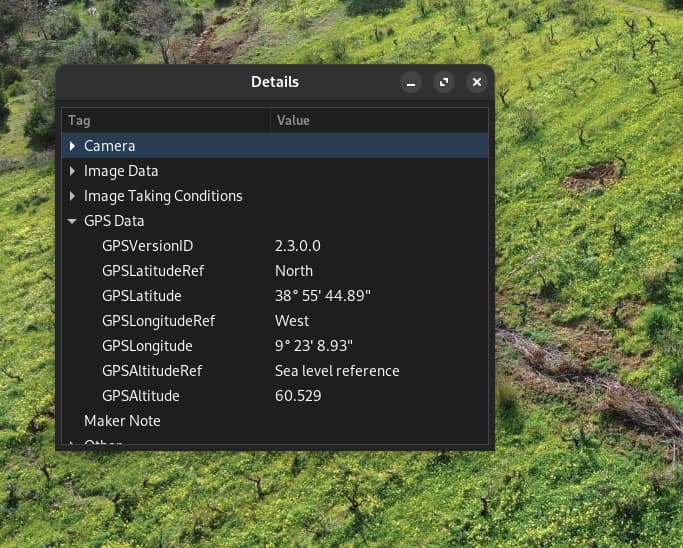

I checked the EXIF from other picture taken from standard DJI flight app… and altitude looks OK!
So, issue is related to “maps made easy” app or config.

For some reason EXIF data shows this 3 to 4m altitudes for all images, what makes no sense.
I understand GPS altitude is far from precise… but not like this.
Pictures I’ve taken after the mission, using standard DJI app looks ok (like 2nd example)
