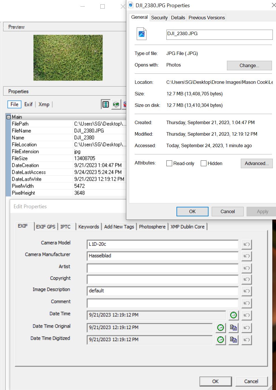

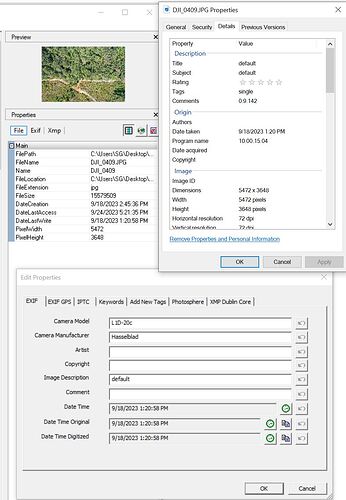

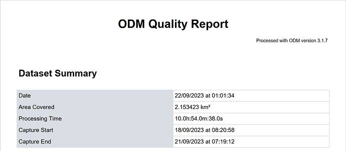

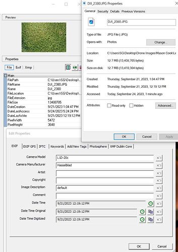

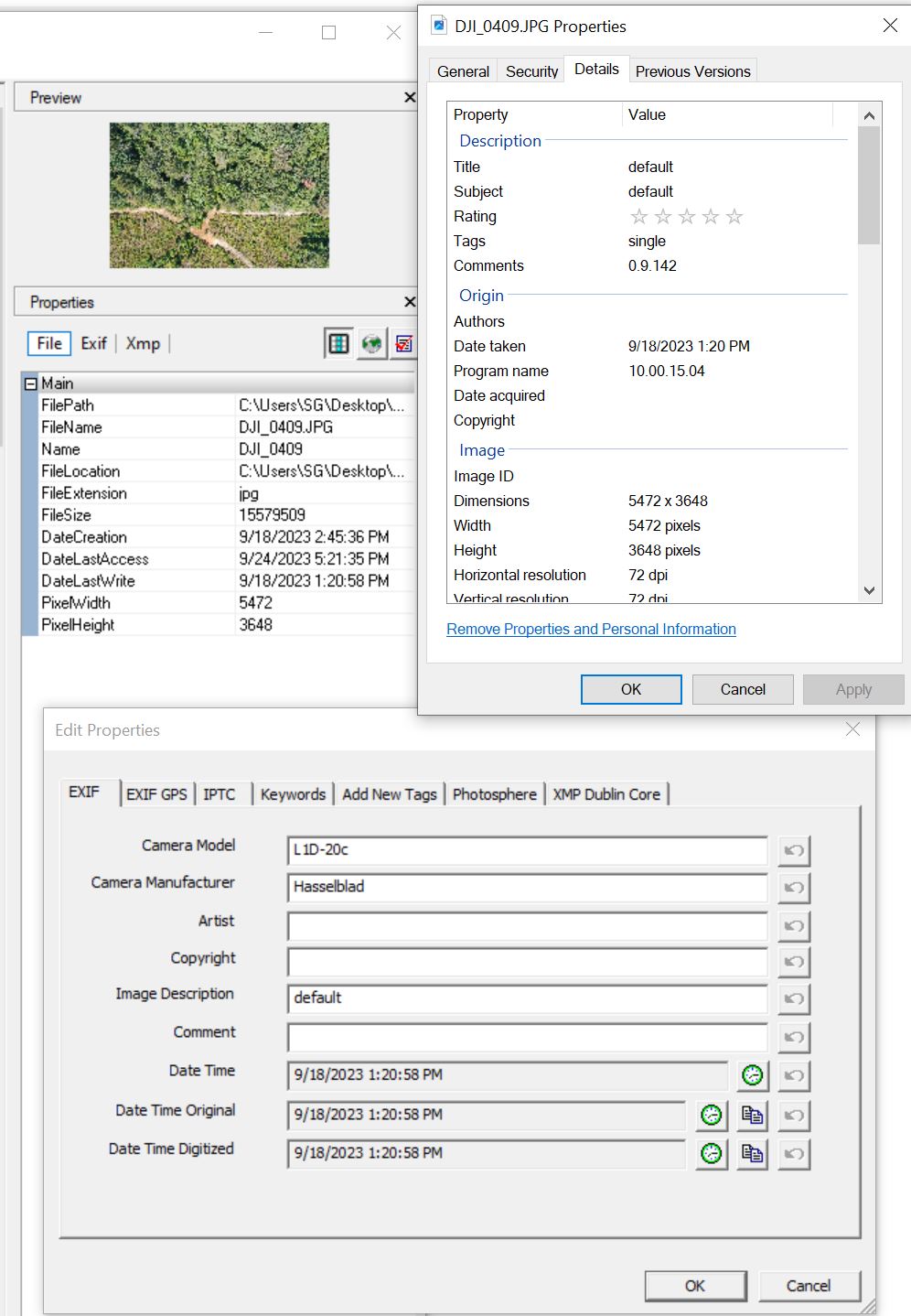

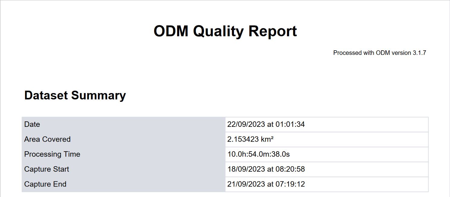

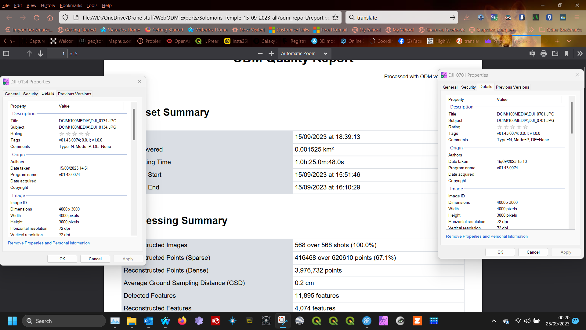

Here are screenshots of the 1st image, last image and Quality Report.
I am in Central Time, USA and the time difference is 5 hrs which will be UTC.
Here in the UK, the report shows the time as BST(which is what we are on at the moment), the file properties show it as GMT
I wonder if this is due to OpenSfM’s code which calls fromtimestamp:
stats["start_date"] = datetime.datetime.fromtimestamp(start_ct).strftime("%d/%m/%Y at %H:%M:%S")
stats["end_date"] = datetime.datetime.fromtimestamp(end_ct).strftime("%d/%m/%Y at %H:%M:%S")
Which returns the local time. This would explain why this probably just happens on Windows and not docker, where I tested (on docker the timezone is UTC).
