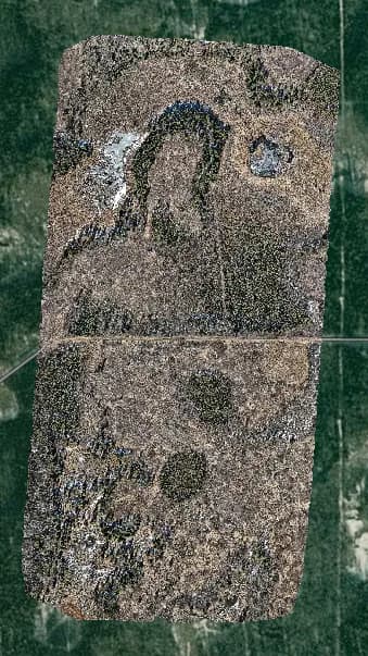

Hi, I am processing a dataset of 400 (20 MP) images and it works well for everything I want to do on one windows 11 machine. I paid for the Windows installer, version 2.4.2 (ODM 3.5.0?), and I can get DTM, DSM, Orthophoto, FastOrthoPhoto to work just fine. The machine that it works on is a Windows 11 ThinkPad with Intel i5 11th gen, intel Xe onboard graphics with 32 GB of RAM. I tried it with several different options and all processed successfully. I did a fresh install with the windows installer, same version, on another Windows 11 machine which has AMD Ryzen 7 7840HS CPU, with onboard AMD Radeon 780M Graphics and 32 GB of RAM. Every time I try to process the same dataset on the AMD machine, I get “cannot process dataset”, even if I try to do the fast ortho photo option, which the other intel machine does in under 20 minutes. Does anyone know what the issue could be?
Thanks to anyone who may be able to help :slight_smile:

I did as you suggested and uninstalled WebODM, uninstalled Bitdefender anti-virus, and then reinstalled WebODM, and then ran with the same dataset and it processed it successfully on the first try. Thanks for your help!
Glad it worked out
