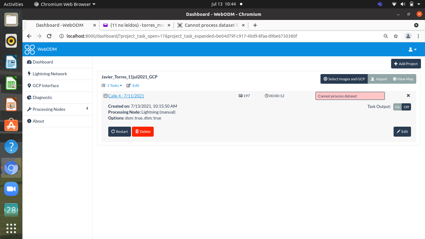

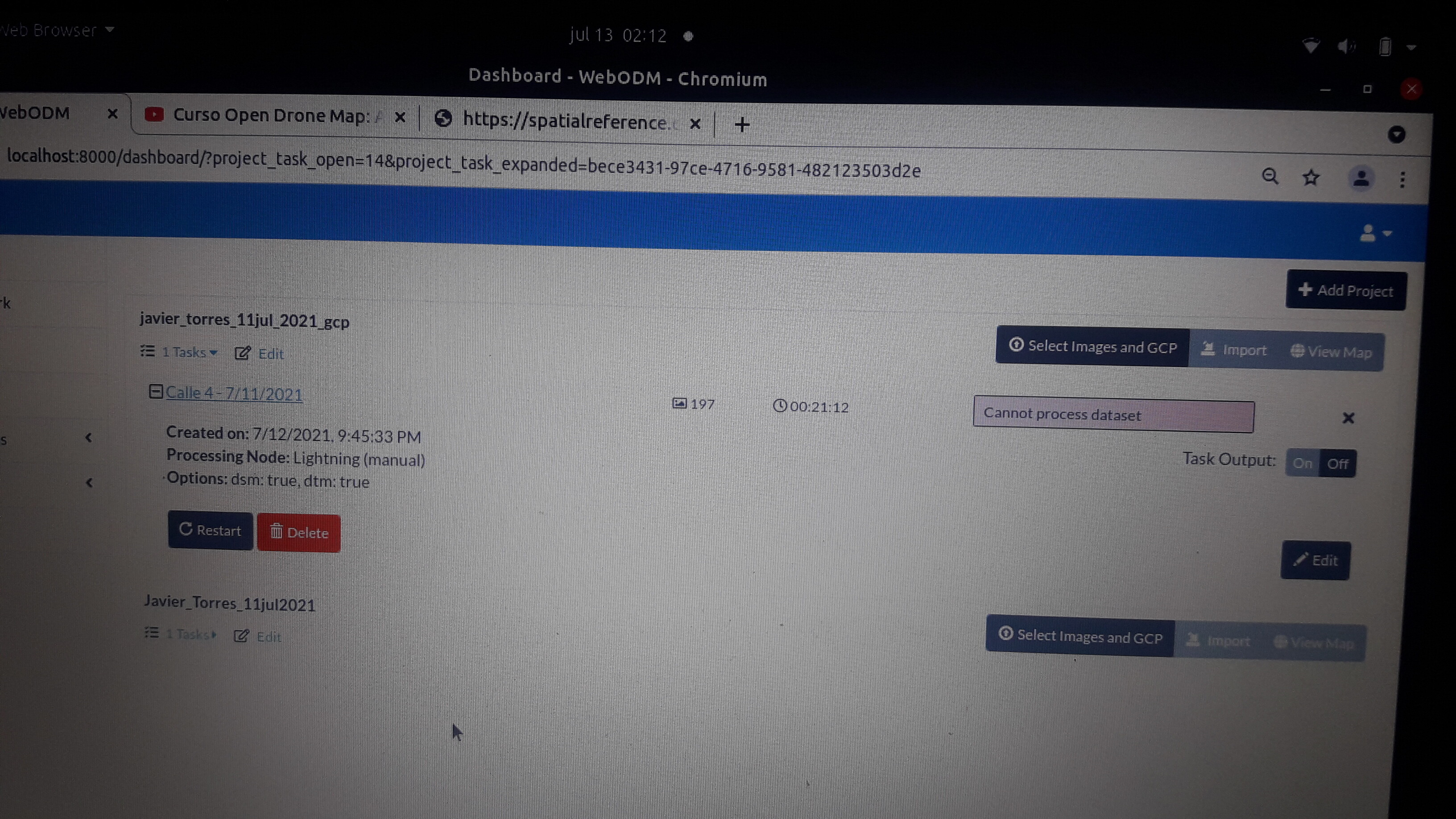

Cannot process dataset lightining
Dataset URL (Dropbox, Google Drive, GitHub…): 100MEDIA - Google Drive
Number of images: 196
Size in MB: 1GB
EXIF GPS (yes/no): YES
GCP (yes/no): YES
RTK (yes/no): YES
I configurated the mission using pix4dcapture, with both ovelap 80%
Comment/Description:
Good day, I have a dataset with 196 images, flight height: 55m, drone: phantom 4.
I used my ODM in my pc, but I cannot process the information, I thougth that my memory was the problem 8GB, so I used my free lightining account but I received this error “cannot process dataset”, and also I received this email:
Your task [Calle 4 - 7/11/2021] could not complete. Here’s a copy of the error message:
[WARNING] Really low resolution DEM requested (1, 1) will set floor at 64 pixels. Resolution changed to 1.8868418007462628. The scale of this reconstruction might be off.
[INFO] DEM resolution is (38, 64), max tile size is 4096, will split DEM generation into 1 tiles
[INFO] Generating /var/www/data/47d586ea-a0e5-4764-bddc-6c28ad5a0370/odm_meshing/tmp/mesh_dsm_r2.668397264667838_x0_y0.tif (max, radius: 2.668397264667838, resolution: 1.8868418007462628)
[INFO] running pdal pipeline -i /tmp/tmpk2kc7_ac.json > /dev/null 2>&1
[INFO] running gdalbuildvrt -input_file_list “/var/www/data/47d586ea-a0e5-4764-bddc-6c28ad5a0370/odm_meshing/tmp/tiles_list.txt” “/var/www/data/47d586ea-a0e5-4764-bddc-6c28ad5a0370/odm_meshing/tmp/tiles.vrt”

[ERROR] Uh oh! Processing stopped because of strange values in the reconstruction. This is often a sign that the input data has some issues or the software cannot deal with it. Have you followed best practices for data acquisition? See https://docs.opendronemap.org/flying.html
I checked the images position in QGIS, and they are fine, also I processed 36 images in my ODM and worked that process was done without GCP.
Finally, I processed the dataset (196 pictures) without GCP in ODM lightining , and I had good results, (the forum does not allow me to attach more than one photo) . So the problem is when I use GCP. I attached in the Google drive URL my GCP using GCP ODM interface.
So, please I need some help, because I want process my information using GCP (made with RTK).

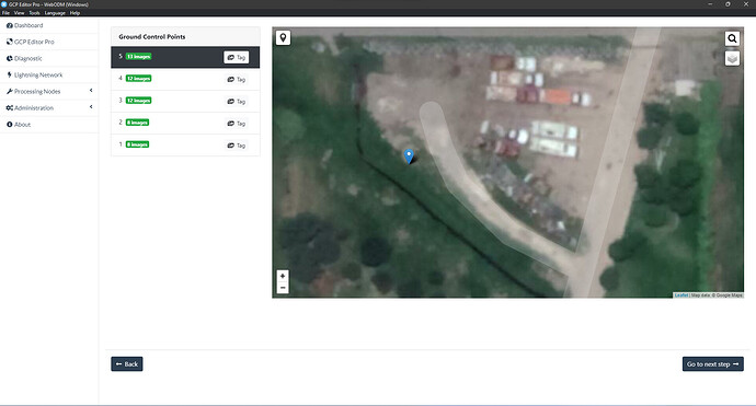

Sorry you’re having trouble with processing with your GCP.
At a quick glance, it looks like your gcp_list.txt file is malformed:
I don’t think you meant to have all five GCPs exactly co-located in one spot (with really low precision values for RTK [-74.00, 5.01, 2594.479])

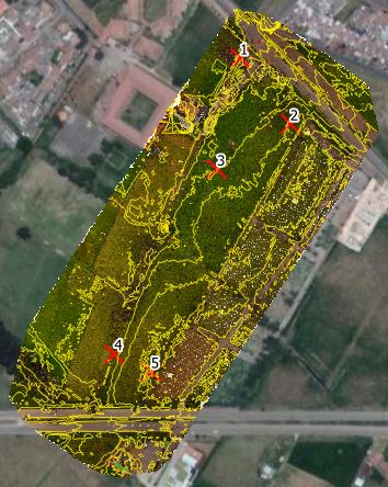

Saijin thanks, now I can see the problem, the GCP tool don’t receive the decimal precision (I think that this tool need some revision), so I will change the txt file, because these are my GCP RTK for my 5 GCP
Name Easting Northing Elevation
1 -73.99563011 5.01366258 2597.356
2 -73.99516785 5.01305747 2595.41
3 -73.99584131 5.01264336 2595.921
4 -73.99678861 5.01095004 2595.95
5 -73.99645004 5.01078738 2594.479

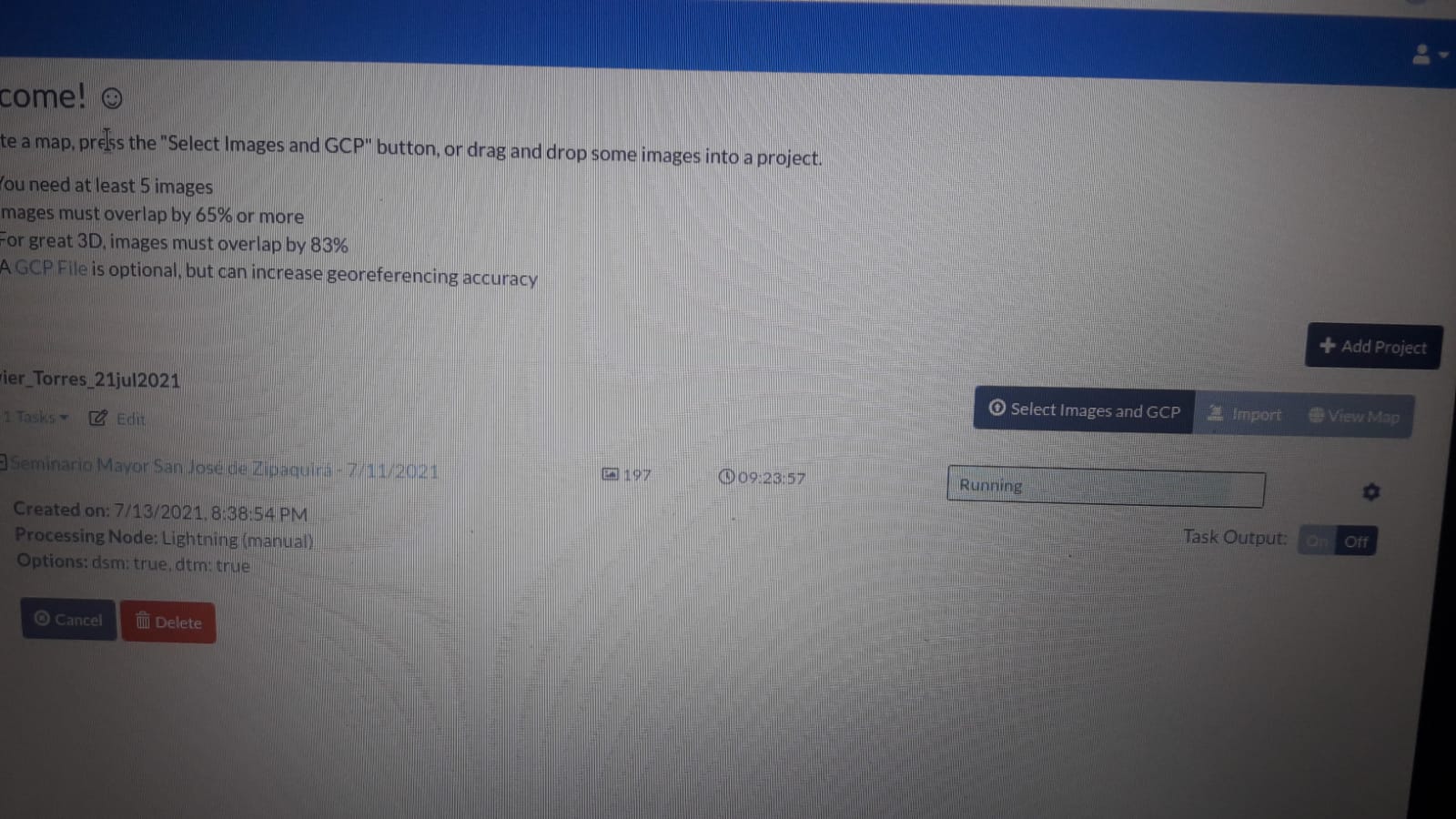

Saijin again ODM Lightning send me an error.
I used the new GCP file:
+proj=longlat +ellps=WGS84 +datum=WGS84 +no_defs ,
-73.99563011,5.01366258,2594.479,3101.73,569.58,DJI_0043.JPG,5

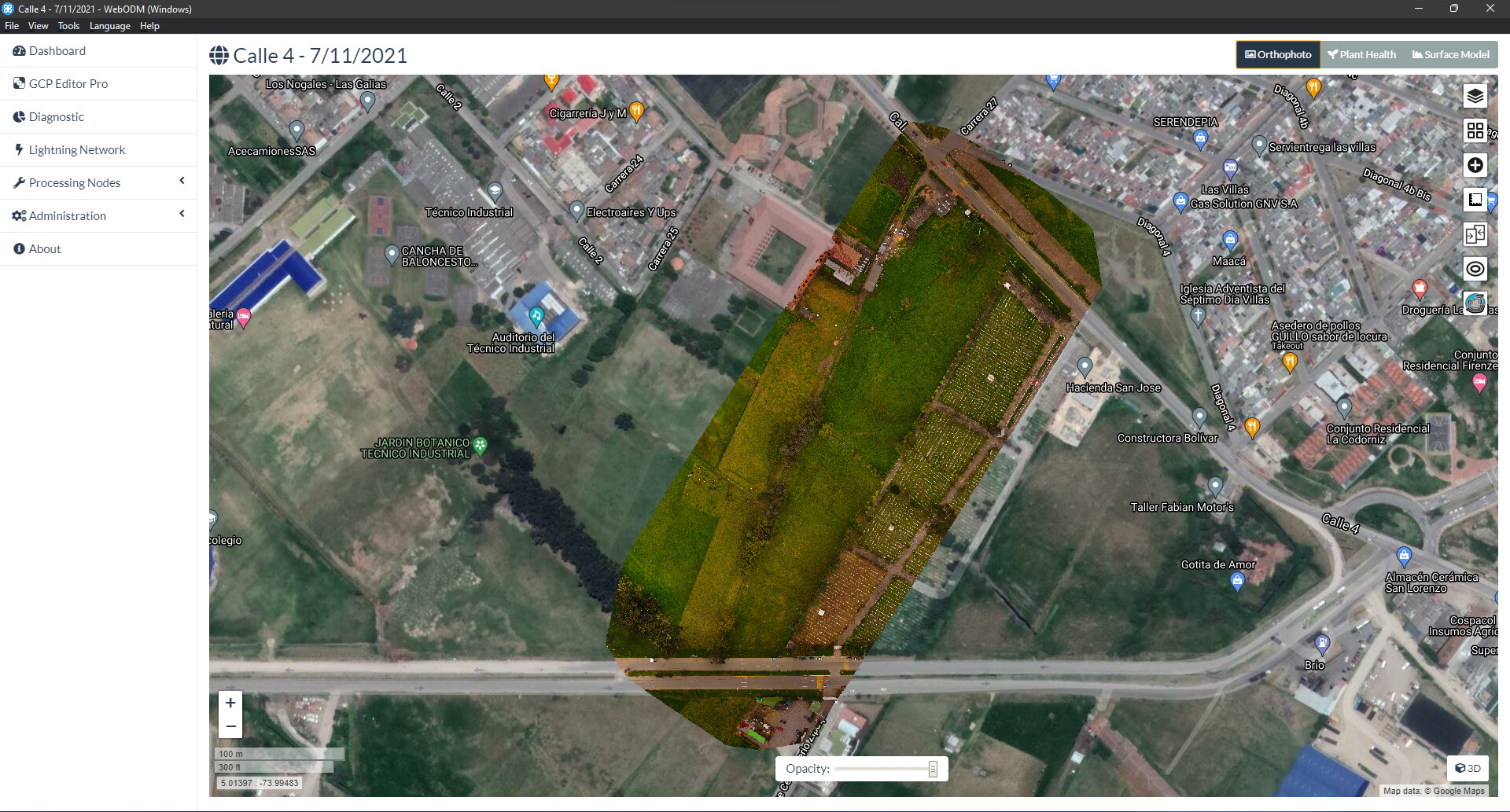

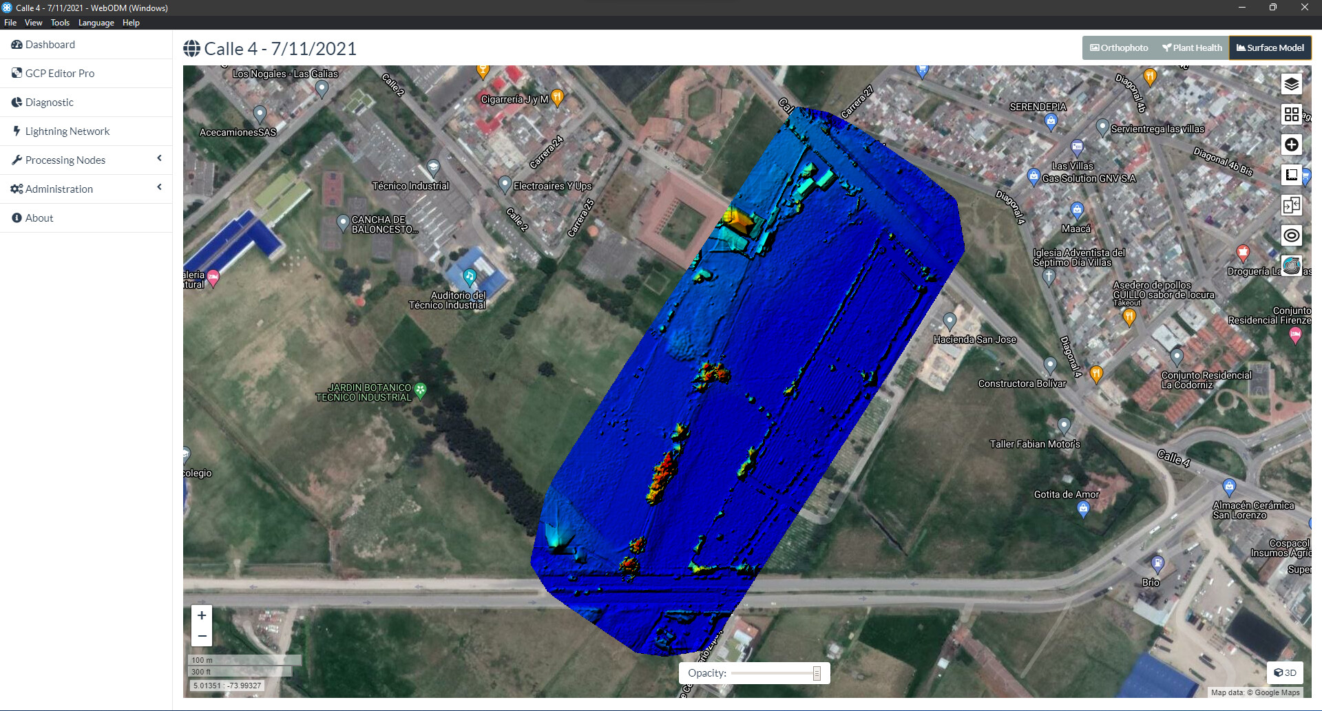

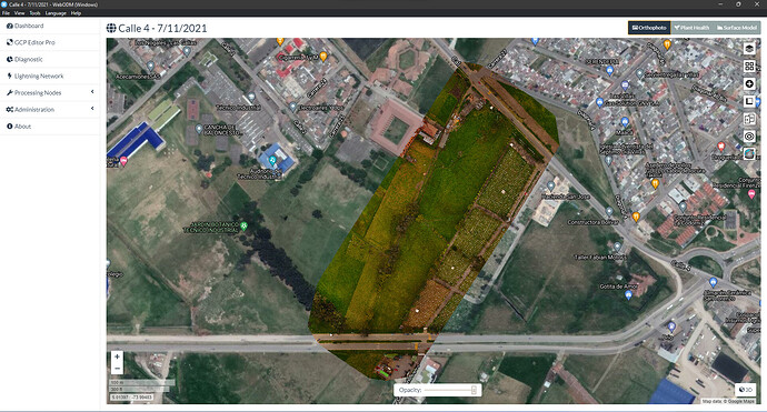

Saijin thanks a lot of, the last problem was about the delimiter character, I was using comma, and ODM use space o tab.
Finally, I have my processing with GCP.
Thanks.
Best regards.
Enrique Torres
Sweet! Show us a screencap when it’s done (if you can/if you’d like). We all love seeing new cool data!
Saijin good day, yesterday I run the process, and I saw that one GCP was wrong, after that check in detail my GCP and again I started a new process, but after 9 hours the process don’t stop.
Sorry, I need your help, could you process my pictures? because I need an expert opinion… I can not see what happen.

Looks to be malformed again.
It seems like you were using double-spaces as column separators which is not to spec. Single-space only.
After doing a Find/Replace in Notepad, the GCP file seems to be well-formed:
Also, I see in your google drive the gcp file is not named properly. It needs to be named gcp_list.txt to be used properly.
Looks really good! Exceptionally well-done survey/GCP:
Options: debug: true, dsm: true, verbose: true
Enrique_Torres_Moya_8283_Report.pdf (8.0 MB)

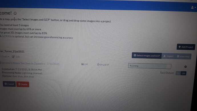

Thanks Saijin at the momment I fixed the file name and the double espace, and I am processing, so when the software finishes I will be reporting the result.
But great to see the results…

Saijin finally the software stopped, something strange happened, I received the email with the results, but my computer was still processing.
I share my results.
Thanks a lot.
Best regards.
Enrique Torres MEnrique_results_17jul2021
