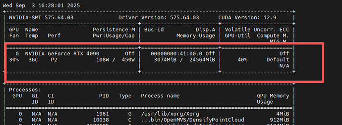

As you mentioned, I ran watch -n 1 nvidia-smi on my device to monitor the GPU-Util value. I noticed that the GPU was only active for less than 10 seconds while DensifyPointCloud was running, and the total time taken was approximately 13 minutes.
