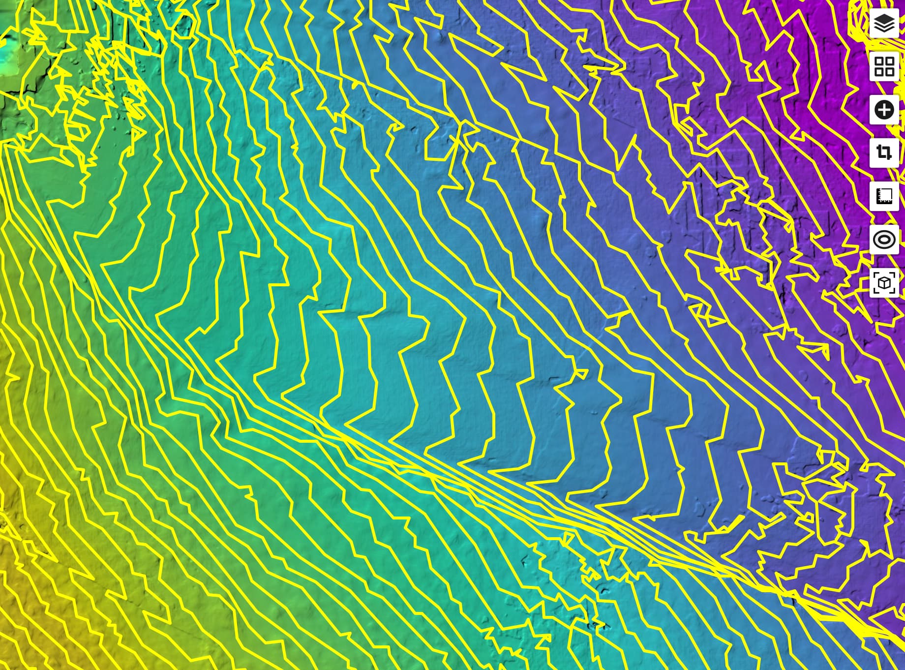

In case this is helpful, here’s some artefacts I generated from one of my existing projects to give you an idea of the kinds of things you might be able to produce:

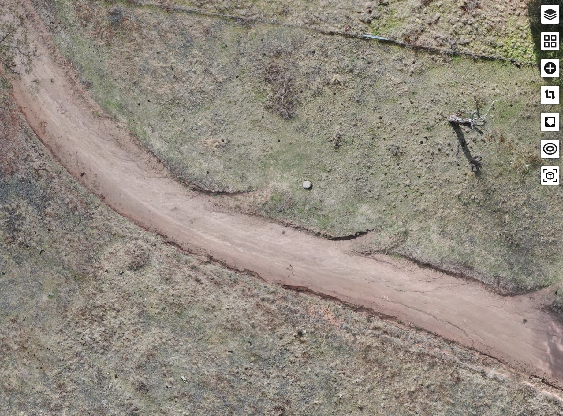

Orthomosaic:
Orthomosiac with contours previewed:

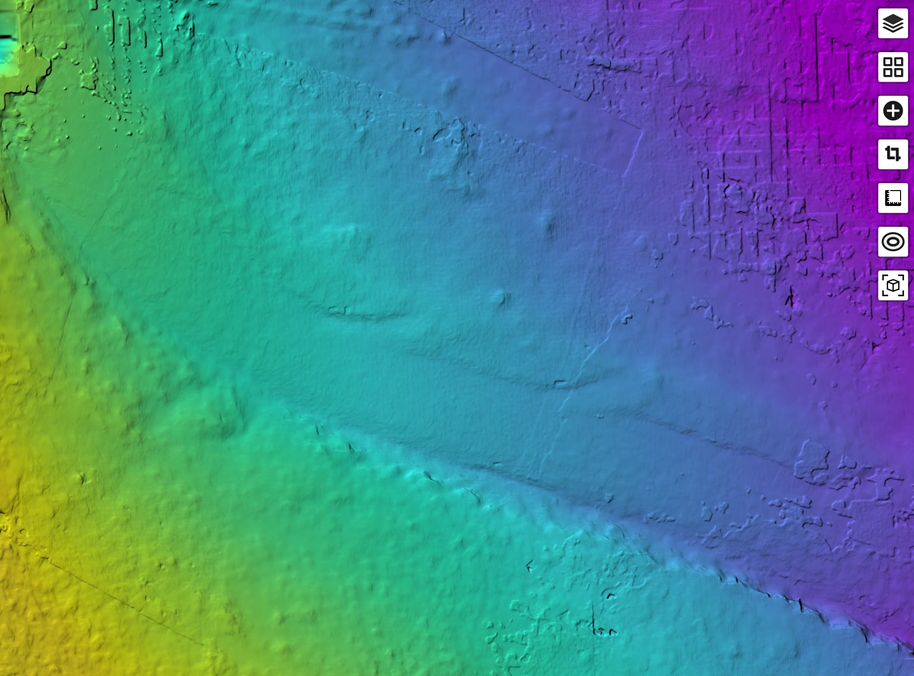

Digital terrain model (DTM):

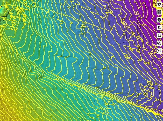

Digital terrain model (DTM) with contours previewed:
Wow, that is exactly what I’m looking for. The question is… how do I do that? What do I actually need?

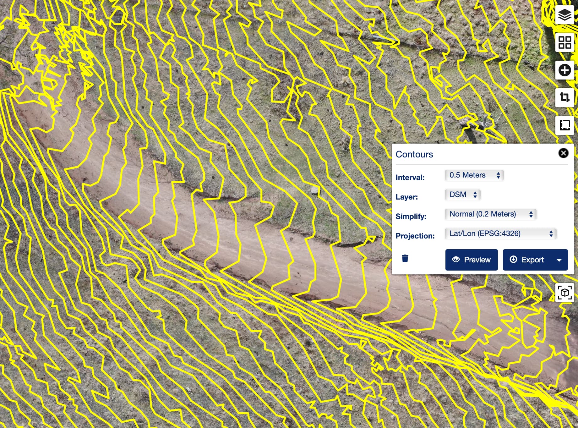

did you get the contours in webodm or did you use qgis or something?
that is the contour tool in WebODM.

what is the location of this tool?
do you have a land fill?
yeah, check out this dataset: Kandiyohi County Landfill - #3 by kclandfill
View the 2d orthophoto, and it’s one of the tools in the top right hand corner
WOW Learn something new everyday!
