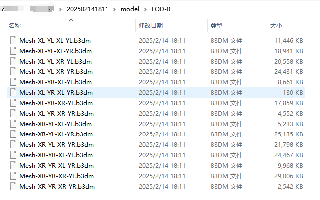

The generated 3dtiles result file are as follows:
