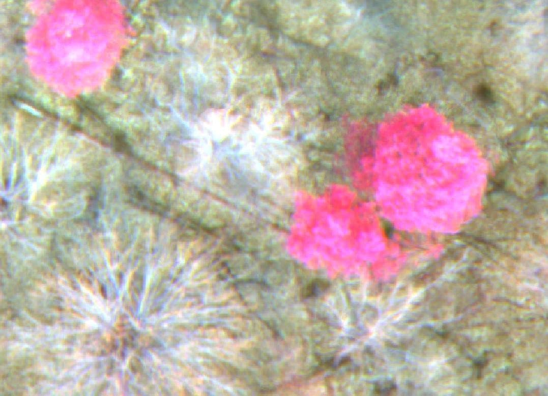

We’re working through getting band alignment working on DJI Mavic 3M datasets. Thanks to different hardware / firmware, etc., we cannot necessarily know the changes in tagging between versions, and the tagging is critical for getting the correction parameters for aligning the bands.
So: if you have a DJI Mavic 3M dataset or a few to share, please reach out, either in this thread of in DM if it’s more sensitive. The results so far are promising:

Hi @DroneScout – really appreciated these shares. Unfortunately, internet speeds killed me on downloads. But if you are running on docker and update, you should be able to process MS only bands and get better alignment now:
If you’re running Windows or Mac, let me know, and I’ll send you a link and login information to do the processing on one of my updated nodes.
