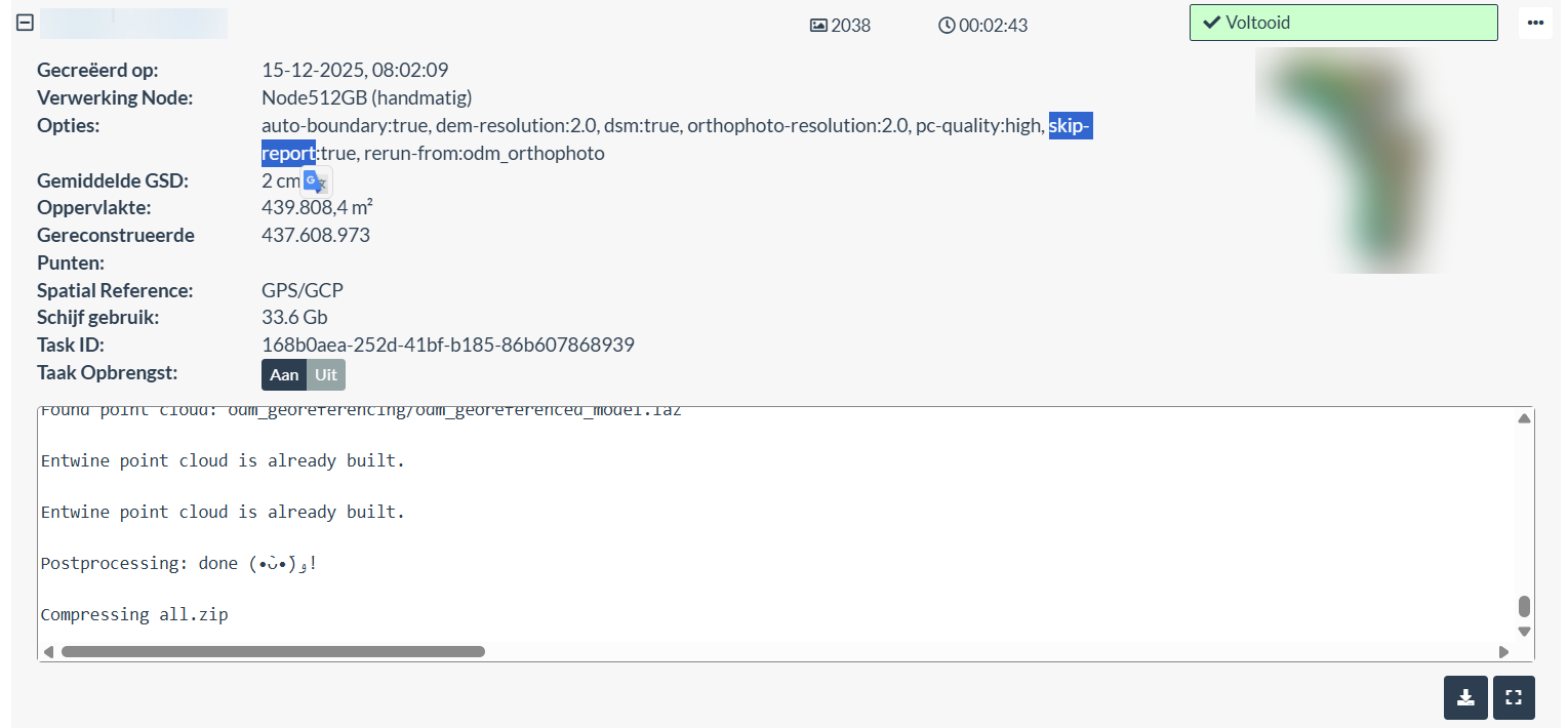

With a little bit of help from ChatGPT (I know I know :-)) I got the suggestion that:
The failure happens in the report/preview generation stage, specifically when WebODM tries to create a colored hillshade preview of the DSM for the report:
So I decided to rerun the project with the flag: skip-report and voila… 2 minutes later the project was finished.
