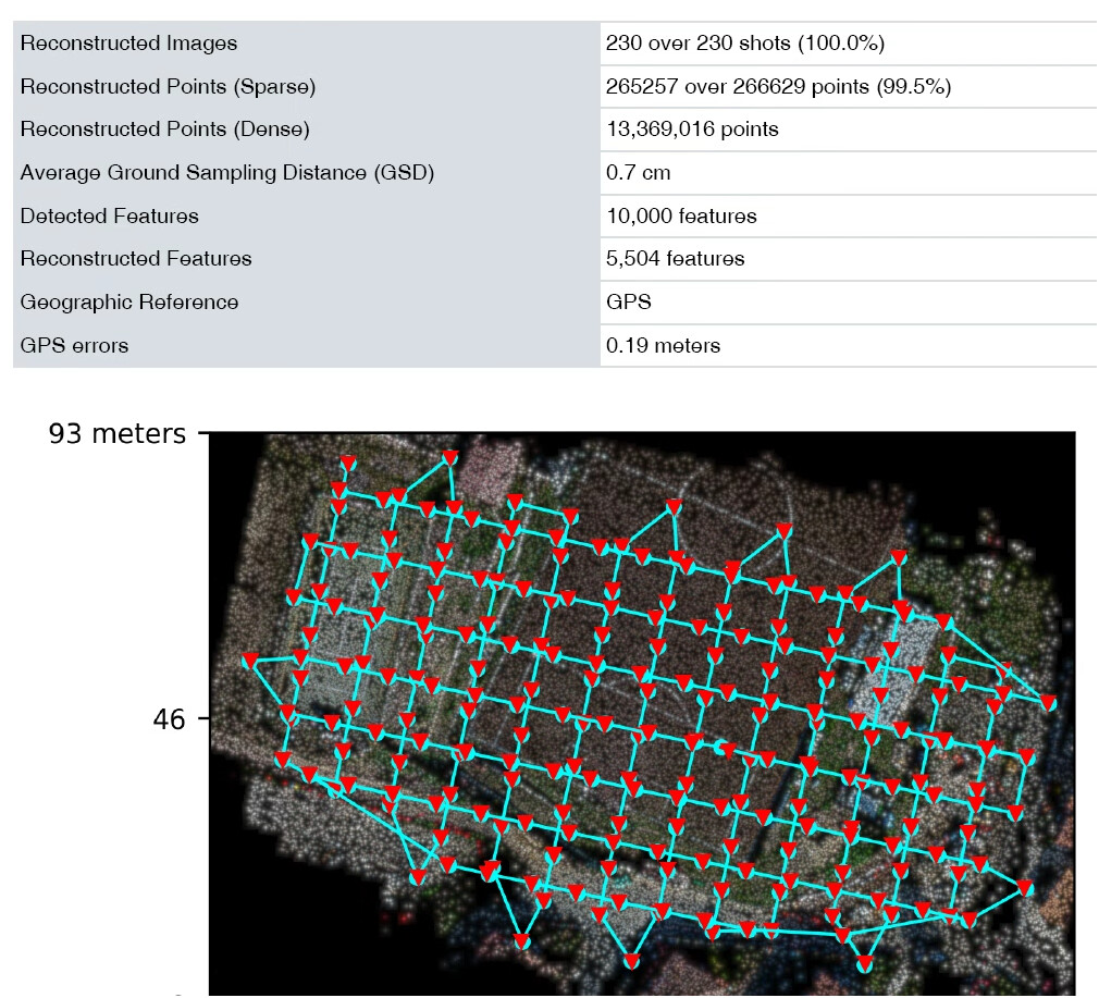

Overlap 85/75%, double grid, height 35m, speed 3m/s, exposure time 1/1000, total 480 images.

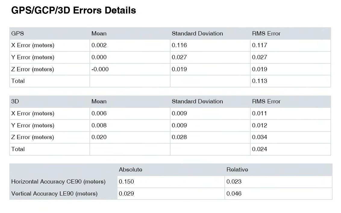

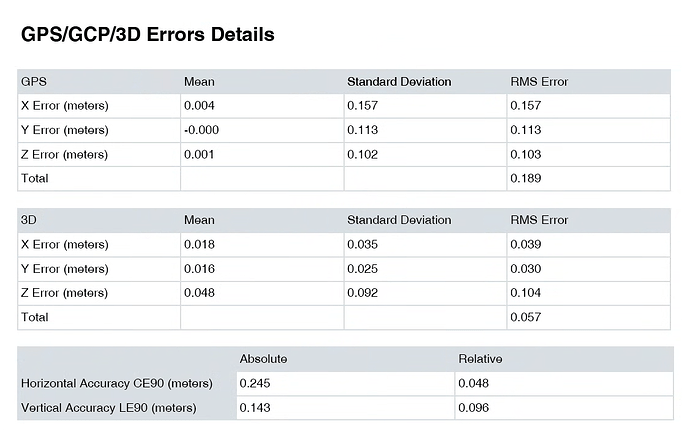

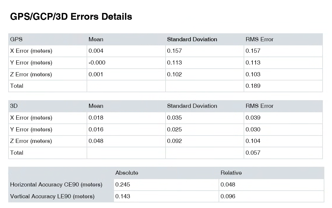

I process 480 images with WEBODM but the result in terms of precision compared to the points beaten with GPS SOKKIA GCX2 RTK was not satisfactory.
I tried to use only images of the north-south flight and then only east-west images, the result was always not very precise.
I also tried only half of the double grid images, but the accuracy is similar to the full set of 480 photos

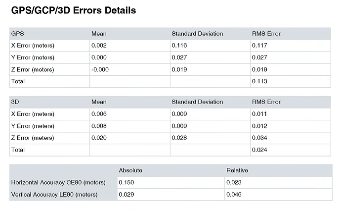

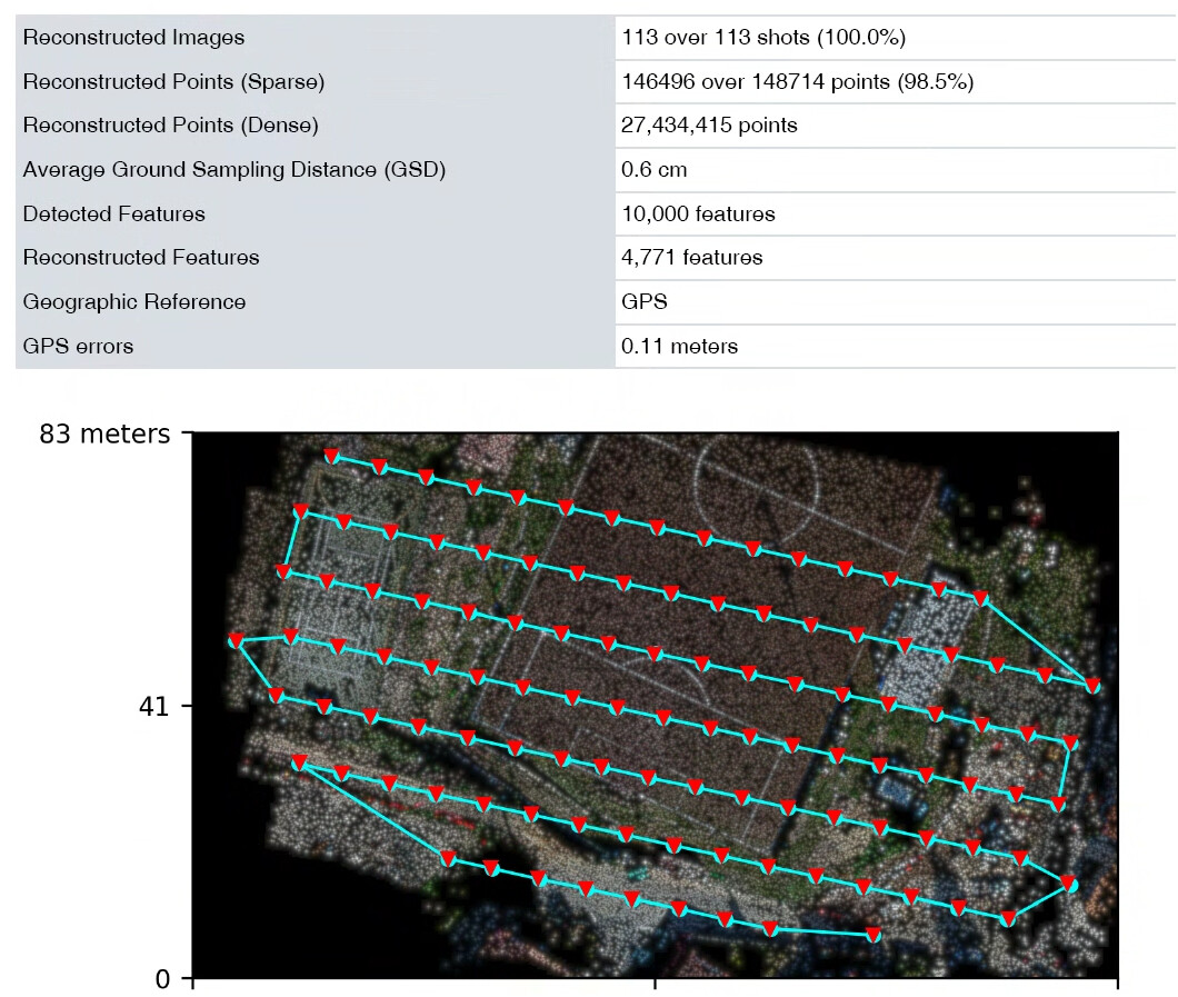

I tried to use only the east-west flight using only half of the images in order to decrease the overlap to about 60-65%.
Much better result, precision similar to GPS OKKIA GCX2 RTK.
I also tried many settings found on the forum, but none of them improved the accuracy. Only the overlap reduction helped me.
