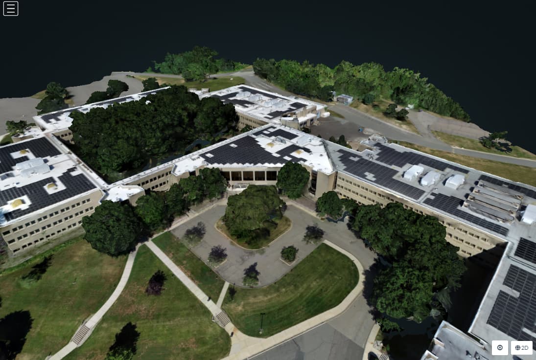

OK. Now it is working but…the results are not very good.
Here is a screenshot from WebODM
And here is a screenshot from DroneDB
If I did something wrong (which is very possible) please let me know. And if you want any files to help diagnose the problem, let me know that too.
Thanks!! If we can get this working this would be a great solution.

I did and I can confirm that the model looks strange. For some reason it’s not loading the proper level of detail when zooming in.
This will require further troubleshooting, as I’m unsure of the cause (and it’s the first time I’ve seen it).
