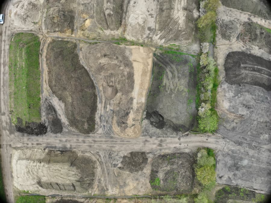

A recent (cropped) example singleimage flown from 70m (GSD of 2cm) with a M3E

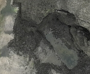

Zoomed in on 100%

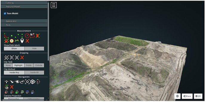

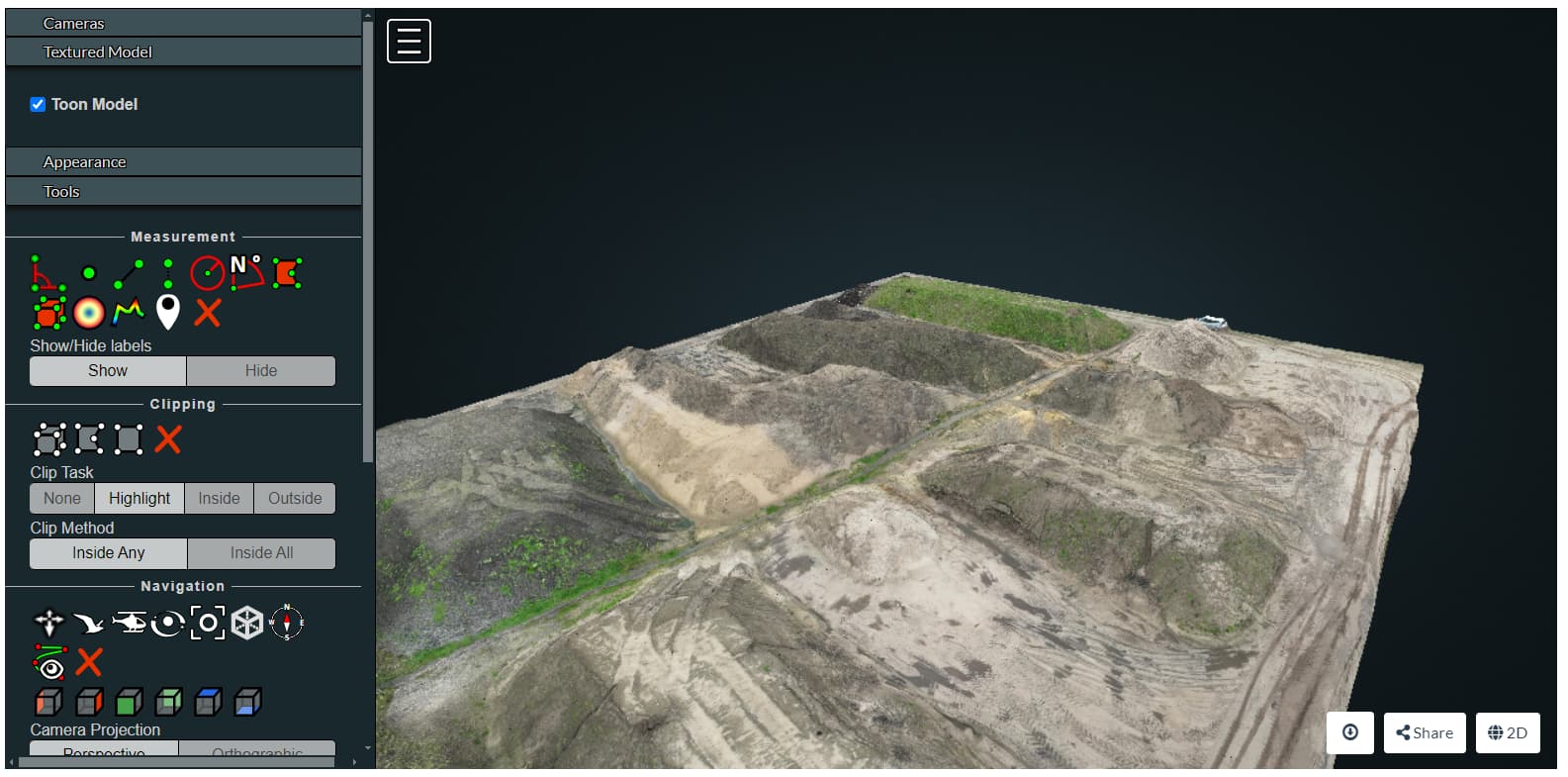

The complete mapping gave nice results
