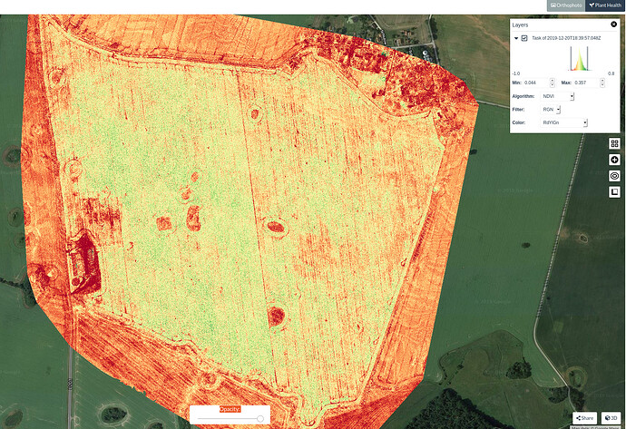

Hello
i use a mapir camera (survey 3W ocn) for biomass estimation on my farm. I also started with a copter, but even with 35 min flight time the maximum field size is limited to 30 ha. In my country copters are limited to 100m and with the mapir camera I have to maintain 80% over/sidelap because of vignetting.
At the moment i use a fixed wing flying at 200m with 16 m/s covering over 300 ha in one flight (45 min), what is very important because of the changing light conditions which significantly affect the biomass estimation.
In WEBODM i use the fast-orthophoto option with no resize and min-num-features at 12000. Processing takes about 2h for a 150ha field with 450 pics (1000,-€ gaming PC).
The results are good enough for estimating zones of different biomass for creating application maps.
